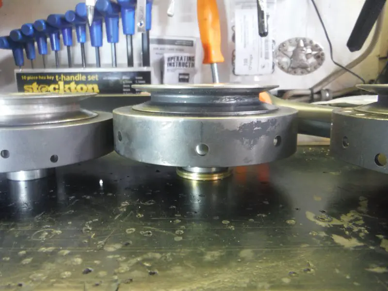

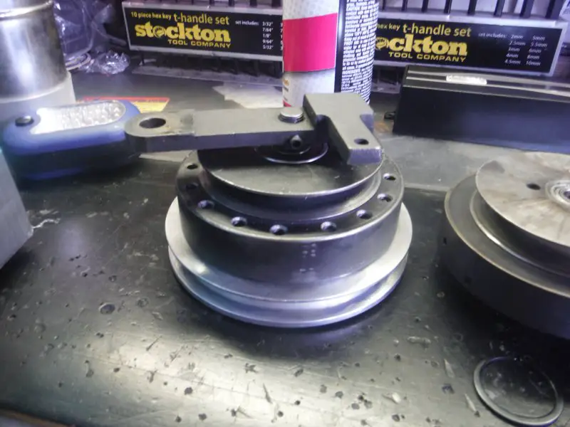

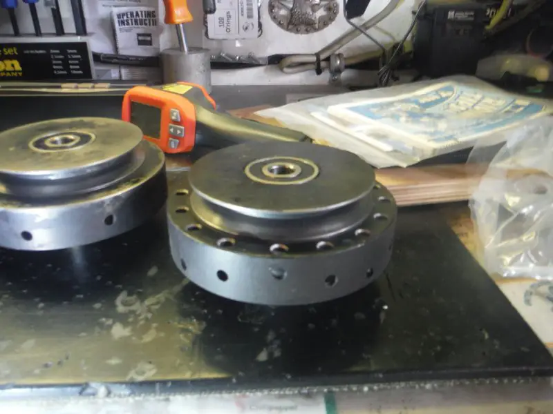

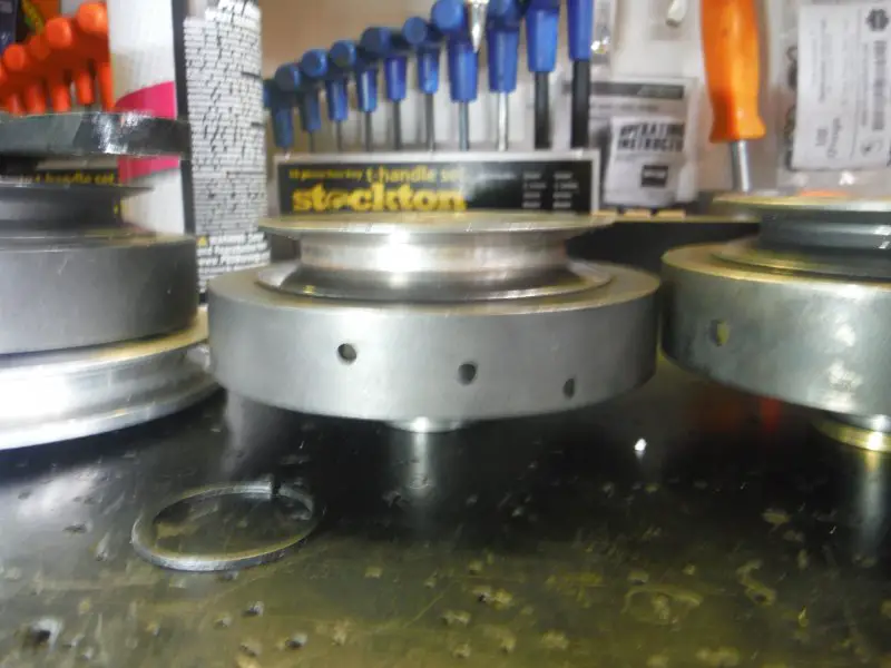

As a side note to clutches... Ventilating the drum with 1/16" holes in a symmetrical pattern will let the heat and gasses and dust out... On drum brakes it helps them dry out when wet also...
on the perimeter or face?
On the surface the friction material rides on... The pattern is important to stagger the holes so there not all lined up and spaced out enough not to diminish the surface area... Like on ventilated disc brakes... Not just pumping random holes everywhere...
You can drill holes in the face or perimeter of the clutch drum if ya want.
I guess it helps but it's really not necessary and something that must be done
I've experimented with hole patterns in the clutch drum for cooling and pad dust
Just make sure your hole patter is even so it don't throw the drum out of balance
Actually Whizzer started putting holes in the clutch drum around 2008
Cruzzer Motorbikes has holes in their clutch drum too. so I guess they think it helps
The drum I'm currently running on my Whizzer has no holes it.
