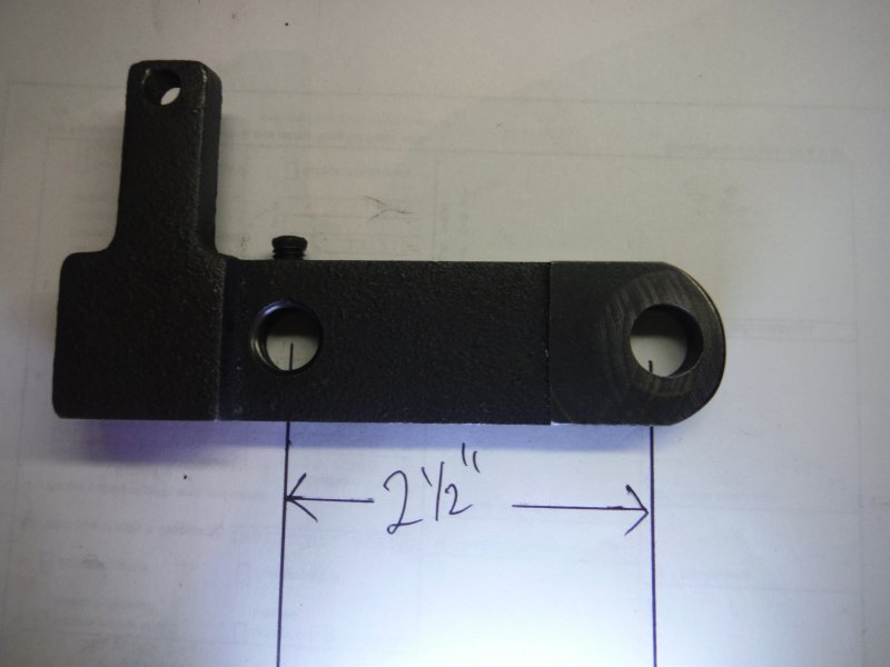

Whizzer 90* right angle clutch arm
The measurement between the two holes should be 2 1/2"

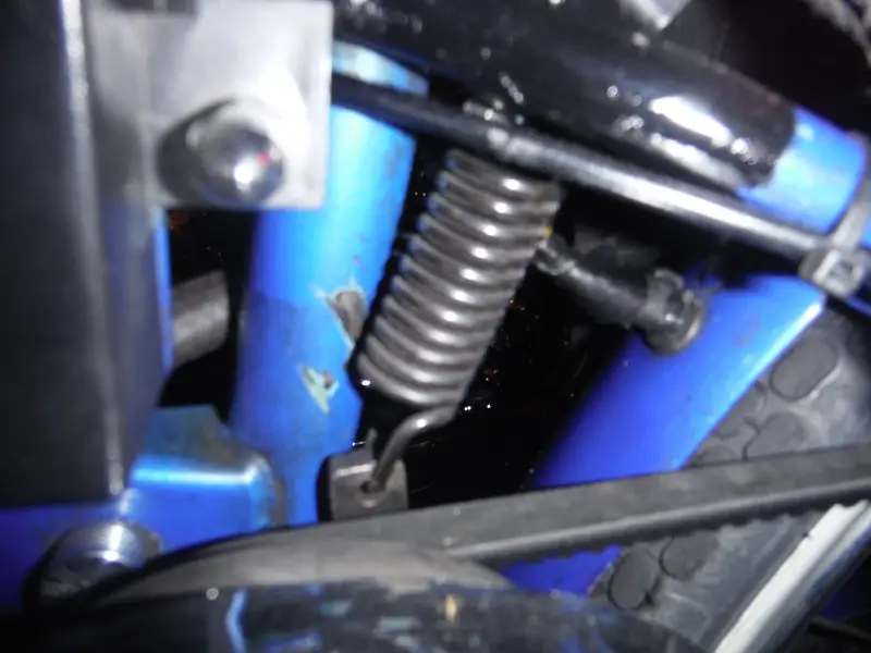

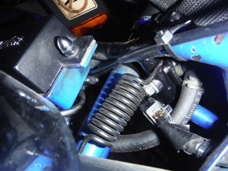

As Ray mentioned You need to use the original Whizzer 90* right angle clutch arm and attach an original Whizzer spring to the Frame Like Whizzer designed it
If you count the coils on the spring Paul sent you, hopefully there the same as in my pic.
But I bet it's one coil longer
The correct length Spring and the 90* clutch arm is very important when mounting an auto clutch on a Whizzer frame.
AS ray said Use your 99 Whizzer Slip clutch arm and spring it will work with the auto clutch

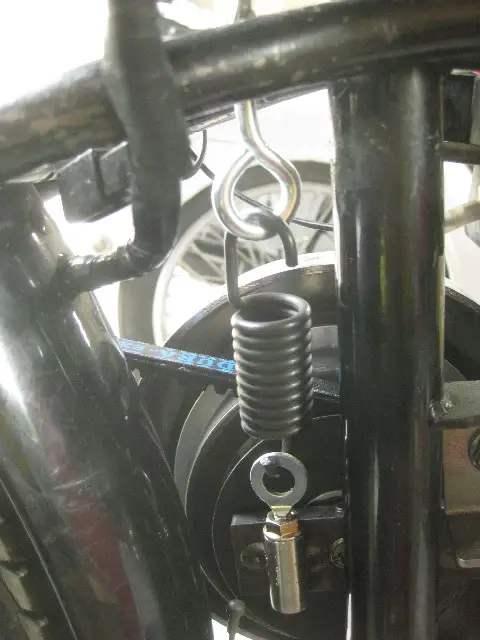

I modified the new arm with a threaded piece of round stock, welded to the side. the eyebolt and spring adjust just fine.I figured out the adjustments necessary to tension the belts. I jumped on the bike, pedaled off and the engine started instantly, as usual. I rode down the slight incline out of the shop and then around a stump and up into the front yard at a good clip...then the centrifugal clutch overheated and doesn't work. It seems to be stuck "on". I can't rev the engine and get any speed up, at all. I took the belt cover off and couldn't touch the centrifugal clutch pulley...too hot. I'll try it again tomorrow, after it all cools off...any suggestions? I didn't ride for over 2 minutes total...

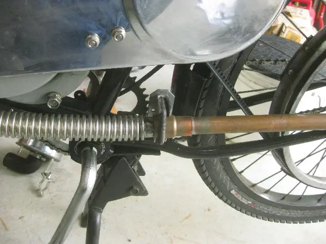

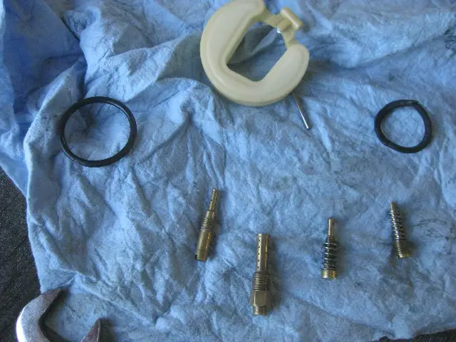

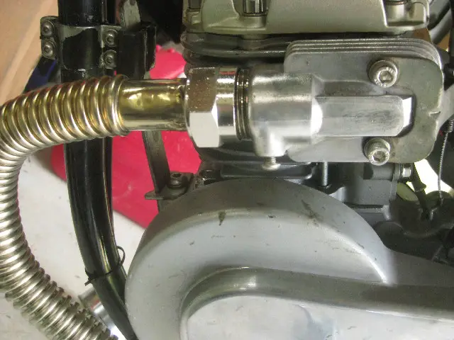

Bearings seem fine...didn't see a snap ring...put it back together and all seemed fine for a minute...then the carb seemed to run out of fuel...I had never messed with the carb. Turns out the P.O. stripped one mounting thread and used some sealant on the float bowl...might have fouled the jets...I'm researching parts...meanwhile, maybe someone would like to see my exhaust mods...and pulley tensioner mod and carb parts

BTW I surprised ya didn't use your Original Whizzer 90* clutch arm and spring
hmmm...gotta look for the clip....I really didn't want to mod the original arm when it was easier to use the one Paul sent...
The original arm don't need to be modified but ya gotta use the original spring with it.
and hook the spring to the frame in the original position
