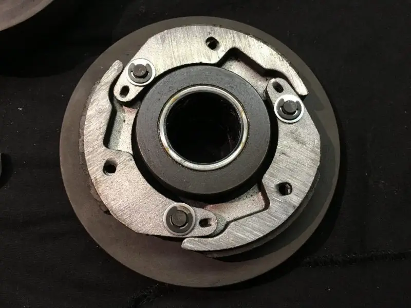

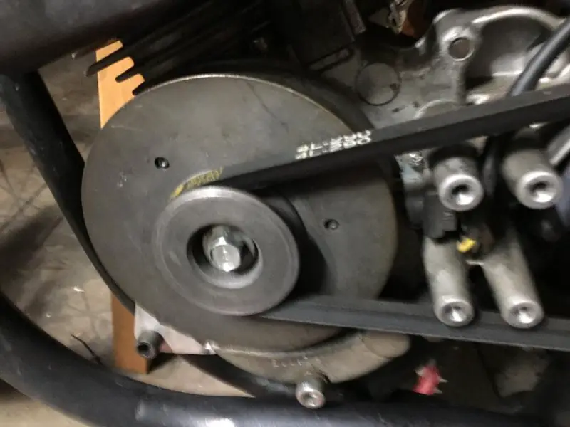

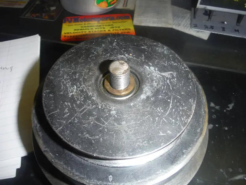

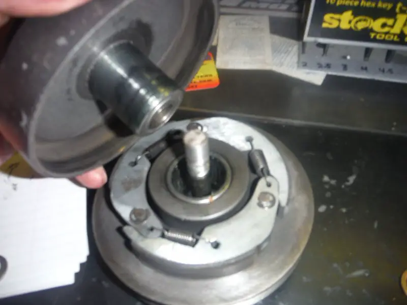

Hey fellas... I'm working on a Whizzer for a friend & the clutch is slipping really bad!!
I've tightened all the belts, but the problem seems to be in the clutch pads aren't grabbing enough.
I sand papered the pad & bell surfaces, & even removed the springs that pull the three clutch pads in... This all helped a little, but the bike is still winding at really high RPMs & barely moving. :(
Any ideas? Are there any heavier pads I can buy for it?
I included some pics of the clutch... Thanks in advance! :)

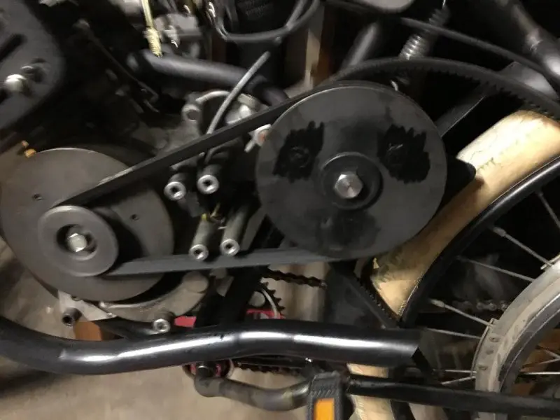

I don’t remember who sells it, but there is a max-torque based jackshaft out there for these. There is a problem in that the spacing gets messed up because whizzers usually had a manual clutch with the JS pulleys right next to each other. I’m trying to fix the issue on my buddies whizzer with the max-torque auto clutch. Probably going to move the motor about a half inch to the left.
also you may want to run a cogged type v-belt for the front due to the tiny pulley. Believe it is the AX style belt.

The clutch looks new and needs to be burned in You will notice only a fraction of the pad is making contact to the drum you will need to keep sanding off the pad contact black burned area until you get at least 1/2 pad to drum contact. When ya get the clutch to engage ride around the neighborhood revving the engine, Yes the clutch will slip but you'll be burning it in.
To speed up the burn in process park the front wheel against the wall and burn in the clutch until ya get full pad to drum contact. Whizzer USA called this the Burn in period

That's pretty much what I figured out on my own.
I noticed that the clutch was grabbing a little more every time I rode it... so I totally removed the springs & sanded the pads to match the clutch bell.
It actually rides really nice now without the springs. (^)

Now that ya got the clutch to engage better put the springs back in.
You'll have better performance with clutch engagement at higher RPMs.
Whizzer USA and Cruzzer have used different strength springs over the years not sure what springs ya got.

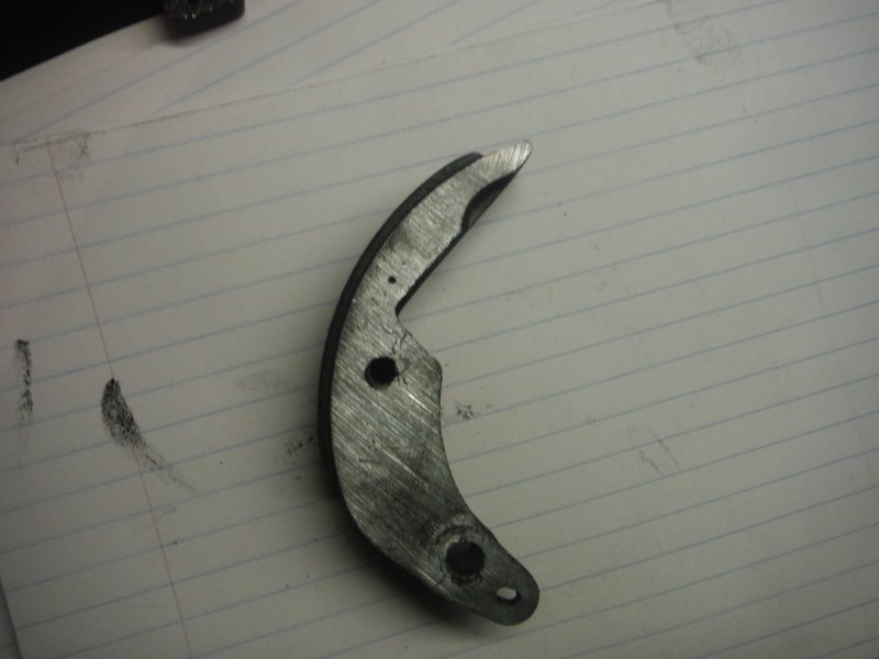

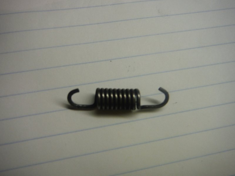

I use the springs Cruzzer uses now and I also lighten my clutch shoes to get the clutch RPM engagement I like.
I thought I remembered trying the clutch without springs once. I guess I didn't like the way it engaged at low RPMs. Excuse me for saying it wouldn't work.
Pic of a lightened clutch shoe and the Cruzzer spring

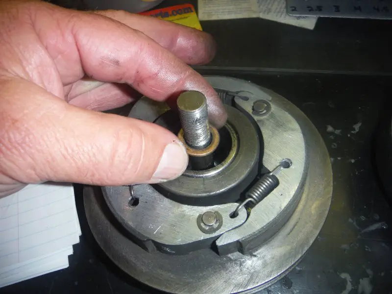

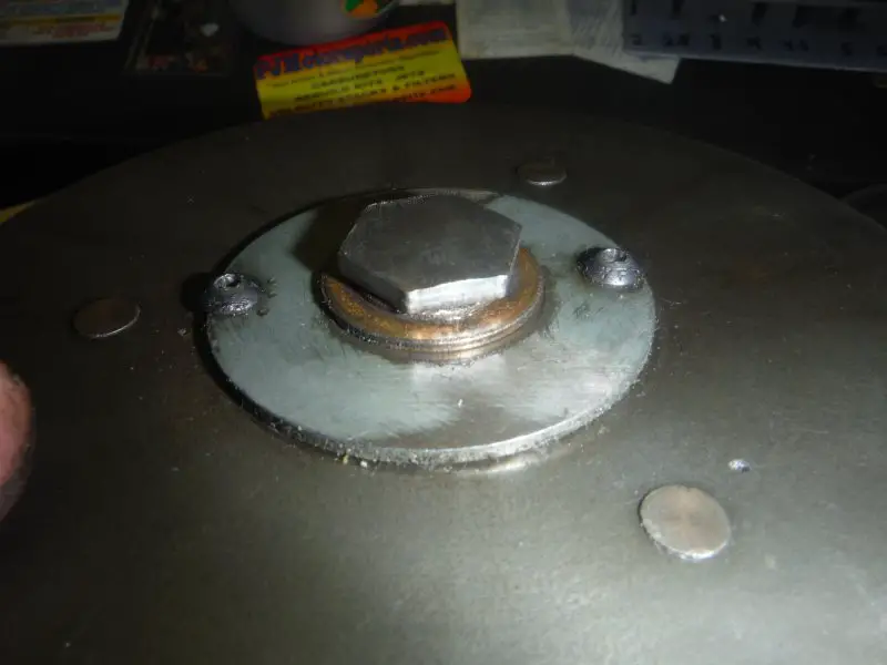

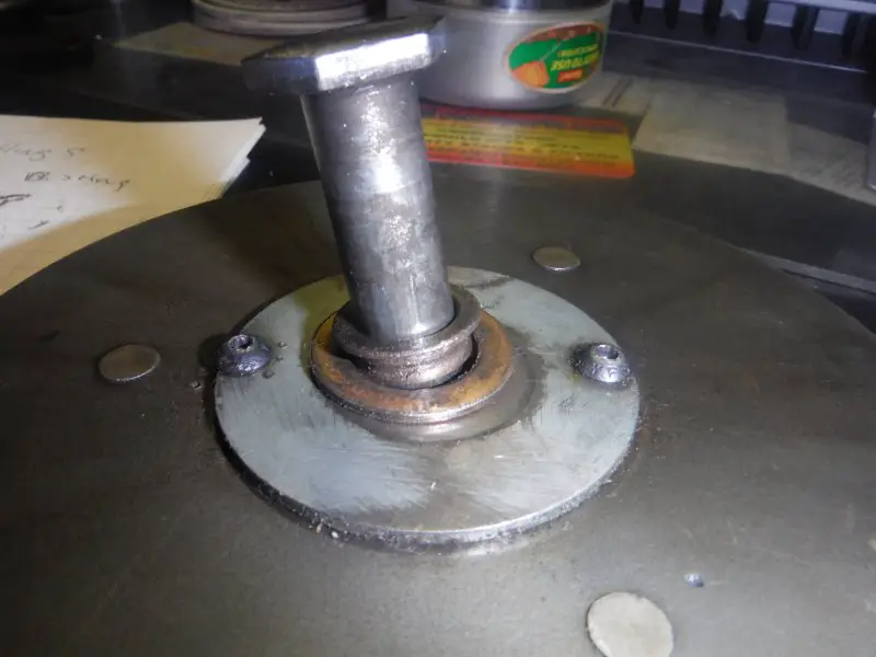

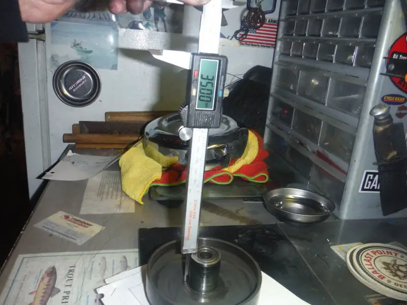

I also modified the clutch to spin better but will require some explaining.

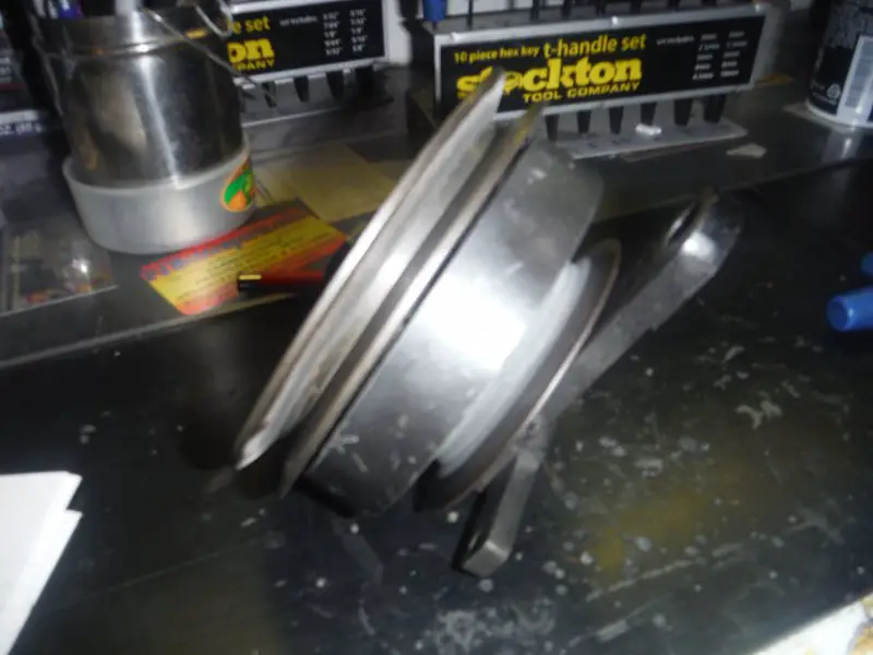

pic of the cover plate and Bronze bushings.
This set up requires shortening the Whizzer Clutch Shaft to 35mm
Also requires making sure the spacer in the clutch shaft between the 6901 bearings is the correct length.
No slop and I get full pad coverage by the drum

Thanks for the advice, but I originally posted this over a month ago asking for help.... I got ZERO help when I needed it!!
I solved the problem, & the bike is now back to it's owner (& running great without the springs). ;)
*edit* ... I like how the engine engages at low RPMs without the springs... It's very nice for 'cruising' around the beaches & streets.

I know the clutch can wear funny the way it's currently set up.
The retaining washer eats into the clutch face The clutch shaft wears into the retaining washer. The clutch drum only covers part of the shoe pad. My pictures are posted for others to notice who might be having an issue with their clutch

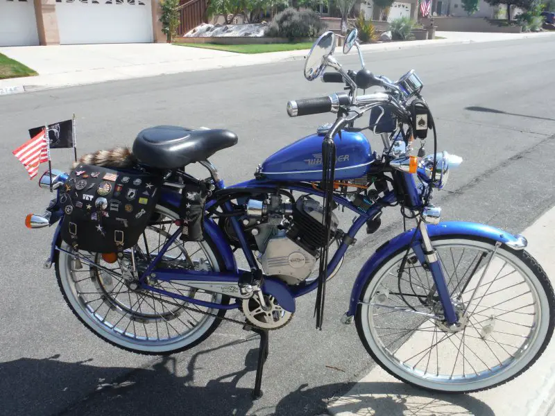

I've had my NE-5 for 15 years, Check out my odometer Miles.
Since this pic I now have almost 38,500 miles

I included some pics of the clutch... Thanks in advance! :)View attachment 105668View attachment 105668View attachment 105669View attachment 105670

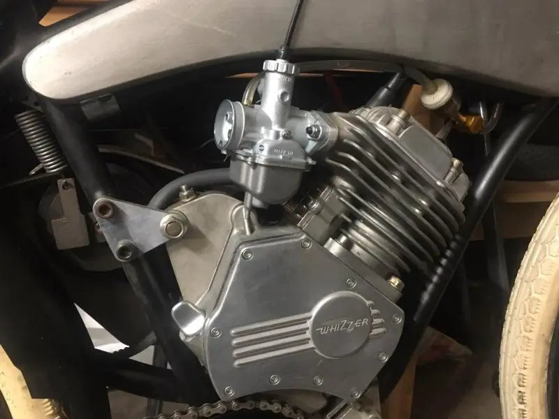

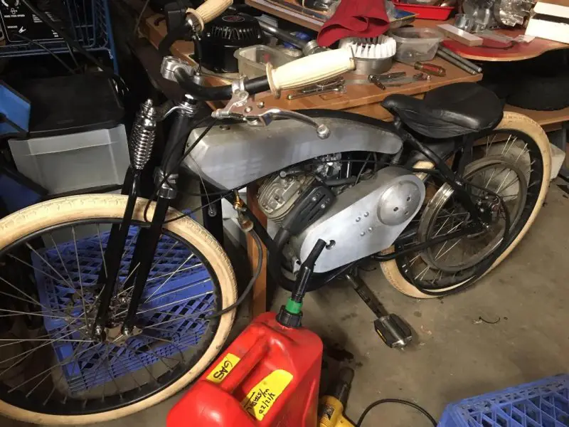

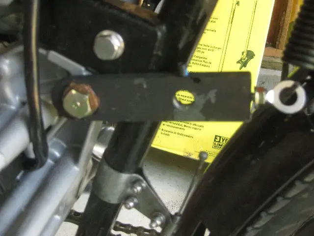

Here's few pics of the bike... it's a vintage Monark Whizzer with a modern engineView attachment 105908View attachment 105909View attachment 105910View attachment 105911
Not sure why the builder thinks it's a good Idea to use the clutch arm mounting bolt as the motor mount. I would suggest to the builder to use the stock mount bolt location on the motor.
The clutch arm mounting bolt needs to be able to pivot with the clutch arm.
So no way the clutch arm mounting bolt should be used as a motor mount bolt
That means if ya tighten it down tight it prevents the clutch arm from moving
If ya make the bolt snug so the clutch arm will be able to move then the motor mount is loose

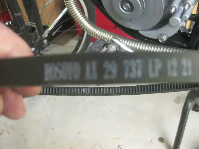

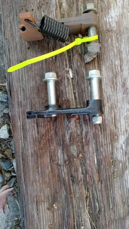

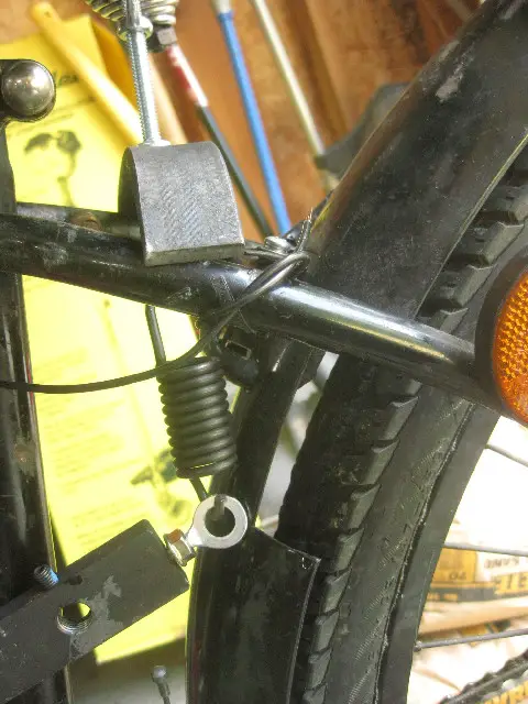

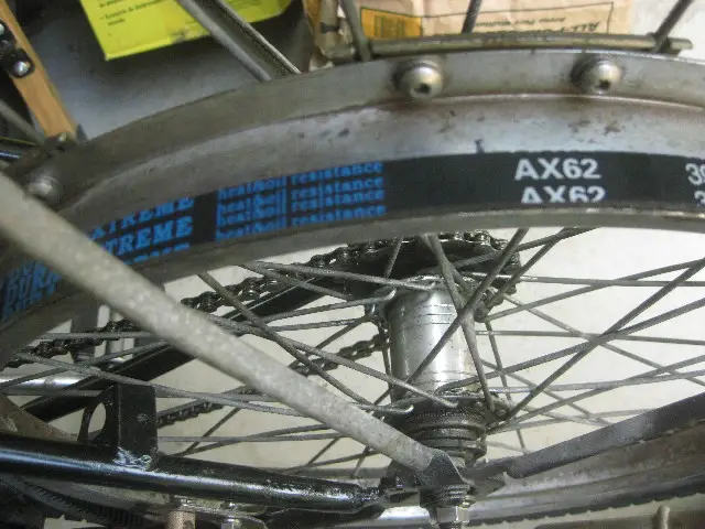

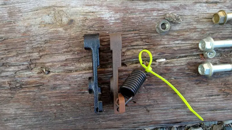

Hi All, 2 weeks ago I received a centrifugal clutch kit from Whizzer Paul...I've been trying to mount the kit and not much luck. It looked so easy...I tried using the old AX29 and AX62 belts after trying new cogged belts of the same size. If I slide the motor to the end of the adjustment and the rear wheel forward, I can barely get the rear belt on...then the front belt won't fit at all...Plus, the eye bolt on the new clutch arm hits the rear fender. Paul sent along the adjuster that fits over top of the frame and a new spring...that set up looks like it'll never work as its far too loose with everything adjusted up...I wish someone would make a video of their installation, showing clearly how it all is suppose to work. I've attached pics of my set up. This is a '99 model Whizzer.
Not sure about the Cruzzer
The clutch arm and spring length is all different from the Whizzer
Good luck, Maybe you should ask Paul what's up

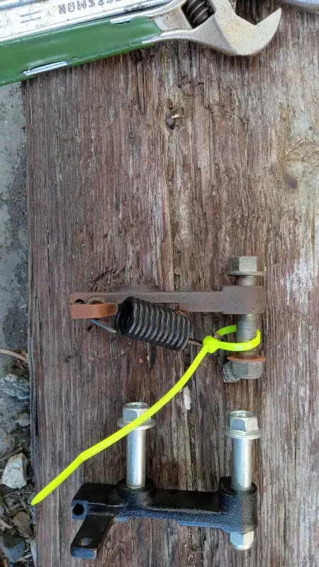

Hi Dale, you can use your original slip clutch arm, In these pics, the clutch arm with the yellow zip tie is for the auto clutch. You can see it's thinner. You'll need to sand down or file down. You already have that arm, just a little more work to do.

thanks for the pics, Ray. I still think that there will be a problem with the AX29 and AX62 belts...that arm doesn't affect the fact that the belts seem way too short to work with the centrifugal clutch on my '99 WC-1. Has anyone had to go with longer belts?
Those are the right belt size you have. Using the original slip clutch arm and pulley with those belts is the factory set up. Removing the slip clutch pulley for the auto clutch is basically the same Dimension.
