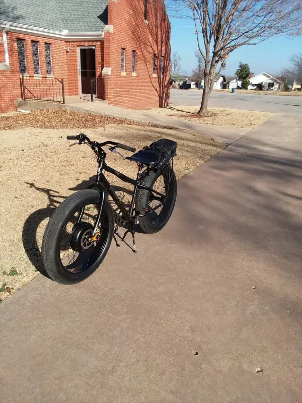

I've ridden the fat tire 48 v. front hub a few miles to this point & it's great fun. The big tires just float along & it's quite comfortable for a rigid. I rode in the wet yesterday and grip was great! It's a fixie but pedals well, though hills are a challenge without motor assist, so no surprise there. I short charged a new set of sealed lead batteries' that are only 5 amp units (what I had) for my first mileage trial, but covered more than four miles with some pedal assist before testing the pedals full time for the final mile home. I'd ridden a few blocks previously & was impressed with the quickness of the 1,200 watt hub, so the mileage test was conducted at low speeds on varied terrain. I'll repeat the same route today with a full charge. I'm not expecting much more than the initial result with the small capacity batteries'. I know lead cells and found some new twenty amp sealed cell batteries locally for sixty cents per amp (per battery) so I've bought the entire lot, enough to build three 48 v. packs.
That brings me back to hybrid's & the 3 hp Lifan plus alternator mounted in a trailer to charge up packs on longer adventures. At almost 44 lbs. per pack plus the weight of the engine, fuel and trailer say 80 lbs. this is pretty heavy load for an already substantial bike weight. I can't see this as a viable option as compared with just trailering a couple of extra charged battery packs giving a total of 60 amp hours.
Distance traveled to total load weight carried is a big factor as well. I'm 170 lbs. but a much larger rider also figures into the equations. Of course the only reason lead batteries make any sense at all in my case is that my initial cost per amp hour is so low, less than $30. per 48 v. pack, that and the fact that 44 lbs. of battery added to my weight is still modest when compared with many riders.
Using lithium packs with the charging alternator/gas engine setup could still be a reasonable approach, but I can't see it with lead. Still learning so help me out here.

Now back to hybrids & my fat bike. Having a front hub electric fat bike to use as a test bed; I'm still considering mounting my 3 hp Lifan 4 stroke as a driver for the rear wheel. This has to be more efficient than using the gas engine for generating power to recharge battery packs. This plus adding 3hp and all wheel drive. My thought is CVT power train & leave the engine as is (with the exception of disabling the governor) including the engine gas tank...super quiet operation & compact. Fuel capacity could be easily be increased with a spare peanut tank used as a reserve.
The straddle tube is really the only mod I'd require on the frame to accommodate the small engine and the weight increase would only add about 30 lbs.
