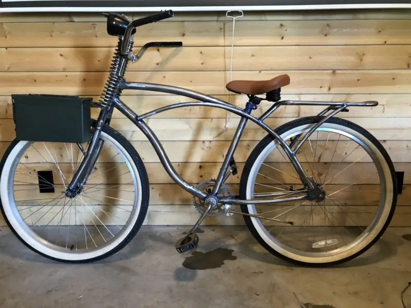

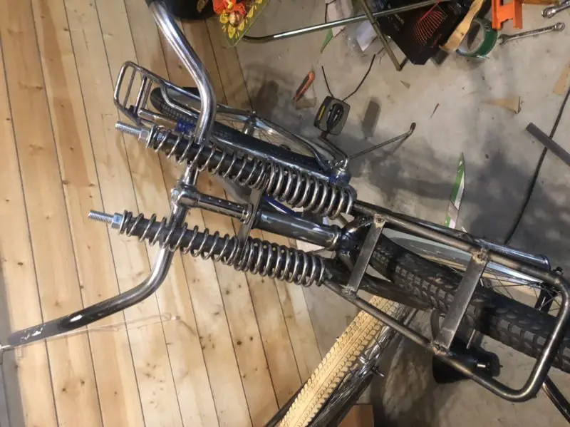

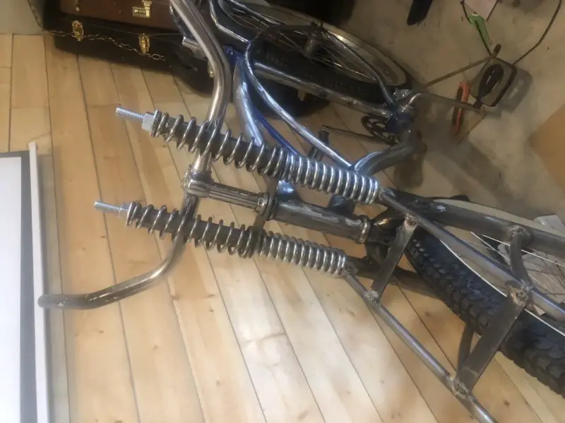

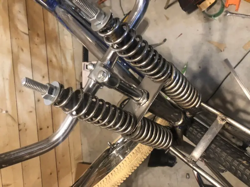

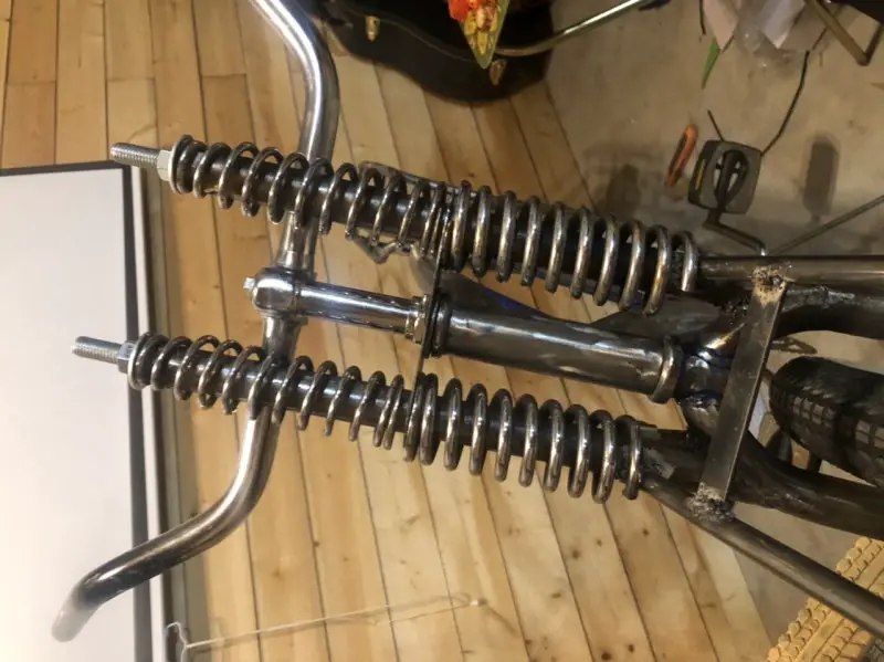

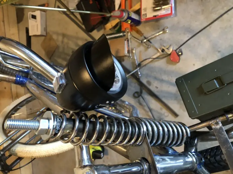

Just need to cut the top bolts off when I get some acorn nuts. It does look a little undersized on the bottom springs, so I might cut the lower Harley springs up I bought and put those on there.
Just compress the top springs more to balance the height. Upper springs are lighter gage and are just for looks..
Too late chopped my Harley lower springs. Wasn’t worried about the height as much as width on the lower springs. Looks more balanced now. I can only go so high on the lower springs anyway because of the fake triple tree.
I think it looks good.

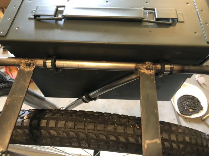

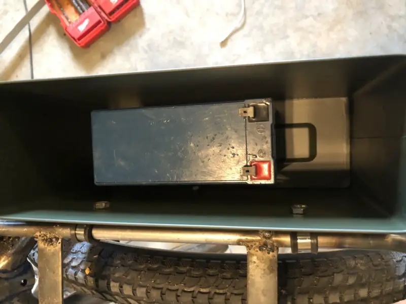

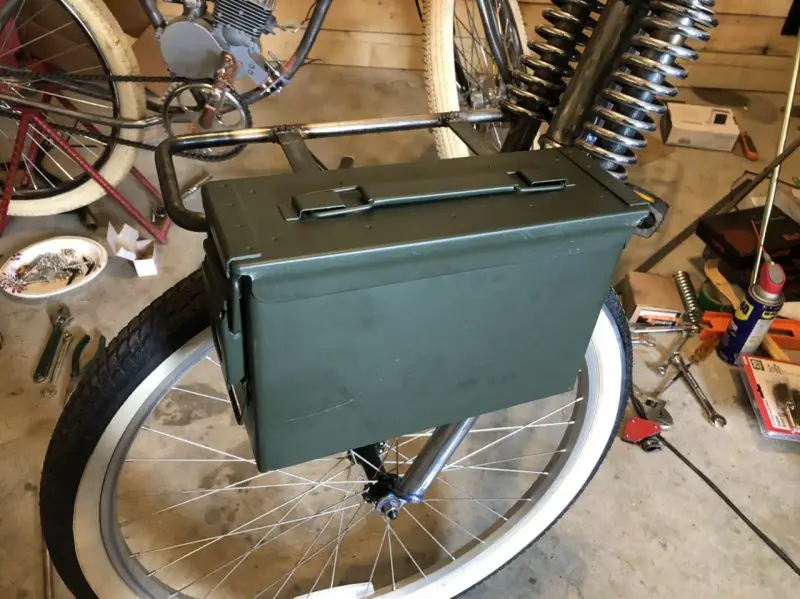

Wire clamps installed for ammo box.

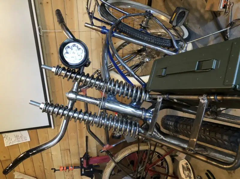

And I have a small 12v battery I may put in there to operate a 12v headlight.

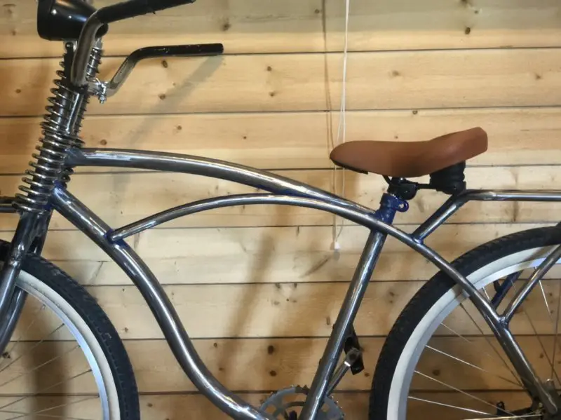

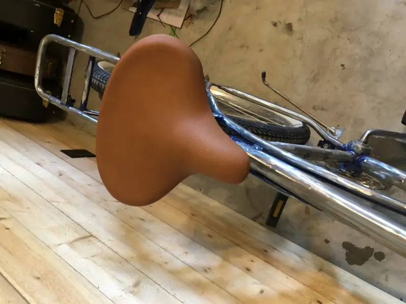

Looks like the seat I bought is going to work. So I’m going to get a suspension post for it.

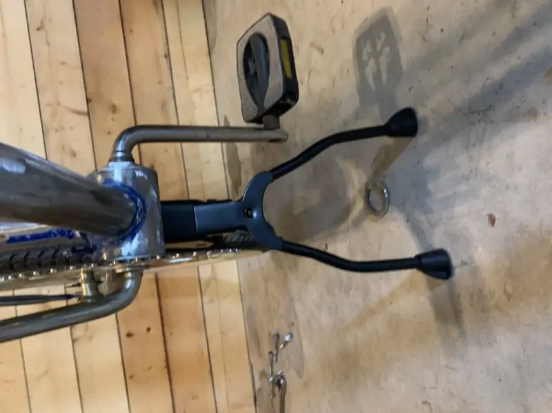

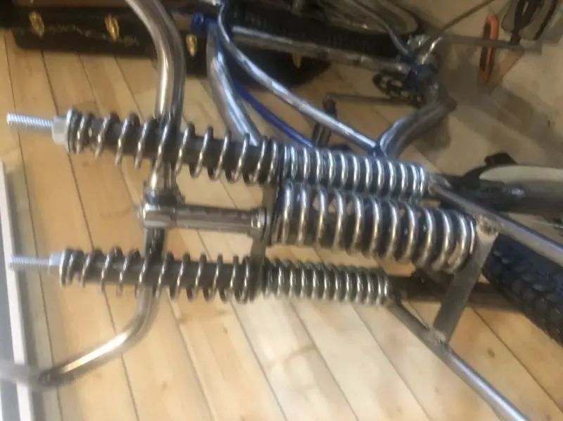

So today I got my center stand.

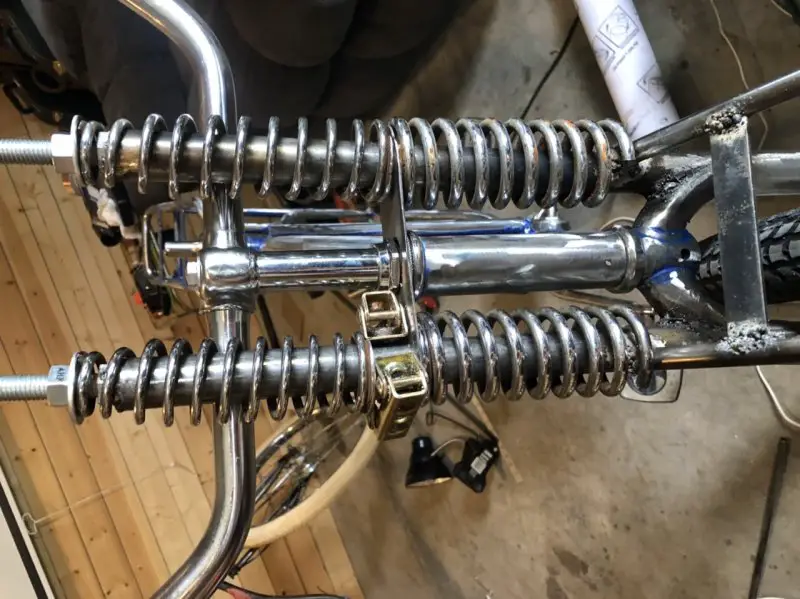

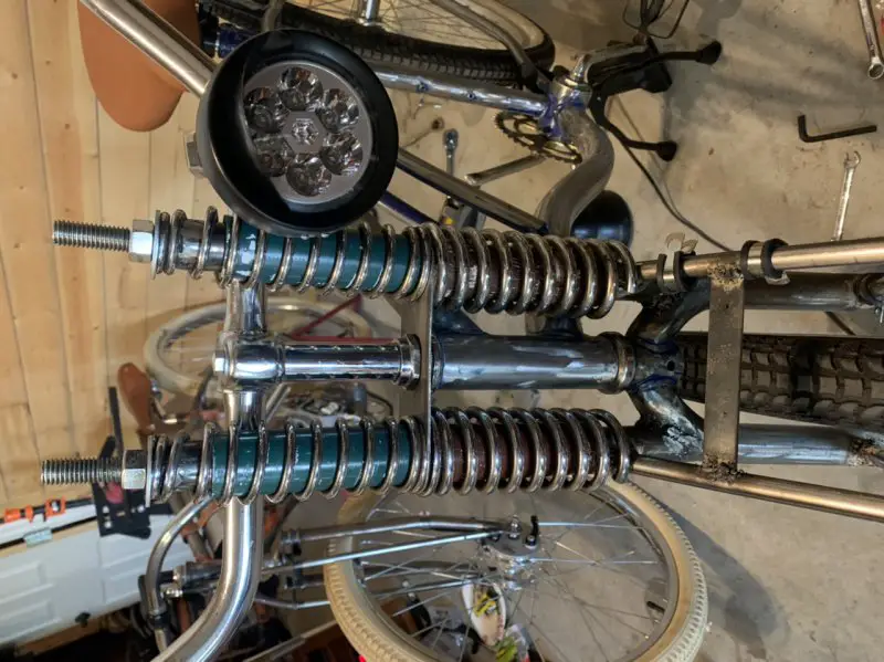

also chopped the springer forks more to compress the top springs a bit more. I have some PVC in the center of the springs for alignment. They are painted green and brown. Don’t have a can of black paint in the house lol
