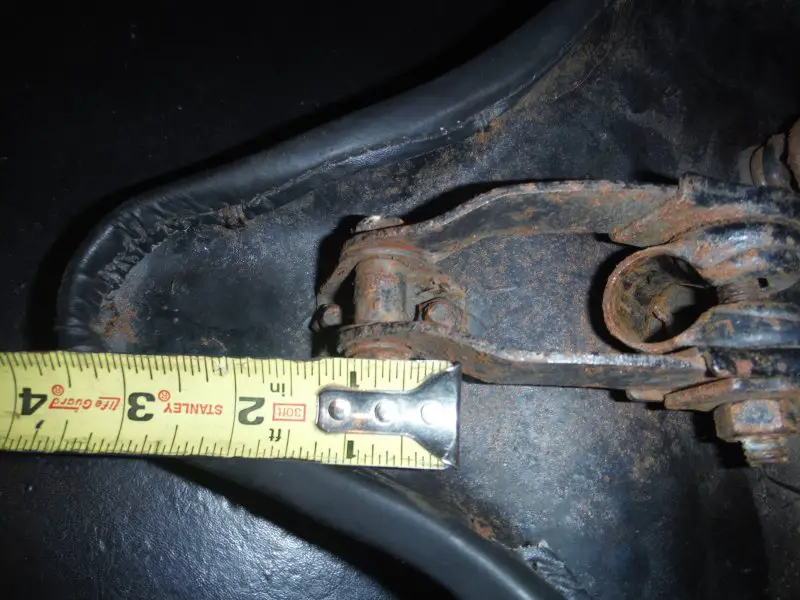

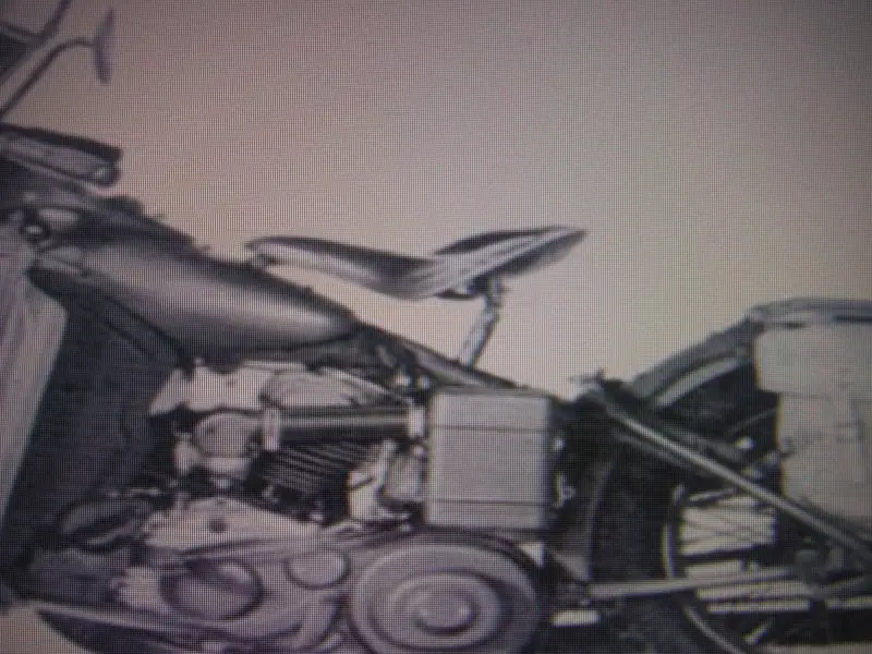

Is this what ya mean by bicycle seat suspension ?

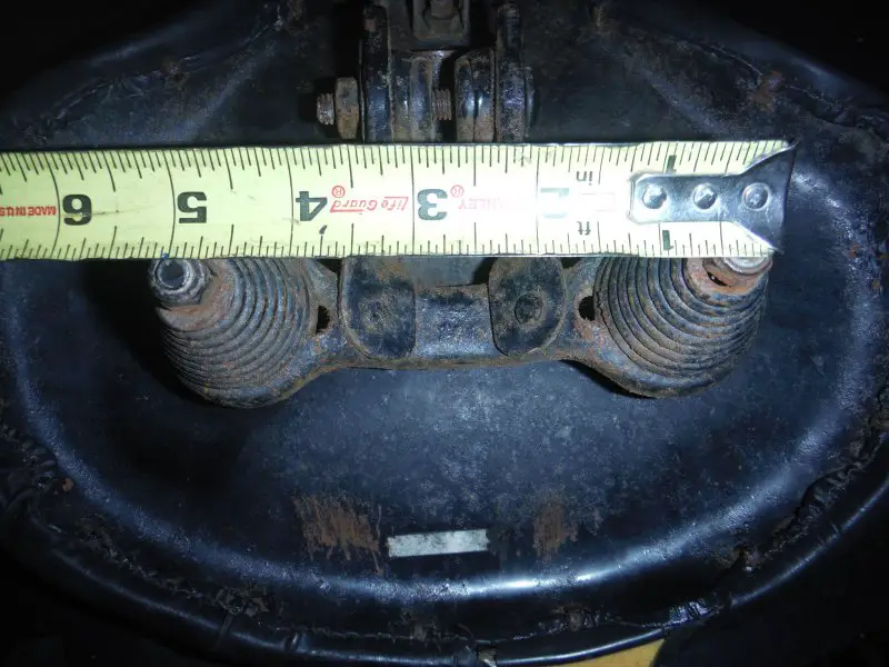

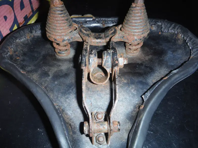

Pics of an old a 20 year old Worksman seat and it's suspension
I guess you can take the India seat cover off and change the bolts position in the seat pan to line up with the seat suspension frame ya got. also use the correct length of bolts for the springs

OK I see, WLA Sure a guy like you should be able to figure out how to mount that.
Wow, thank you for the picture. It made me go back and look at some of my other pictures a little closer. I had not noticed that the front of the seat was attached to the gas tank. I appreciate your confidence, and yeah I’m thinking I can figure something out, lol.

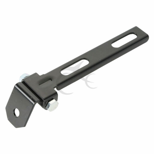

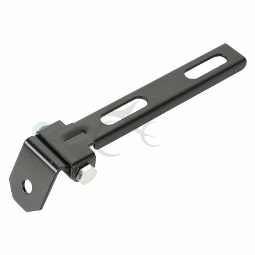

Let's back up a little. First up, the WLA-inspired seat look you're after should be fairly simple to achieve. You'll need one of these hinged solo seat front mounts (hundreds of these on eBay). The WLA pan should already have bolt locations for one of these.
