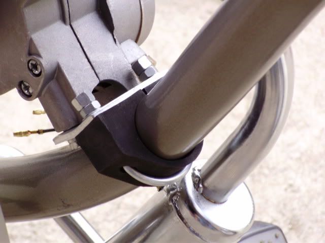

does anyone have the seat tube and the downtube width/size for the 26in cranbrook i am building a new motorbike and the bike has not came in yet but i need the sizing so i can start building the mounts.
downtube on mine is 1.5" OD, did not measure the seat tube, just opened the rear mount up slightly with a spindle sander. made this front mount. (posted on the mounting techniques forum)
