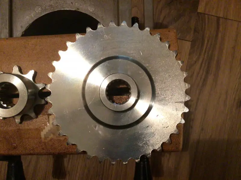

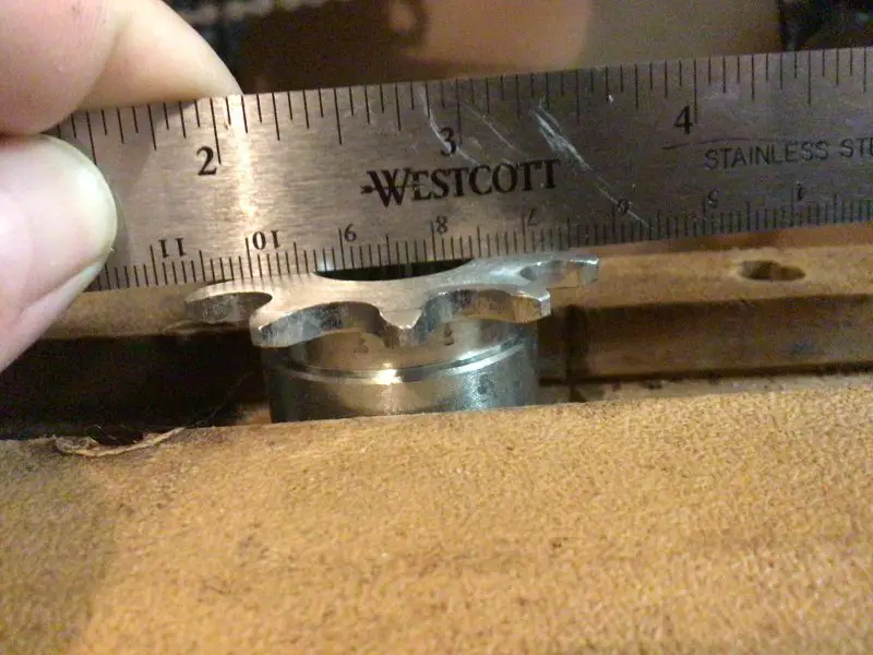

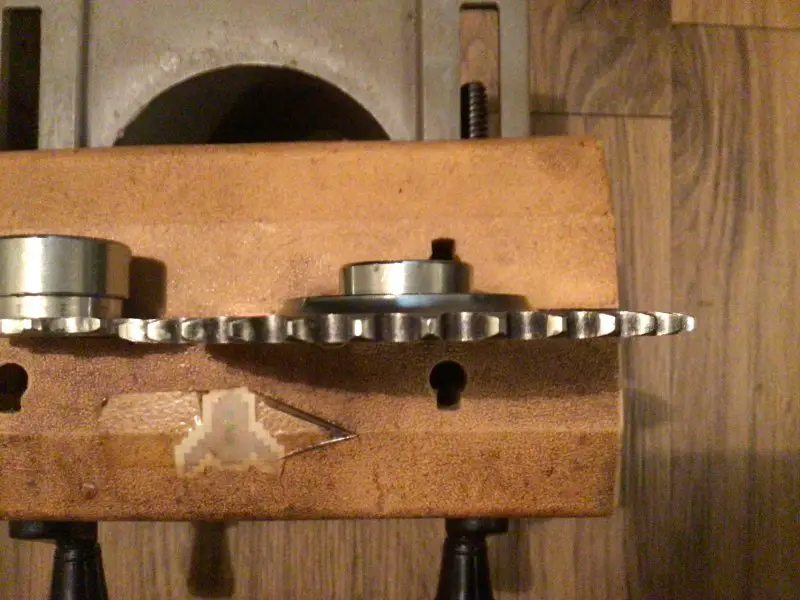

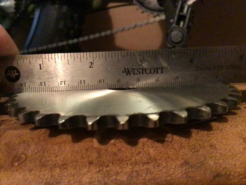

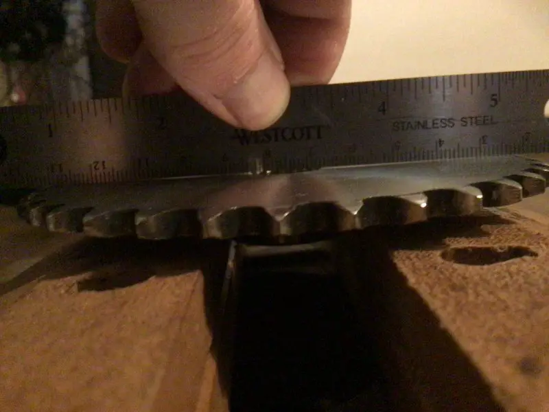

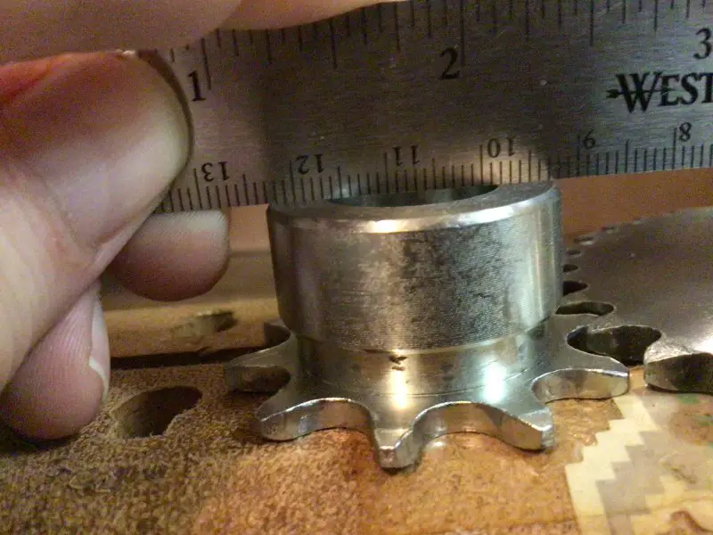

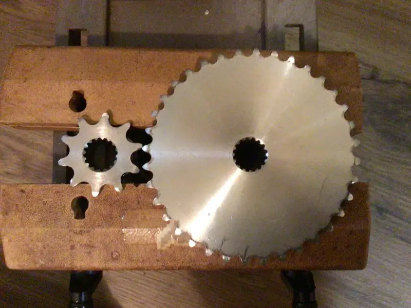

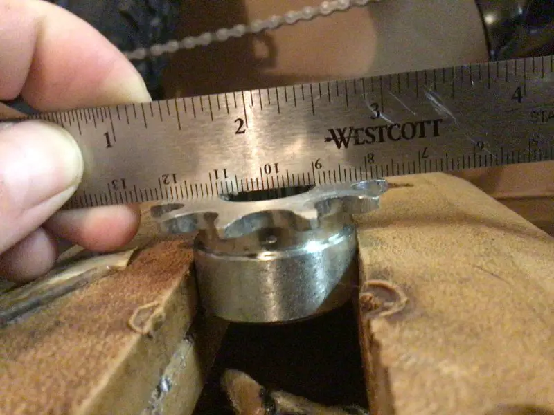

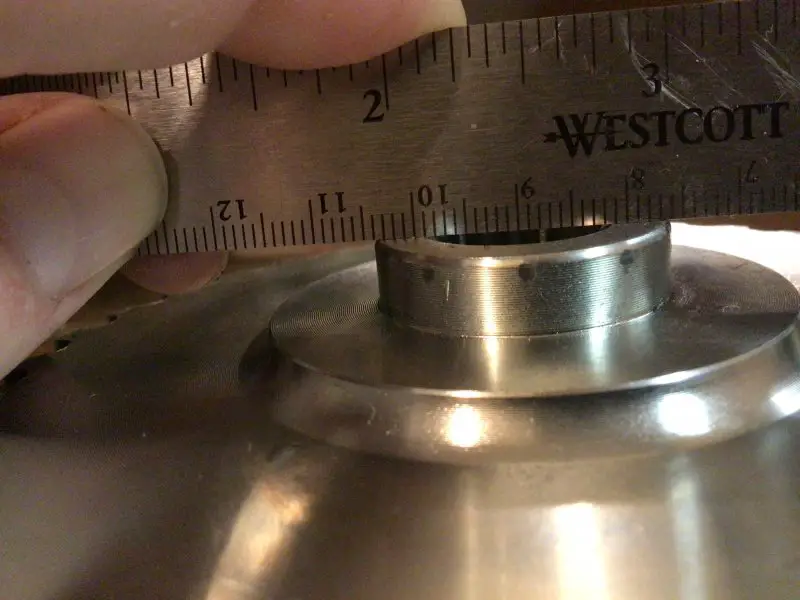

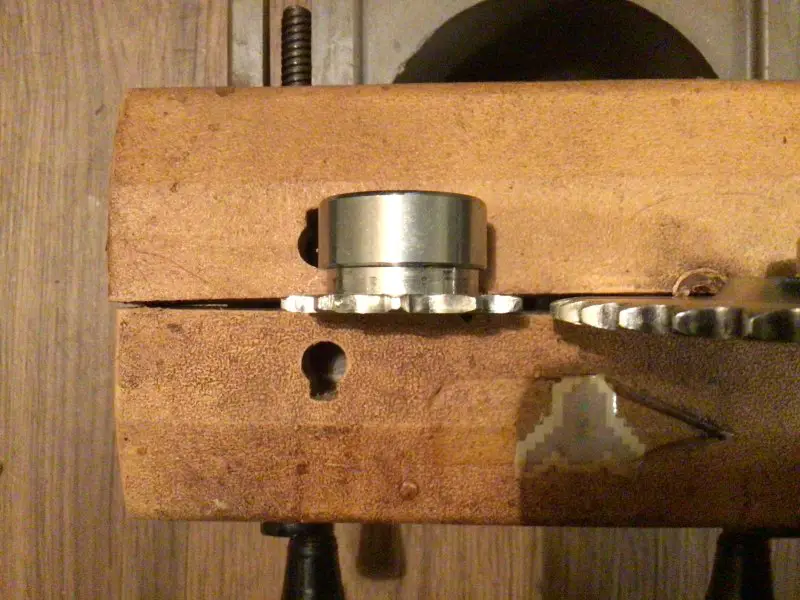

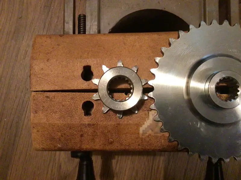

VMB is still waiting for a photo of a straight edged ruler clamped to the large jackshaft sprocket and clutch sprocket photo. Oblige him Cole, if you would please. Several perspectives.
Yes... A few good pictures (as described) would solve this mystery (& also be exactly what Gasbike would need as undisputable proof of a defective frame).
I have been meaning to get you those pictures Venice, it’s been a busy weekend for me. Let me go grab them real quick.
There we go, two angles for both sprockets each, with straight edge, taken 90degrees apart locked in my vice. The rest are behind and above shots as well. If you need them mounted and other angles I will get them for you tomorrow. About to pass out if you can’t tell by my shoddy photography haha! If I wasn’t so tired, I would find a 4th arm and pass a flashlight behind, but you should be able to see they are true enough more or less. Just wanted to let you know I ain’t forgot about you @Venice Motor Bikes!
Your pictures aren't in any way what I was asking for... We're trying to figure out if the jackshaft mount in the frame is in fact welded out of square with the seat post tube...
This is what we need....
