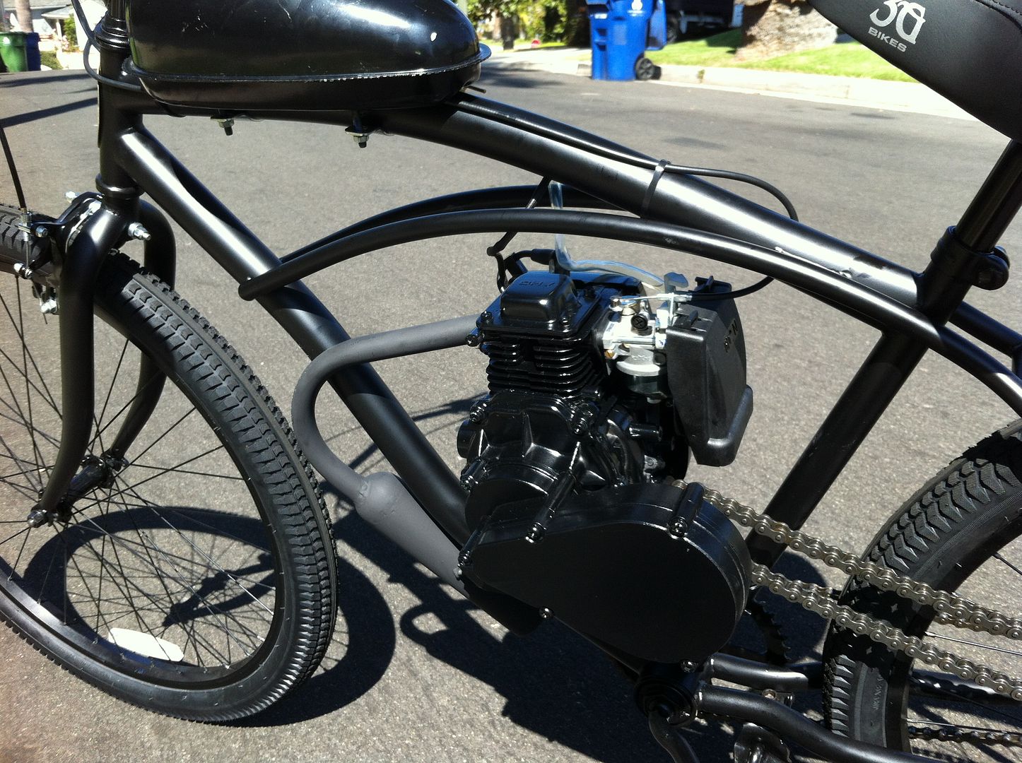

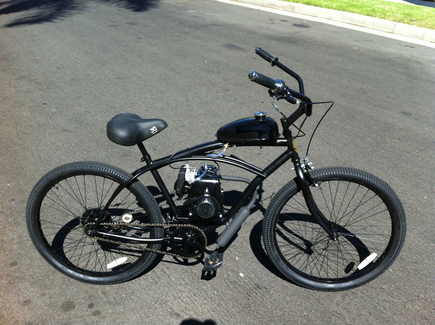

I use good engine paint for the engine itself, Krylon plastic paint for the fan shroud & BBQ paint for the exhaust pipe... Here's a pic of a 'murdered out' 4-stroke bike that I recently built.
If I had a pic of the other side, you could see that the whole engine is black engine too. :/

Also... Here's a pic of the other side of that engine.
