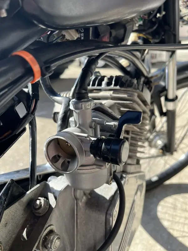

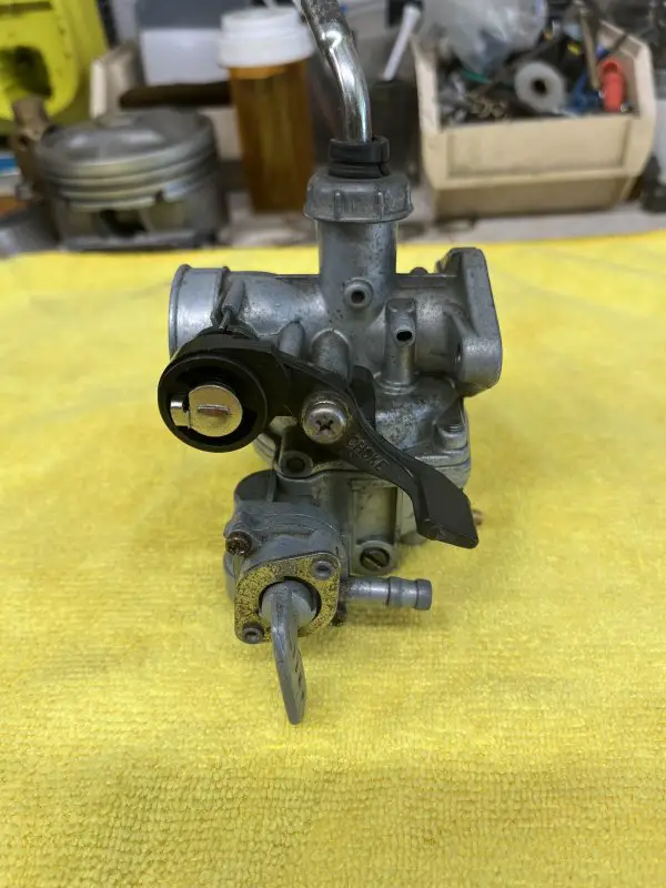

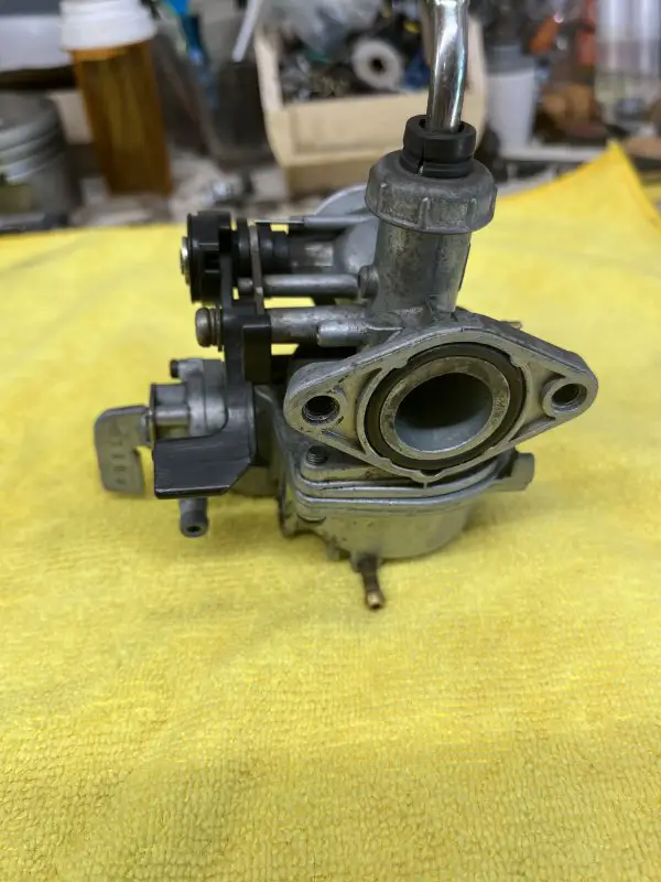

It ran at high idle with the old carb, it got me around the block but if I tried to give it throttle it didn’t like it.

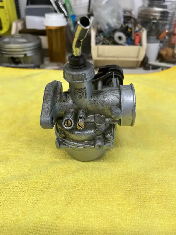

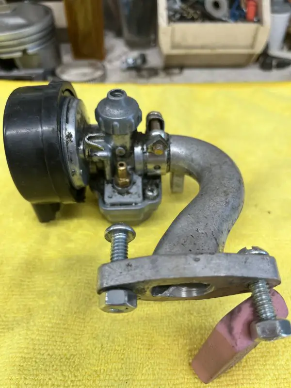

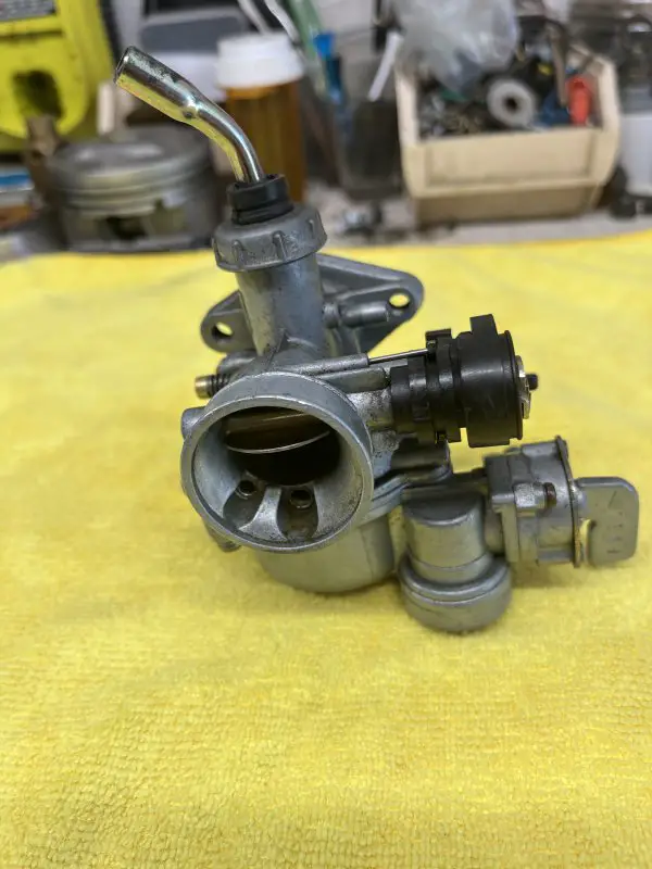

How about posting more pictures of the other side of the carb (& also the pictures of the old carb that I asked for)...
I'm asking for lots of pictures because they might help someone spot a problem!

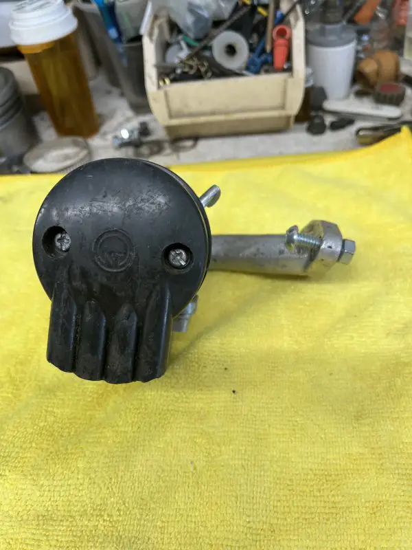

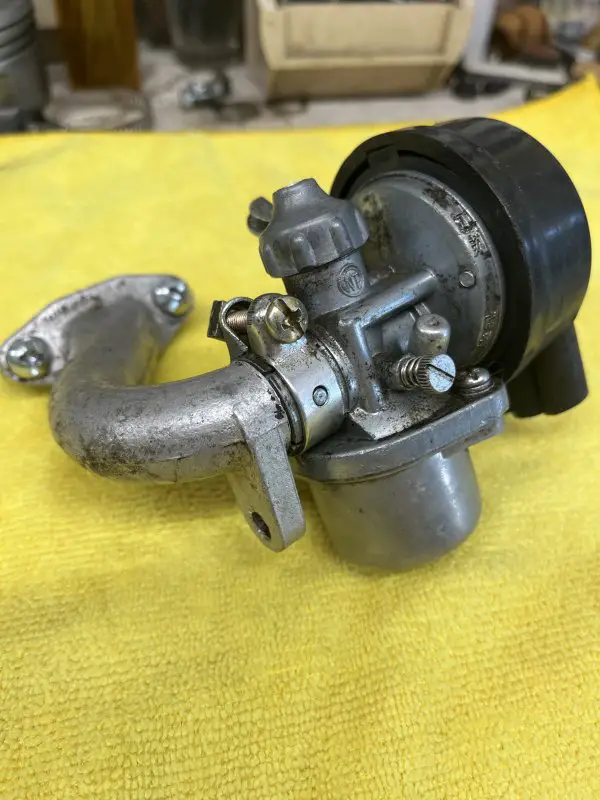

This is the original carburetor, it was not on the bike when I got it

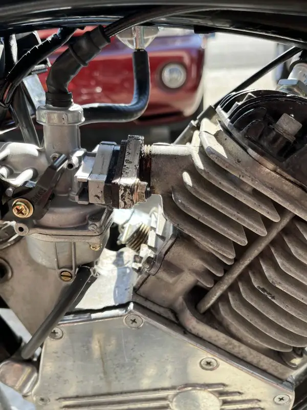

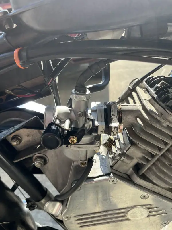

This is the one that was on the bike

Am I missing something here ? The picture of the engine shows the carb mounted on the side of the cylinder like a 2 cycle. Everyone keeps talking about valve settings, what valves ? The replacement carb is a better carb, but make sure it’s level.
