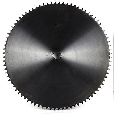

Hi eveyone Where can iI find 84 tooth sprocket?
steveK
Dec 1, 2020
5
4
3
68
Looked all over internet for 84 tooth sprocket no luck.I have a 3 wheel schwinn with predator 212 with a 60 sprocket its very fast.I live in trailer park in the foothills with dirt and bumpy roads its hard to get up on some of these roads so more torq is needed less speed no problem Thanks for any help Im also a noob to 3 wheel motorized bikrs and forums.Thanks

Gopowersports.com has an 80-tooth sprocket, #35 chain. Cost $19.95.
This should work well.

How many teeth on your clutch?
If you have #35 chain, I’m guessing 12 tooth.
That means you have 5:1 gear ratio, with your 60-tooth rear gear.
With the 80t sprocket, you’ll have 6.67:1 gearing.
