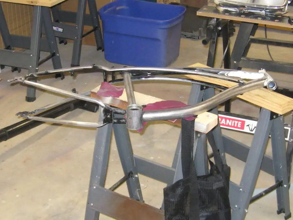

alright guys, it's been a few days, but needless to say I've been working hard on my bike. When I was a newb and did not know what I was doing, I drilled a 1/4" hole in my frame. Not wanting to compromise the structural integrity, I called up my welding buddy to see what he could do. I'm not sure if he welded the holes until they were full or put in a rod and welded it in, but by the time I went to pick it up, you could not even see where the hole originally was! I only paid $10 for that. I left my wheels down at the bike shop, front and rear, to get a truing since both wobbled. For the time and energy I would have put into it, it was fine with me to just pay the $26 total for truing. I also got my cassette removed so I could repack the bearings with high grade lithium grease. I'll pick the wheels up tomorrow :) I've been working REALLY hard to get my frame ready for paint. Being clever, and on a budget, I duct taped my dewalt orbital sander to the hose of our 3.5hp shop vac and I made a beast that would not spew dust everywhere as I took the paint off the frame. After about an hour of getting all the major surfaces, it was 8 hours of nickling and diming to get the tight spots on the frame by hand. The end result is that over 90% of the bike was down to bare metal by the time I got to shooting my first layer of self etching primer. I only had a few runs when I sprayed it, but I'm going to do a light sanding before moving on to filler primer and then the flat black barbecue paint which I love because it looks good, is durable, and is CHEAP. The first pics are of the complete-ish bike right before I installed my chinagirl HT last year, and the frame about mid way through nickle and dime sanding.

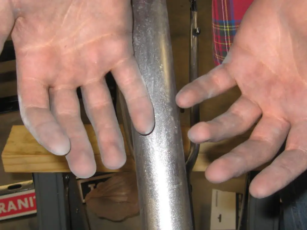

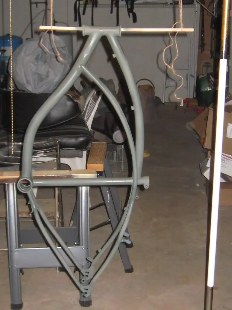

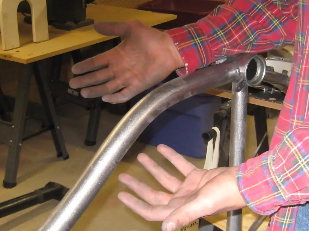

The next pics are an idea of what my hands looked like next to the frame. At that point there was more paint on me than on the bike rotfl The frame sure was clean. I wiped it down with acetone before painting, you shoulda seen the black that came off the frame! When I felt it was ready, I got a rig together, putting one of our portable clothes racks in the garage, and the other in the basement. It was snowing and in the thirties here, so I hung up the bike on my rig in the garage, sprayed, and quickly took it down stairs, where it is a constant 55 and low humidity, to dry. I think it came out pretty nice :) Also, I forgot to mention that I bought two suzuki lighting coils on ebay today. I have no idea of their output voltage, wattage, or amperage, but I expect to get enough juice spread between the two to power a headlight, a tailight, and maybe a horn. I'll keep you updated on how the self sufficient electrical goes for this build.

Well guys, I don't have any fresh pics yet, but I got a lot of painting done on the bike today :) I shot flat black barbecue paint at my engine covers and handlebars, and have flat drab olive on my frame and chainguard. I have some stencils and flat white paint, so I will work on the lettering to make this look military. One of my favorite harleys is the 1941 military WLA (http://www.cmvpa.com/attachments/Image/wla.jpg) so I'm doing a tribute to it. I also feel that is important to be grateful for the freedom that I have in this country. Few days go bye when I'm not grateful to the soldiers overseas who are fighting to bring freedom to foreign lands. I love this country and I'm proud to show it, so that's why I'm building a tribute to a great American motorcycle from Chinese parts (oh the irony) Anyway, I hope you enjoy my build as it progresses! The Qmatic drive will be coming soon!
