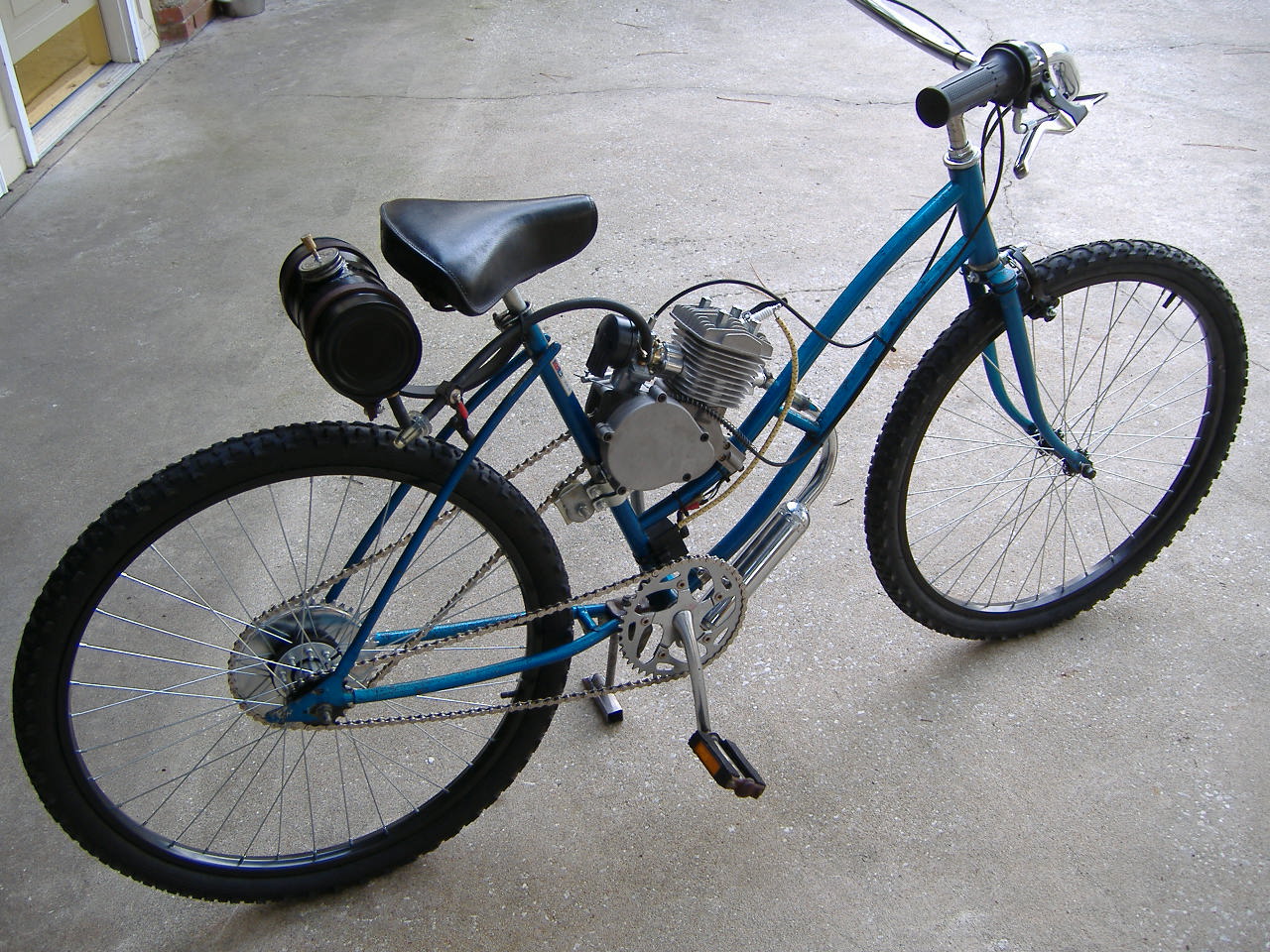

Hey SB, what cb2 showed is it! That's all I want. Do you solder the tank and cap, cause that's all I'm capable of, along with a coating of shhh! (jbweld).... I've got water bottles that I just drilled a hole and planted a valve with jb and no problems. I think a lg. can of bush beans would do it. If not the big juice cans would definitely do it. Dang I like it when help is needed, experience shows up, thx!
These were 27oz(a weight measure, not fluid) bean cans like Lucks beans come in. I soldered them together then hole sawed an opening and soldered on the neck/cap from another type can. I used a 1/4" brass air fitting for the fuel line outlet. Took about an hour to make.I then sloshed sealed the tank.
has been trouble free being used over a rough unpaved road for quite some time.
Just be sure the cans are sanded at the joint to remove the coating and use some kind of flux.
The large juice can might be easier. SB has a nice thread on making one including a beautiful leather cover. Way above my talent level!
Awl right, went thread searching, found the juice can threads, and will be drinking some juice today! I have a bernz pencil torch, gotta find silver solder, I have notice reg. solder got quite pricey lately. Do you have to coat the inside?? Coating are pricey too. Thx again for your experiential knowledge
All the new solder for copper plumbing is silver and will work + the flux. Local motor cycle shop should have seal kits just for tanks, may even do it along with another tank if they are doing any, if you get it so it don't leak no real need for coating. Just more or less a safety measure.....................Curt
