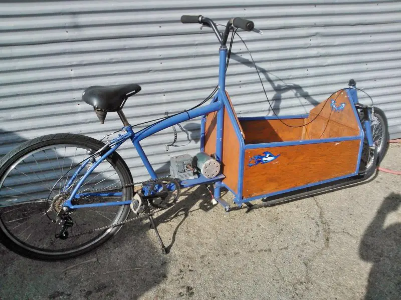

Yeah guys...i backed up a 26" bike to the back of the scooter and it turns alot faster than the scoot....but have you ever felt the weight of 4-12v-18ah batteries!!!! I've envisioned doing as you mention wheel6...even a long frame where both batts and hub sit between seatpost and downtube. A front box cargo bike. I'm going to see if I can find the thread. View attachment 97686
Here is the way I will do it. This was the build that got me into this addiction...i mean hobby! The hub wheel will sit under top tube(no seat post just gussets'. I'll not make the box so long this time, and the batts will sit in the box. Umm..

Your going to have to work out the roller/drive ratios. I mean for the motor. I had a 2.5hp Lifan powered bike that ran a 3.5" roller. It hit 45mph. Had to pedal it to 15mph before you could drop the roller.Accelerated slowly to around 25 then it took off. That bike was fun.
If your motor is 500w that's 2/3hp though it's got good torque. Work out the figures before you cut metal. I still have a hub motor with out the wheel that I want to use in a FD. Hubs have enough torque to handle it.
