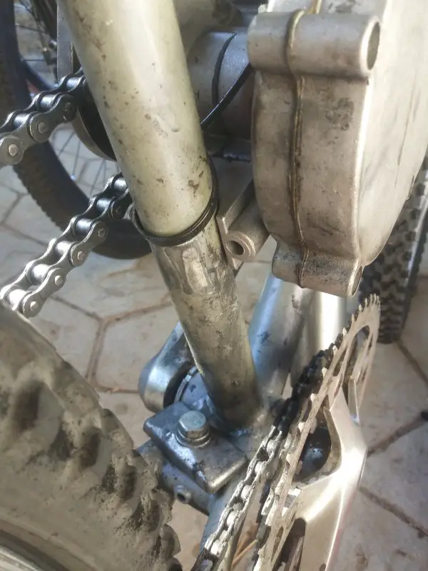

My name is Josh. Icve been riding gas bike's for a year now. Trying my hardest to learn the way's and not lose my patience. Lol easier said then done. I have a motor mount issue I have a question on. I've been trying to find a rear mount for my bike for the ladt couple months. It seems I either dont know what I'm looking for or I have an idea. Would a m6 hex bolt do the trick for a rear mount. I've been looking for a whole set up and that seem's impossible. Any advice is good advice. I got pic's and what have you to better understand my issue. Anyway's glad to be here. Josh in Cali.
Thanks for the reply. So as you can see my studs in the rear mount came loose. I lost one stud. And the back U bracket hokding the motor in place.

You'll need to make sure the other stud didn't break off in the engine, if not you can use 6mm bolts, you can buy a replacement strap on eBay. Be sure to use removable loctite on all mounting bolts.
You can get the strap from eBay for less than $10, measure the width of the bolt holes and search " motorized bicycle rear engine mount".
