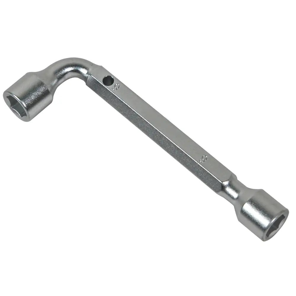

    If you have a 48cc motor with M6 studs, you can always drill and tap them out to M8. Room for the nuts will be a bit tight but 12mm x M8 nuts are available. If you have the 66cc with the M8 studs I don't think you are going to get M10 in there. Not a lot of metal around the stud for an insert nut. Pretty much gotta use a helicoil.
    As for what tool to use, the M6 nuts are pretty much always 10mm and due to the depth you have to use a socket. The M8 studs have 12, 13 and 14 nuts available. 13mm is ISO standard, 12mm is Japan standard and my Grubee came with 14mm, go figure. I carry a short "tube wrench" for on the road repairs:
    [​IMG]
    Stripped threads on these motors are pretty much always operator error. You have to use a torque wrench at least for the first 5 years of your motor mechanic existence. I use one in all the critical areas still.
    Steve
