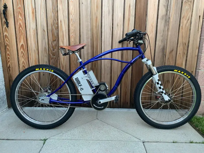

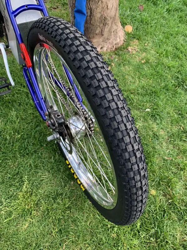

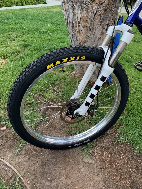

Thanks Ray, it's a well thought out bike for a factory bike. I've only cared to make small changes to it, mostly just to personalize it for my street riding tastes. Recently I bought a sporty new rear shock that lowers the rear an inch. I've lowered the whole bike now about 2 inches front, and rear. Who needs 10" of travel on the street? It has a very comfortable ride for a fast bicycle. Like a marshmallow cannonball.

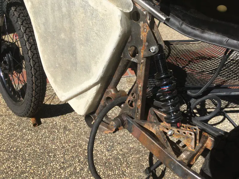

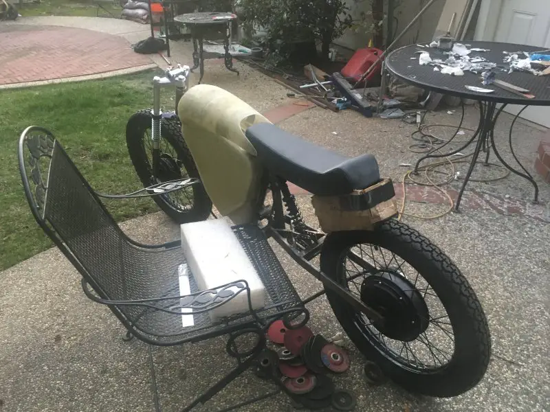

1980 schwinn slowly coming together.
Looks promising to me. Has lots of room for a big battery. I like a big honking hubby, with power like a V8. No shifting, no clutch, just twist the throttle and feel the juice.
Looks promising to me. Looks like lots of room for a battery. I like a big honking hubby motor, with power like a V8.
Yesss!! My cells are rated for 25c for 1min, at 74v24ah you can do the math... will be pulling much less.
Gonna use a quick release bolt on low shock mount to play around with settings when I get er running
She needs a date with mr flap wheel :D

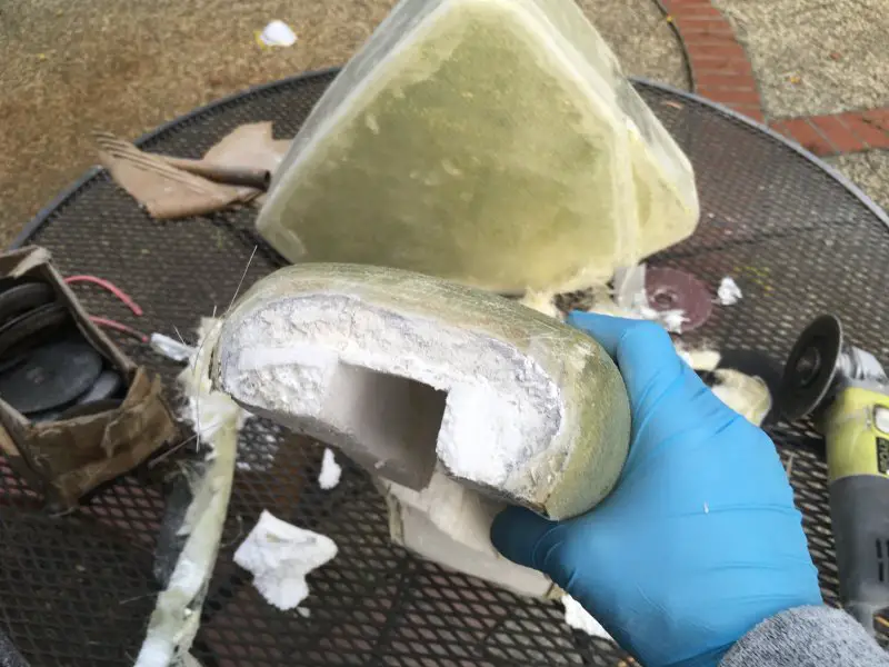

That's a nice cover over the main frame. Did you make that? I can tell you're putting your heart into it.
Thank you. It is fiberglass over foam core. I stuck together 1.5 and .75” white foam sheets, cut to rough shape with heat, sanded smooth, covered with aluminum foil, then glassed over currently with 2layers mat and one weave, but it’s not done yet. Been really darn busy!! And weather needs to be 65+ to ensure a good cure. If I were to do this again I would get my foam CNC cut before glassing.
