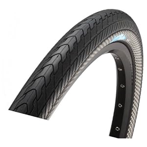

I found Duro Easy Ride Tires beat the liners hands down. The polyethylene liner is inside the tire itself and it's a solid band. It also serves to keep the tire from expanding out. Very smooth tread, a city bike tire. In addition the sidewalls are called "FlakJacket". Very tough woven nylon product to prevent sidewall cuts. And it's reflectorized to boot :)

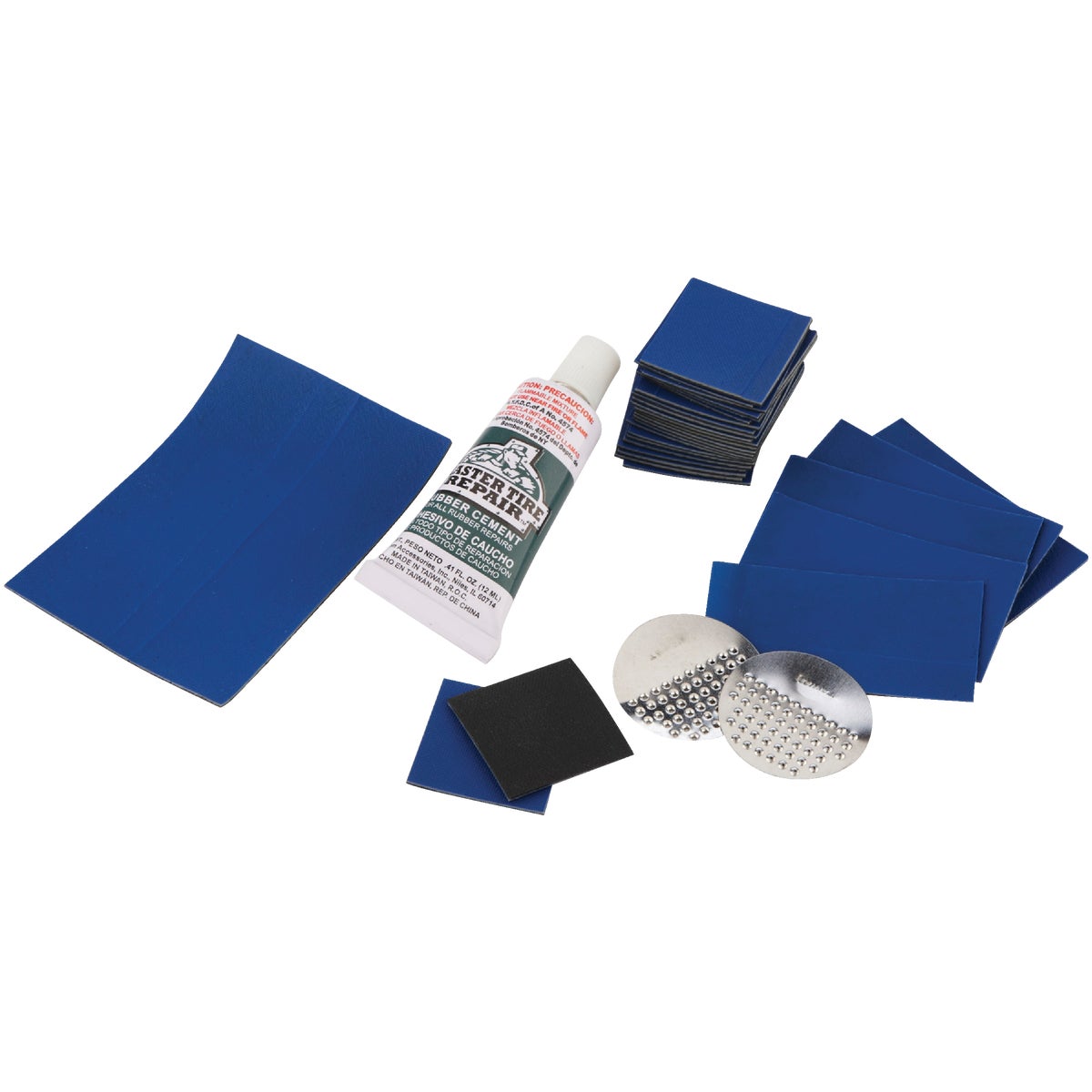

Now that you're talking about flats ,,,I went to my bike shop and asked for a patch kit he came back with a little box no bigger than a match box!!!I said wheres the glue ??? he said don't use glue any more use these like a band aid ????cost me 6.00 dollars!!!! still haven't used any of them????
Lol. That is why i don't use bike shops much for anything. Glueless patches suck. I've had better luck with electrical tape. haha.
Look on Amazon if you want the fancy little box and smooth-edged ready patches and little tube of glue, 3.50 a box or less.
http://www.canaltire.com/shopping/images/PRODUCT/medium/91274.jpg
I rather get stuff like this: (economy rubber patch kit, $4-10) from auto parts/hardware

http://www.ebay.com/itm/Rubber-Patc...-Kit-New-cycling-/250744634541#ht_1916wt_1140 $11 shipped USA, 48 patches with smooth edges!
and just do them all at home while I watch a show on the internet.
PS a cigarette lighter and a sharp pocketknife or sandpaper will do wonders! DON'T burn the glue. Just scrape or sand the area (no seams!), poke the hole so some glue gets in there (no bubble!), heat the tube and dry it well, then add the dash of glue and swab it out with your finger. It will dry smooth and the patch will hold well.
