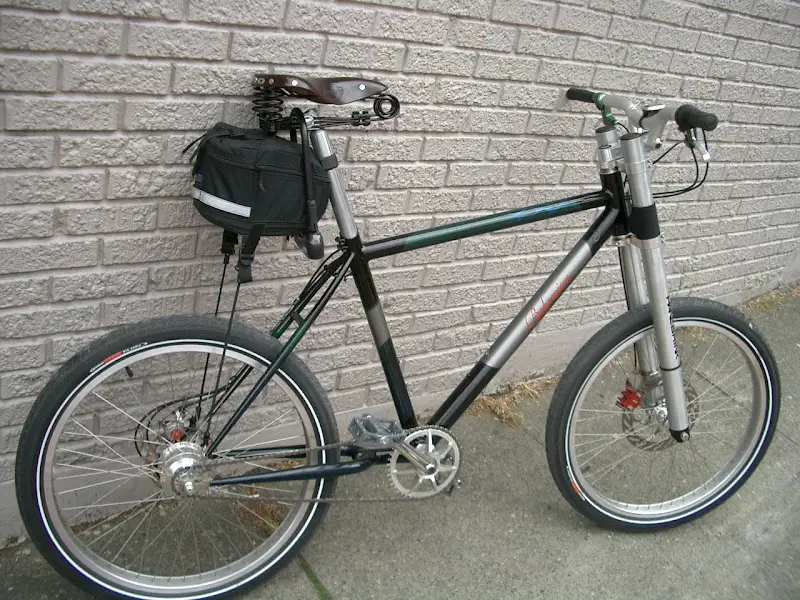

I run down hill competition tires with steel beads in them when I can find them. My touring bikes are all full sus mountain bikes. Done with touring sprockets. Very small cassettes in the rear. I only run 52 tooth in the front regardless of the wind or a hill. I am 6 foot tall and run 180mm cranks. My full sus bike frames are rare too. I have to find a compilation that meets my height.Cranks too far under me etc. Last triple tree forks reflect that as well. Much like these.http://www.downcycles.com/store/2010-rock-shox-boxxer-race-p-1189.html. or these http://motorbicycling.com/f3/my-latest-craigslist-score-22674.html.
These bikes are my gutter kings. All the gutters a city can offer.:) Pure peddle pleasure
Now you are prolly asking why not run something like a Lance Armstrong approach[real touring bike]. That is a prolly a good question. Here is why I need the work out. I cannot get one on anything less. I don't want to have to ride more than 30 miles to get a work out. I need the heavier bike to slow me down too.[traffic]This is how I road in Austin as well. I like to take the work out where most hearts will fail and keep it there. I always road in work slacks or jeans. [commando] With a special gel seat recipe I have yet to see any thing like it.
When I first arrived in Austin I had Continental tires 26x2.3 slicks that are every bit what you are describing. I had no Idea how slick it got out there after it rains. I slid through an intersection in the worst way possible. I avoided a pot hole the bike came smooth out from under me. The intersection at 1 day Paint and Body on Lamar blvd. I had road over every kind of ice and snow in N.M. Never saw it that slick before.
I soon found myself on trips to work in the morning when I was just gingerly peddling around a neighborhood corner. Say 10 miles an hour tops the whole bike front and rear tire would try to drift out from under me. [morning dew]
I saw folks that could not get there cars in the driveway after it rained. Too steep no traction.
After that the rest is history I hate rough riding 26x1.75 tires. I consistently run 26x2.7 tires on 30 miles bike rides [peddling] with style and ease now.
Tires like this are on my peddle bikes and are my favorite. 26x55/60 Wtb Moto Raptor Race Folding Mountain Tire 57283 at Cambriabike
The trade off is perfect. They flex and grab the road like a tire should. I would run bigger if I could find them in this tread design. Why I have not gone down since Austin.
Folks with engines on bikes should consider the trade off of a rough riding tire that can let go of the road. Regardless of what tubes they used. These are different animals than a peddle bike. I know that many frames will not accommodate a tire of my magnitude, but they sure improve a ride. Shoot guy's the motor is doing all the work who cares.

I understand the benefits of big tires-- I usually use just about the biggest tire that will fit in any given frame, unless there is another limiting factor (like rim width). So my skinniest tires are 700x32, but my fattest ones are quite big. On my mountain bike, I use Kenda Kraze 26 x 3.0" slicks:
These do a fine job off road, but they are awesome on the street. I weigh about 330 pounds, but I can still run these tires at 16-18 psi when I want to. The drawback is that they are thick-treaded and slow as street tires go. But they are so cushy I can't resist them. I don't think these tires are available anymore, or at least I can no longer find them. When I have to change them out, my consolation will be the tires I was using before: Schwalbe Big Apple 26 x 2.35" slicks. These are faster, but less high and mighty.
Neither the Kenda Kraze nor the Schwalbe Big Apple has been particularly susceptible to flats, although I do recall having had at least one flat in each kind of tire on my mountain bike. On another one of my bikes equipped with Big Apples, I hit something in the road that tore a coin-sized chunk of rubber away from the tire, but was deflected by the Kevlar belt without breaching the casing. I simply glued the flap of tread back down, and it has been working well ever since.
Even though both these tires seem tough and streetworthy, I don't expect that either of them would put up a worthy fight against New Mexican goatheads. The Kenda would do a bit better, just because it has more rubber on the tread.
The owner of the bike shop where I work uses Kenda Nevegals (the 120 threads per inch "Lite DTC" kind) on his MTB. His are probably the thinnest-walled and most supple knobbies I have ever seen. The tread pattern seems to make good sense, too.
Chalo
Yeah I liked the thick walled slicks on the road and the sand it self. They don't flex enough for me to hold the road in my taste. I like softer walled tires and the all terrain approach . Those slick roads in Austin changed my outlook. I like the rubber to give enough to grab the road. Thinner walled tires with flex too them may have kept me alive. I have not dumped a bike since Austin.
I like the tread part of the tire to give under my thumb and still be able to run the tire at about 40 psi. That's when they are playful to me. The road just reads back better to my handling. Slicks are too stiff at the tread to me softening the tires did not give me the response I was looking for.
