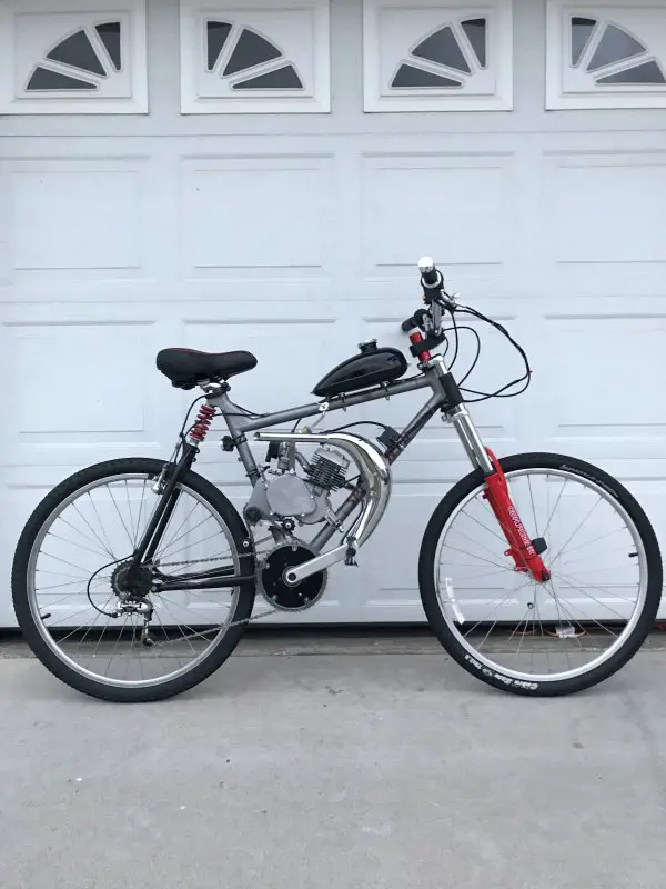

This is my 1996 Specialized Ground Control. Is has a Zeda 80cc two stroke engine with a Sick Bike Parts shift kit. I know that there is limited info on here about full suspension motorized bikes but I plan on making a YouTube video this week like a walk around, parts list and starting it up and riding it. Stay tuned

This is my 1996 Specialized Ground Control. Is has a Zeda 80cc two stroke engine with a Sick Bike Parts shift kit. I know that there is limited info on here about full suspension motorized bikes but I plan on making a YouTube video this week like a walk around, parts list and starting it up and riding it. Stay tuned View attachment 106877
Here's something you may want to consider a 4 speed freewheel (34,28,22,16)
It'll greatly reduce the amount of cross chaining and space out the reductions between shifts.
