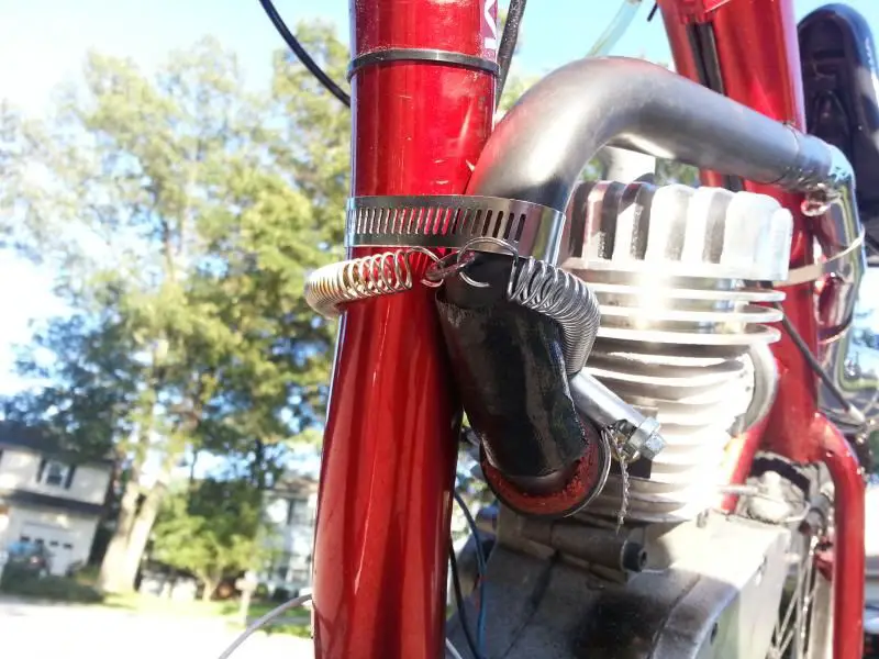

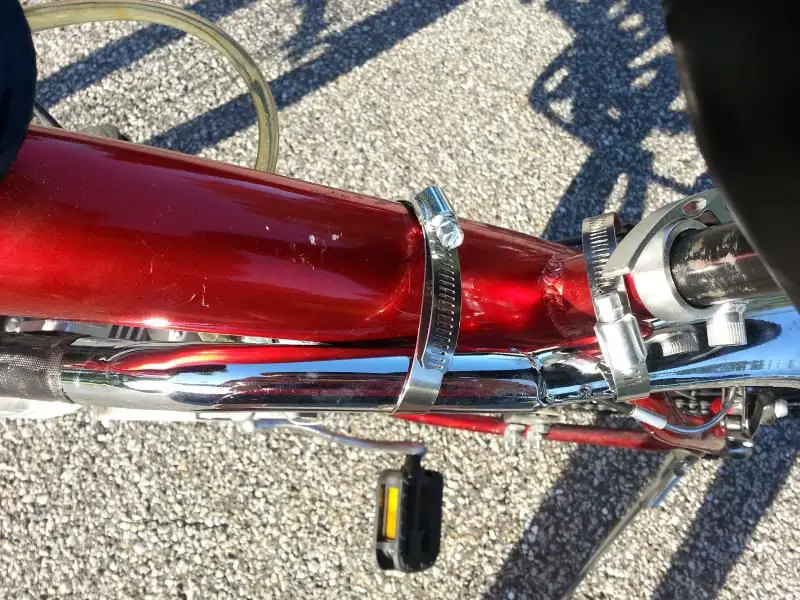

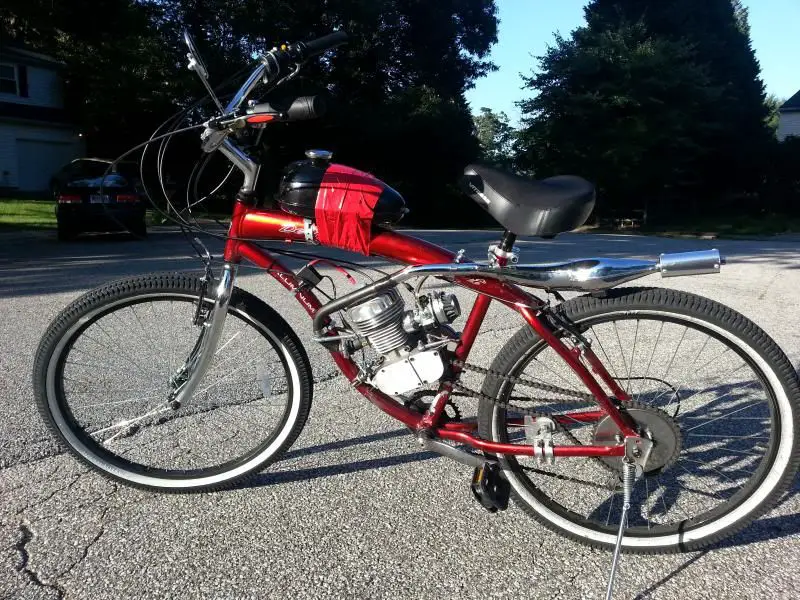

    So I finally had some time to take some pictures of the exhaust. The exhaust sits right up against the frame as you will see, but I don't know if this is safe to the point where it will not melt the frame or damage in any way while im riding, so if you have some experience with this let me know! haha Also I have to change out the rubber hose near the exhaust port to a longer one since this tiny thing came off creating a hole and an exhaust leak. Will fix tomorrow!

    I'm going to put a small piece of silicone pipe (approx 1" long) around the frame where the exhaust clamps on the frame and see how it works. Doing it for heat against frame and vibration.

    thats a nice mount! i had to improvise but i do like the chrome exhaust over the black after having it on the bike. Bad thing is since mine rubs against the frame, it rubbed or melted it a bit. i put silicone hose i had leftover n put it between the frame n exhaust

    When you need to replace your silicone tubing and you will because it melts fast especially the hardy a clamp it the faster it melts . you can see what I'm about to tell you in my photo albums so feel free to take a look it was my remedy to a problem of throwing money away on a useless product from sick bike parts the pipe is great the silicone tubing not good for me anyway. Take some beers cans and cut the ends of it squared up a cut it into 1 3/4" strips , now wrap joint with 3or4 strips and hose clamp it . No more silicone tubing and its the closes you can get to welding up your pipe set-up.
