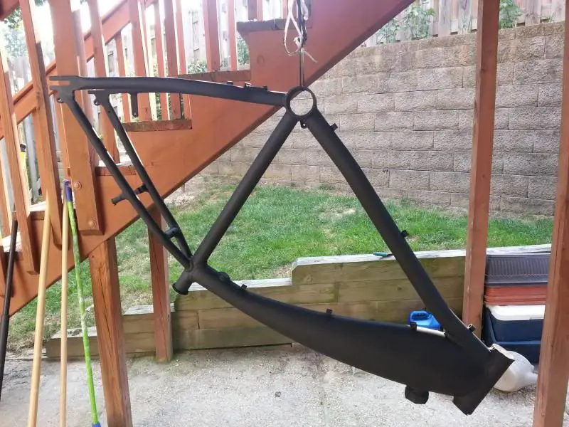

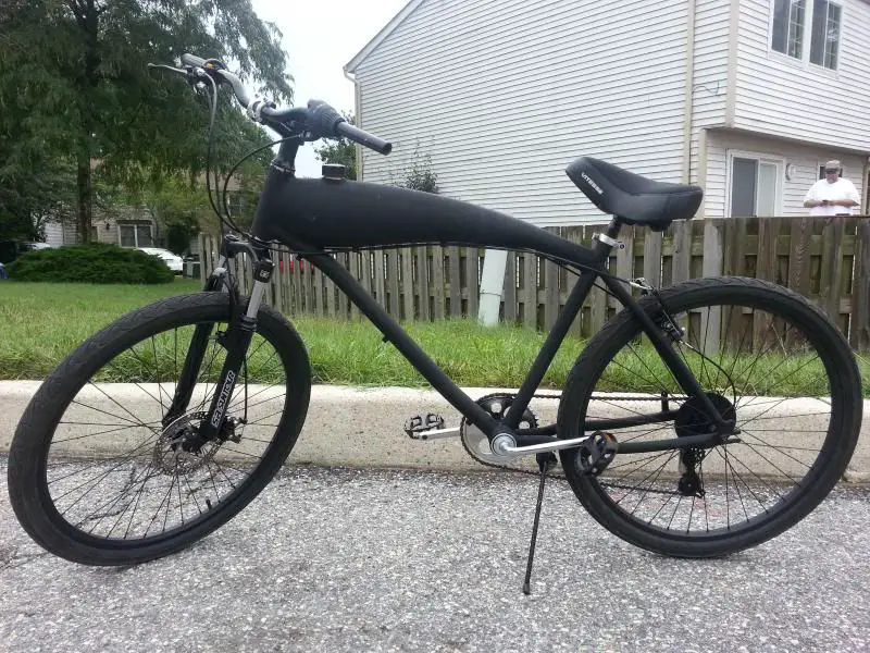

I was finally able to build the new bicycle with a new frame, forks, brake system and handle bars. I had 3 other spare bikes that I had laying around so I took off certain parts to build this bike except the frame and forks. Painted the frame flat black to include the rear wheel and changed the tires to road tires I had. I will def post up pics soon of the new bike. Today I will try to get the motor setup on the bike and hopefully to be riding again this week. Waited 3 weeks for this lol

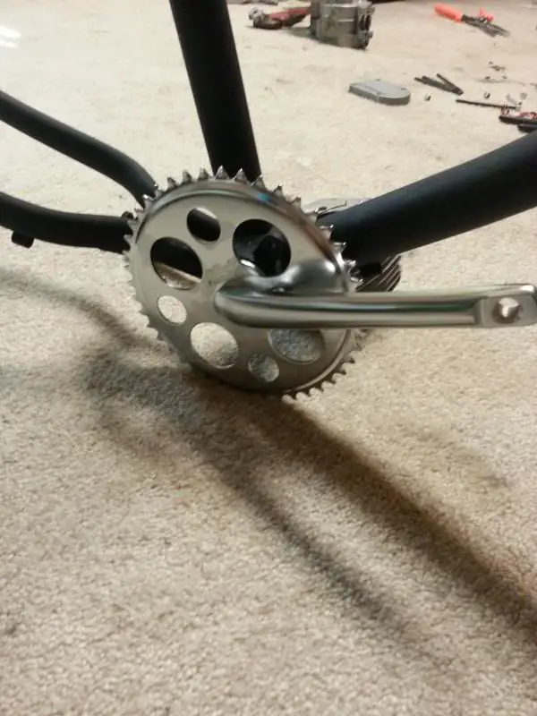

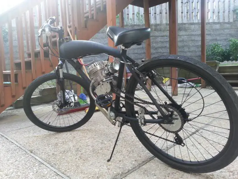

Finally got the bike up and running today for some testing and boy was it fun. 36 tooth sprocket really doesnt feel much difference when starting the bike, might consider going to a 30 tooth or a 32 tooth in the future. Havent tested for high speed since im chicken at the moment considering i built the bike myself but needs a feel adjustments. Also my chain seems to be a lil loser than my other spare bike which i dont like but i cant do anything about it. The fuel line with the fuel lever touches the top of my air filter so i cant adjust the motor up anymore and taking off another link would result in a super tight chain and wouldnt beable to get the master clip on there. its not super loose since it hasnt jumped the sprocket in the back but it is in the back of my mind. Been busy so i havent been able to post some pictures but i will try to upload tonight when i get home from work. RIDE ON!

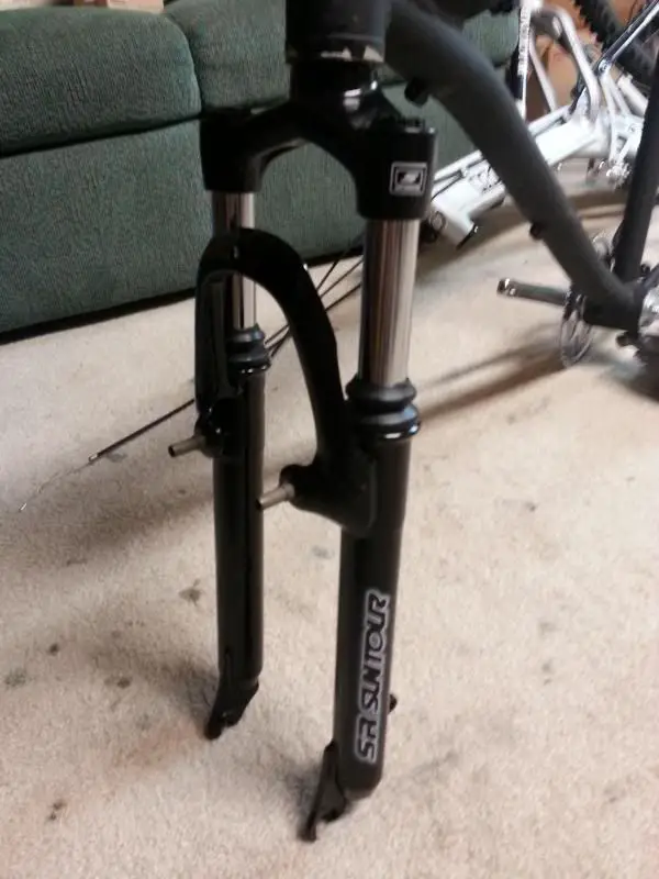

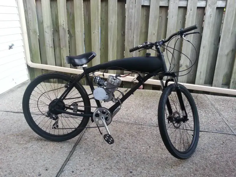

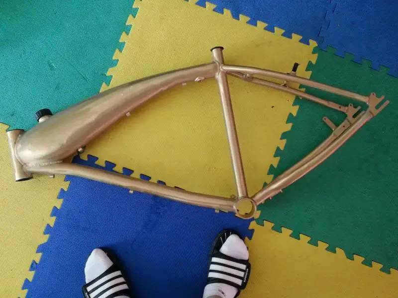

Sorry about the wait for anyone looking to see what I've built :D Using the GT2a-s frame which I was VERY excited when it arrived along with my suntour front shock forks. The bike isn't completed just yet, want to change out the tire color and the seat color for a better look, but that will come in the future. The frame needs to be re painted in my opinion, but too lazy to re do it again so Im perfectly fine with the way it is till it bothers me. Onto the pics!
Now earlier today I did run into a problem. Since my motor sits so high due to the sick bike parts motor mount my fuel line was curving and not allowing gravity to take place and push the fuel into the carb. This caused my motor to completely shut down on me which totally sucked. It's hard to see in the picture but the clearance is just so small... I can take another picture tomorrow and post it up. I ended up cutting the fuel line to make it as short as possible to allow gravity to take its place. Then after my 23 mile ride earlier as I was coming home the bike shut off again due to the same problem with the shorter fuel line so when I got home I smushed the air filter as much as possible as a pancake and tried to bend in the metal outer part to give it more way. Hopefully it will work with no problems tomorrow when I take it back out. I also do want to change the petcock to the gold one since that is also shorter which would help in my situation. RIDE ON!
Nice looking bike, your biggest speed killer in my opinion is the stock exhaust pipe you're using, I don't care if it has a hole in it or not it still take lots of power away from these engines, biggest power and speed robbing thing you can have on one of these HT engines in my experience, my oldest bike had a free flowing exhaust I had made up on it and it cruised really nice at 30mph, I took that exhaust off and put a stock pipe on it that was completely wide open inside, NO cat junk in it at all just open chamber and the cruise speed dropped 5mph instantly on this bike and the low end power fell of dramatically, stock pipes suck all the way around in my opinion, put a SBP expansion pipe or one of the JNMotors expansion pipes or something that you can match port the exhaust flange to the engine with that isn't so restrictive and you will see a big difference in power and I'll bet you'll see a few mph top speed increase also, I did on all mine when I got away from the stock pipes.
