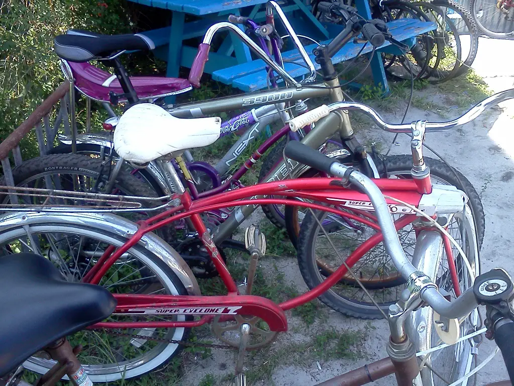

Hey Xen,
Question - Does your 40 y/o schwinn happen to have those tiny tubes? I'm looking at a classic that has tiny tubes and it worries me although it's a steel frame. Any input?

Well, it's not a cruiser-style. It's a road bike. So yes, it has tiny tubes-- on wheels and frame-- and like I said, it's still great. The frame tubes seem even smaller than the tubes on that cruiser... of course, thickness is important too. =)

Whats a good wall thickness? My only way of gauging such a thing is checking the seat tube.
would that be for a plain steel frame cromolly or aluminum, titanium or carbon fiber?? as each will be different as the strength of materials is different
i honestly wouldnt know. i bought my bike at walmart cause it was cheap, had it two years with no issues so far. an older steel frame would probably have thicker walls than the department store bikes.
A lot of people here like the felts. if i had a choice between a felt and a columbia, i would take the columbia. easy way to tell if your frame is aluminum: get a magnet. aluminum wont attract a magnet. my frame attracts a magnet. my engine doesnt.

The Felt's aluminum.(^) I ended up with the both. Pretty sure the ol' school is a steel frame. Why'd you choose Colombia? I like em both for different reasons.
It is clear, what I'm prefering.
The most expensive frame need not to be the best. High strength materials are often brittle. Chromium and manganese or vanadin are expensive elements and not used very often. High strength is often bought with carbon. Then the steel is not weldable.
The producers think of the cyclists, not to us, people who build engines in their frames.
My bicycle frames are designed for use with engines from factory. 1.05% chrome, 0.7% manganese, 0,25% molybdenum. SAE No. 4130, in Europe known as 25CrMo4. No WalMart quality. And probably durable beyond one's own death.

For one, I would never motorize an aluminum frame. There are members here who have done it and have not had any problems, but I'm 6 ft 2 and weigh 280 lbs, and I'm not taking the risk. Also, the Columbia is old steel, probably american, and far more likely to hold up to the stresses of motorization than an aluminum frame.
