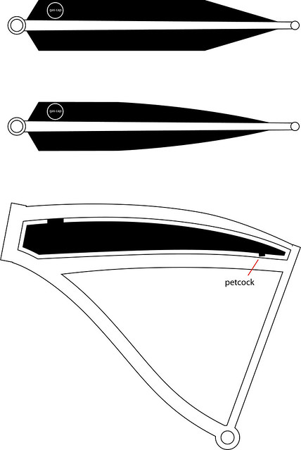

I'm in the middle of designing and figuring out my custom tank. I'm trying to figure out what to do for filler neck and cap. What are some ways you guys have solved this? One option is to buy another kit tank to cut the stock filler neck.

I got mine at Speedway also. No problems either. Does your bike frame actually set that way? The petcock will work there if it does set like that. If it sets like a normal bike you have the petcock in the wrong end. Just curious.

You are going to want to put the filler and petcock on the same side of the tank so you can fit it through the frame. That was a time consuming mistake I made.

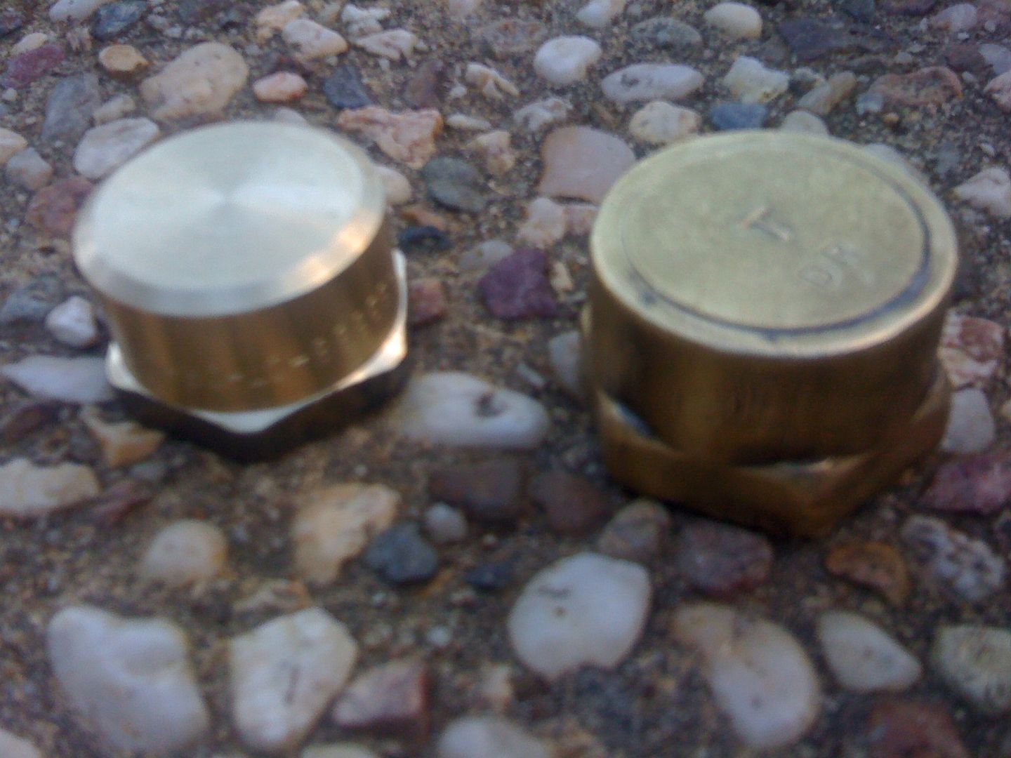

I found some pipe, tapped a thread on it. And bought a brass endcap from a plumbing suppliers. Total cost around $5. IMO the endcap looks very vintage and as good, if not better then some of the caps ive seen for ten times that amount.....

Harry, how did you vent your cap? Guess a small hole in the top would do it.
Love the look and it's a smaller diameter, which is good for my design.

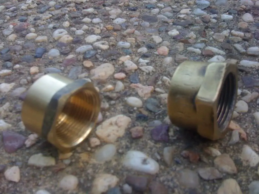

I used to use a 3/4" copper plumbing threaded male end soldered into the tank along with a brass hose cap. Now I prefer using a brass hose coupler, grind down the threads on the lower portion, solder it into the tank and use the brass hose cap. Drill a small hole in the cap for venting the tank and you're good to go for around eight bucks. I like brass. Looks good.

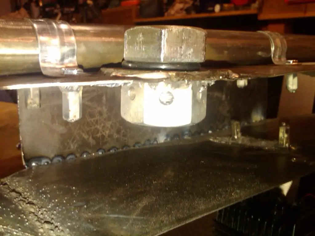

1" 7/8" Nut and Bolt with O-ring from Hardware store. They are gas resistant. Had it over a year and it is as good as new. I drilled a hole down the center and soldered in a coiled copper line for a breather. Works great.
