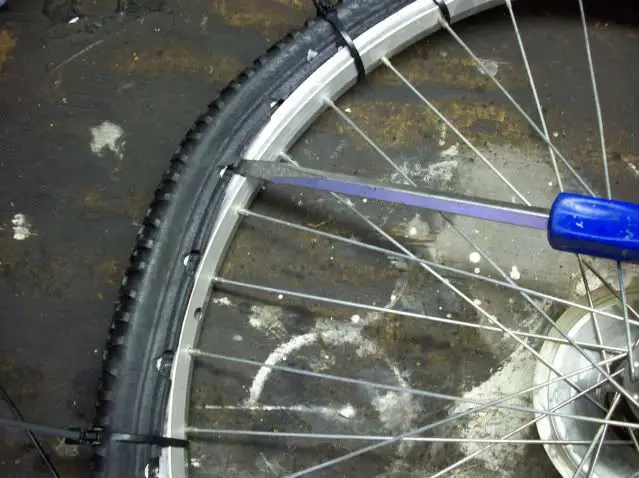

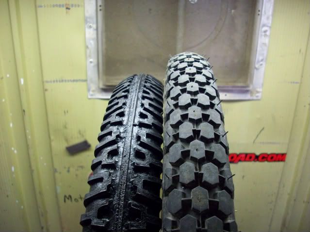

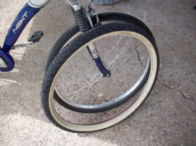

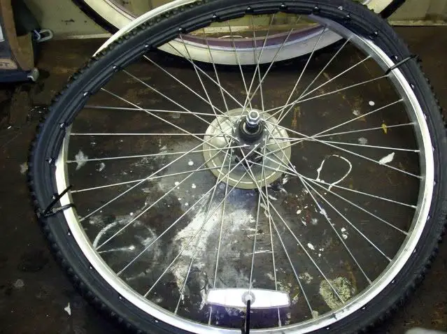

Replacing Kedna 26X2.225 whitewalls with NMF 26X2.00

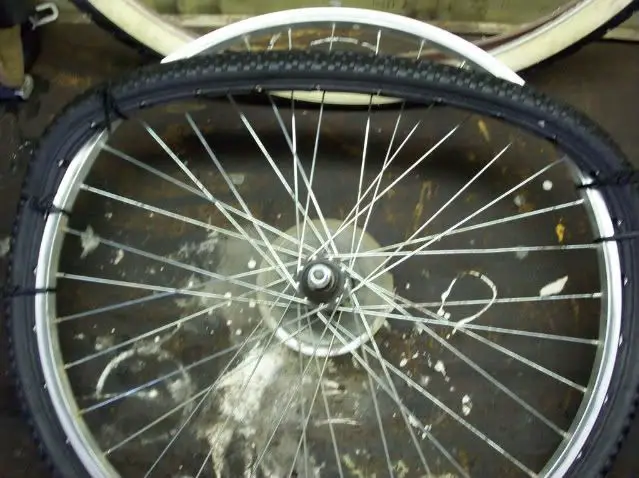

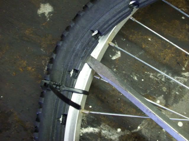

The first thing I do is use one zip tie to get started...

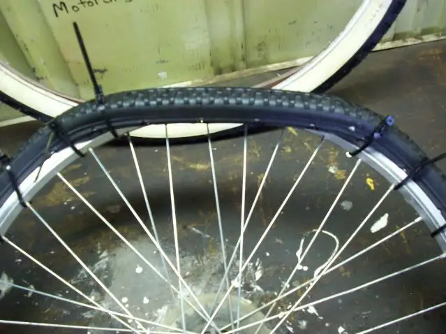

Then just with my hands I mount tire as far as possible then zip tie...

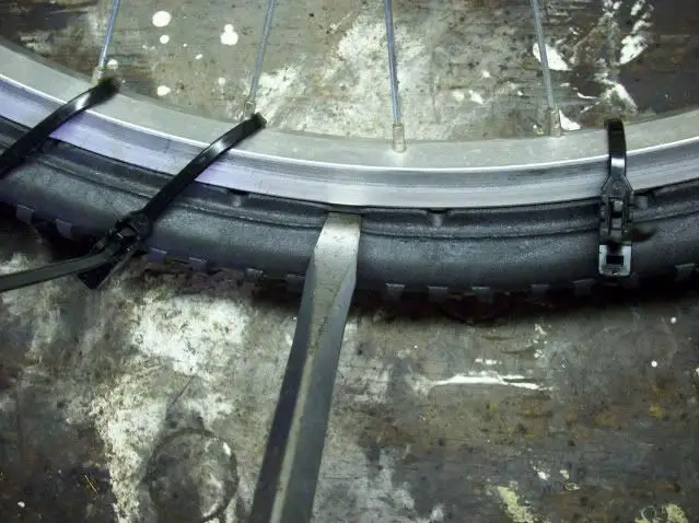

Now I use a screwdriver to start to pry the tire on...It's real easy now, it will get harder and harder

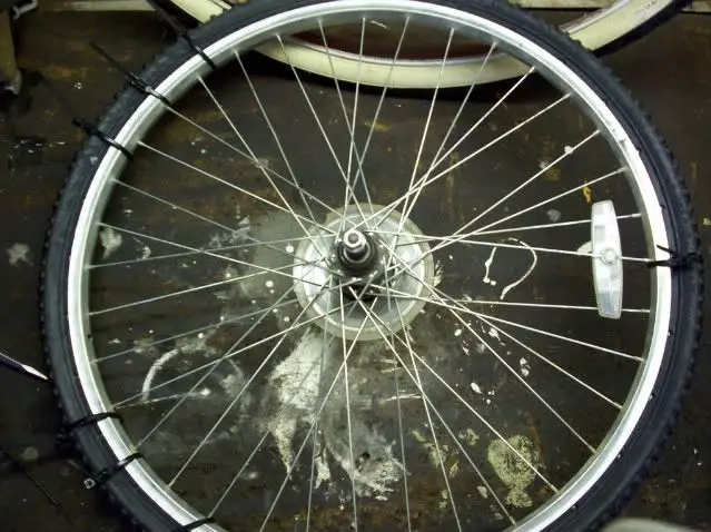

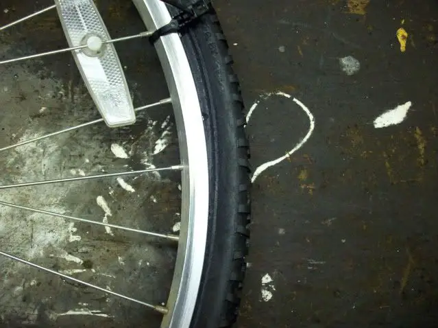

The closer the tire get's...the harder it will be. And the more zip ties you will need.
You need to be careful! You want to pry hard enough to mount the tire. But not so hard you damage or bend the wheel.
Almost on...one more pry.

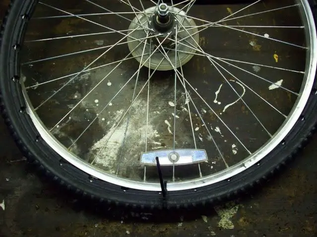

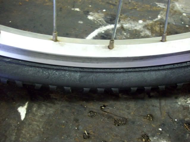

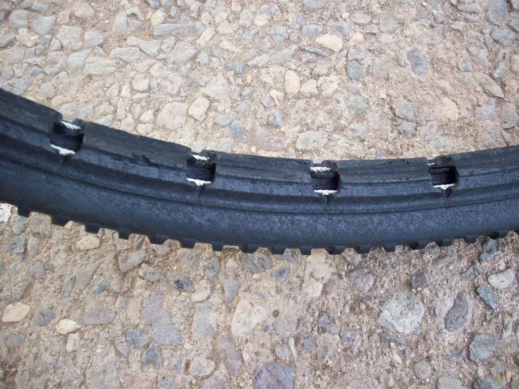

Now the tire is on the wheel...we have to get the sidewall to pop in.
Now I use the screwdriver to push the sidewall into the wheel. Do this on both side's and all the way around...
The sidewall is starting to go in...
This is what it should look like on both sides and all the way around when it is mounted right..

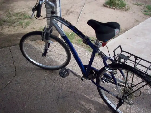

It rides okay and feels great....Now that I have both the tire's mounted. I think the funny feeling I was getting was going from the balloon tires to the NMF.
Because with both NMF it feels alot better. I have not had time to go on a long ride yet...will keep you posted on how it does.

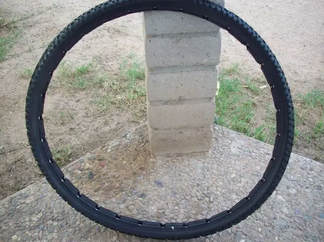

I find it much easier to mount the NMF tire then the NMF tube. The NMF tube took at least 15-20 minutes each tube. The tire took like 6 minutes each tire.

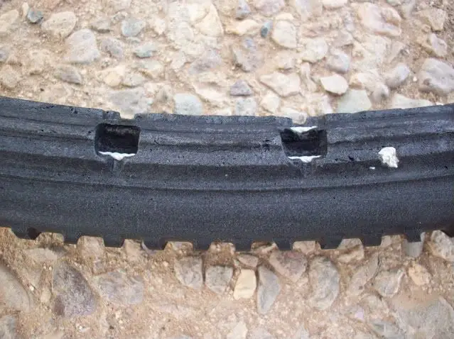

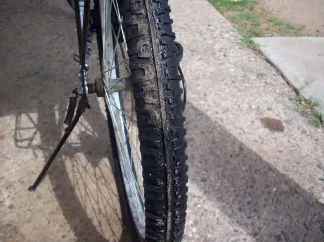

I had the day off today so I went for a 35 mile ride on my pedal bike this morning.
The NMF front tire now makes a squashing sound in one spot on the tire. I now also have some resistance in pedaling now. You can really notice it when trying to coast down hill.
And I took a fall in a parking lot making a sharp turn. The tire started to come off the wheel in one spot. Took a good look at it and it seems to be mounted fine :confused:
After today.....there is no way I would mount a NMF tire to my Motorized Bicycle..:(
