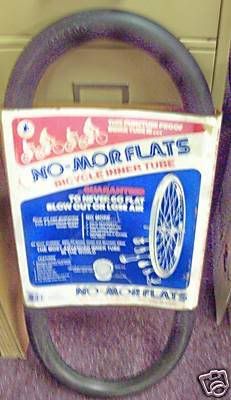

I finally found the flatless tubes I got at Walmart....I found this pic on E-bay...it's the very same brand

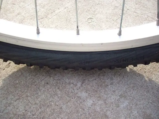

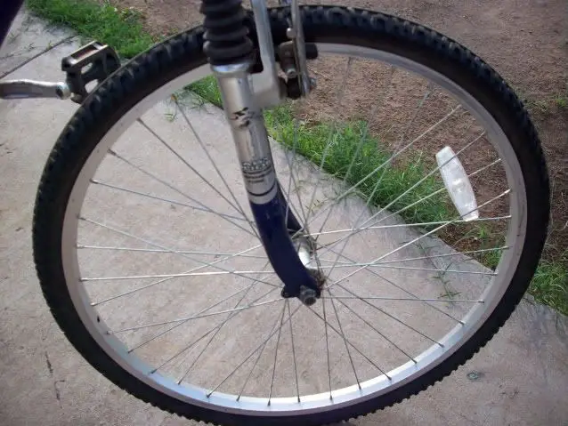

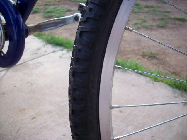

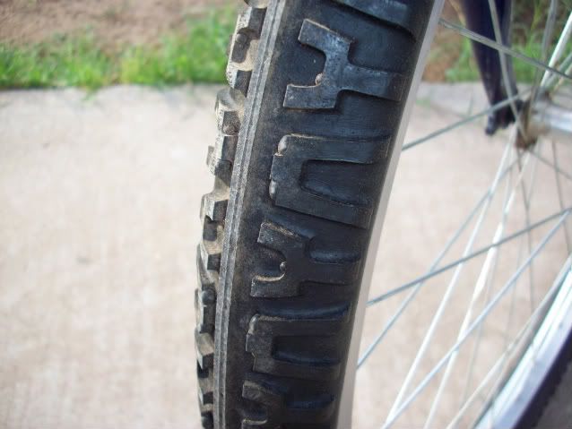

I have just bought some...I know some of you may not beleive it, but I got them at Ace Hardware. They only had one but paid for two and have the other on order and they will call when it get's there. They where $25.99...I'm going to mount them on one of my pedal bike's first and see how they do. I only have the front one mounted and so far I don't like the way it feel's. I'll give it some time and test them out before I decide to mount them on my MB or just buy two more for the MB. I'll do a update soon.
Oh...it wasn't too bad to mount, all I used was some re-usable zip ties (can use regular zip ties) a screwdriver and some dish soap.
I started to mount it on the wheel as much as I could with my hand. When trying to get the rest of the sidewall it would just pop off. So I started again just getting as much on by hand, then every I'd say five inches I would use a zip tie. I would use a screw driver to pry the tire on just a inch or so at a time...then add a zip tie so it would not pop off. I just did that till I had it on all they way.
After it was on...I laid it on the ground and used the screwdriver on the side of the sidewall and pushed down to get the sidewall to pop into the wheel. I did that all the way around then the other side. I would do one side then flip it over and do the other...which would also cause the other sidewall to pop out.. but just keep working it and it will go.

It feel's like it is flat when I ride it....after a few ride's it seem's to be getting better or I'm just getting used to it. Maybe it needs time to settle in?? I still have not got the rear tire, that may help but so far I guess it's okay...it could all be in my head rotfl
I hope I can remember to take pic's of the mounting this time.
Squirlly, not hard to pedal at all...it get's good traction it's just a diferent feelling then an air tire. I rode it today a little bit after work and it's getting better and better. I think it just need's to work itself in.
I wish it was more of a "street" tire. It does great in the dirt. But Ace did not have any other option's like the web site does. The rear tire should be in Friday. I will go for a long ride when I get it mounted...I'll keep you posted.
