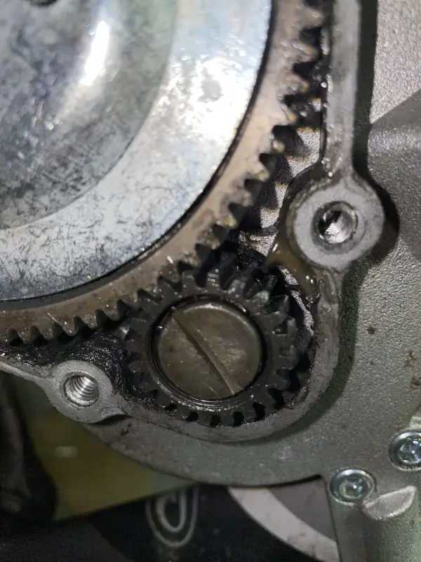

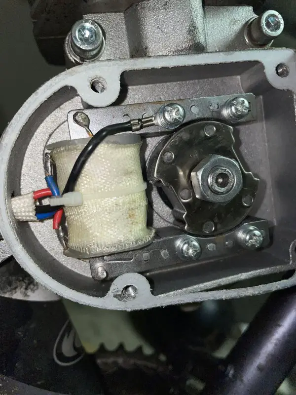

The crank seals are a place to check with the covers off and spray... Installed dry and probably not install all the way and not the best quality to begin with... The sealing surface of the crank and the fact it's not true wobbling around... A 2smoker uses the case to supply fuel so it's easy to over look that because if it's leaking air into the case it's not going to show a drip like a 4 stroke would with a bad seal and it doesn't effect the running either... Is where I would look next
Yes, that’s the seals to check. Remove each side cover and look for fuel leaking from the seal area, the thinner seal behind the magnet is the one that gives the most problems, I had one that kept popping out.
magneto seems very clean, but i don't know how to remove the other greasy one, i put the grease there before
