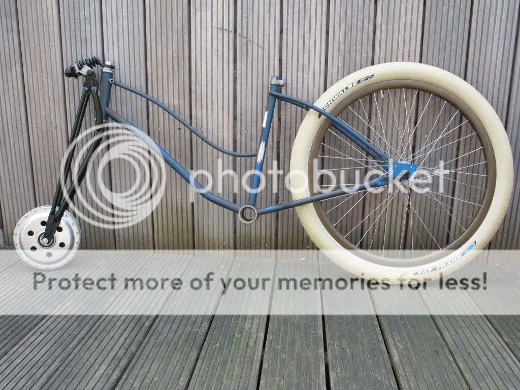

My bike started out as a Ross Girls frame. I added a Kreidler 160mm front brake and a standard springer fork.
The springer fork I bought didn't fit so I had to cut and weld the clamp.

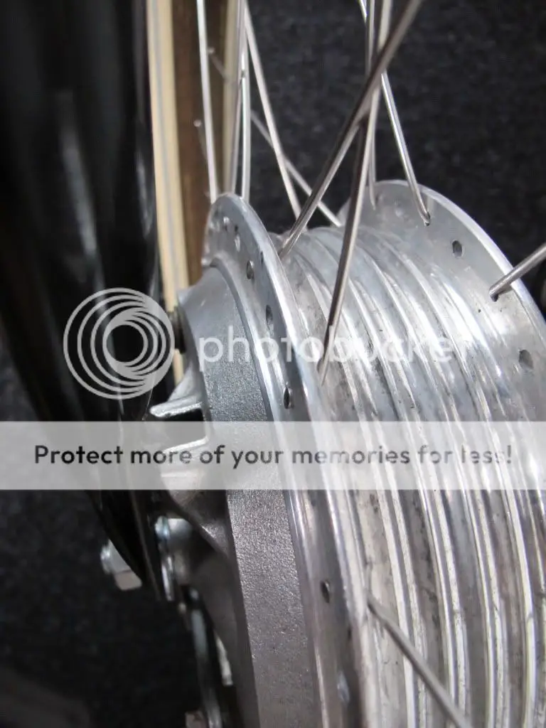

I drilled six holes in the hub to give it a sportier look. (I don't drive in the rain anyway)
Next I added a pair of wooden rims I bought in Italy. Laced the wheels myself for now with DT Swiss spokes. I'll have them laced later on after powdercoating and polishing. Had to drill new spokeholes in the hub. It originally belongs on a moped that uses thicker spokes.

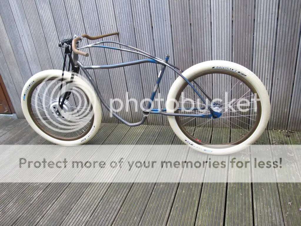

Now it's time to modify the frame. Starting with the top tubes.
Merdeka
Aug 2, 2010
10
the Netherlands

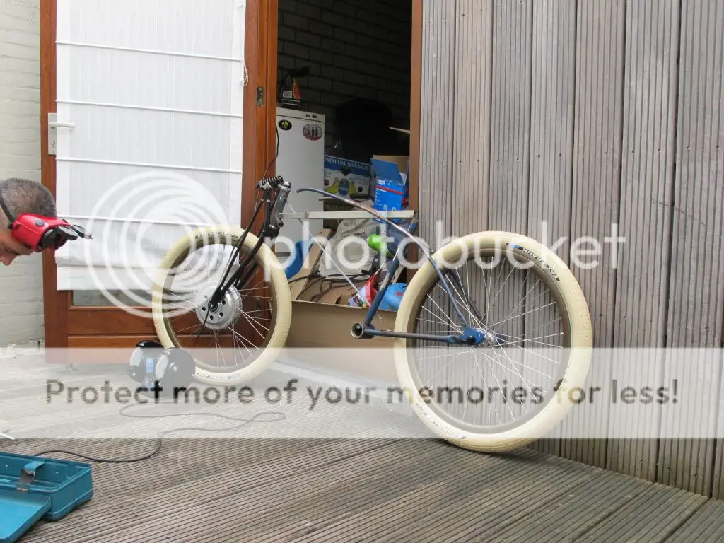

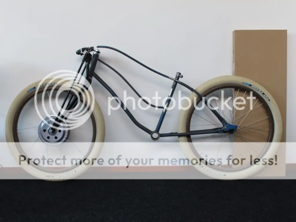

After welding them on they were to high so I heated them with a tourch and bend them down.

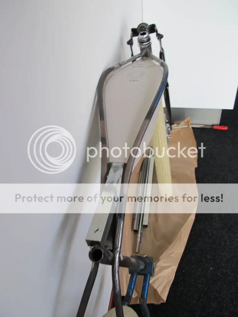

Now I extended the whole frame 8cm to get the low and long look I like.

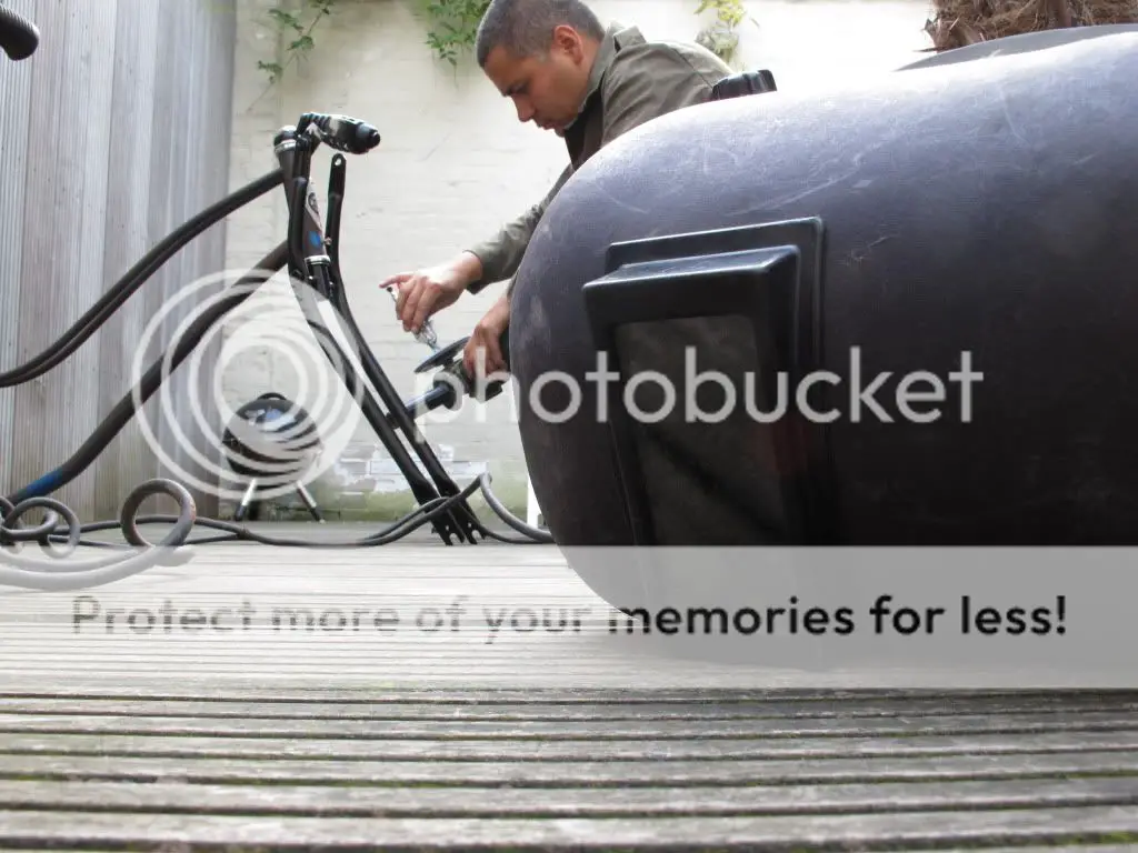

Next I made a mockup tank out of cardboard.

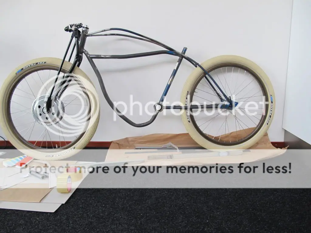

Then I extended the top tubes and re-used the old downtube. Bended a 26mm gaspipe for the new downtube. The bends are a bit rough but ok.

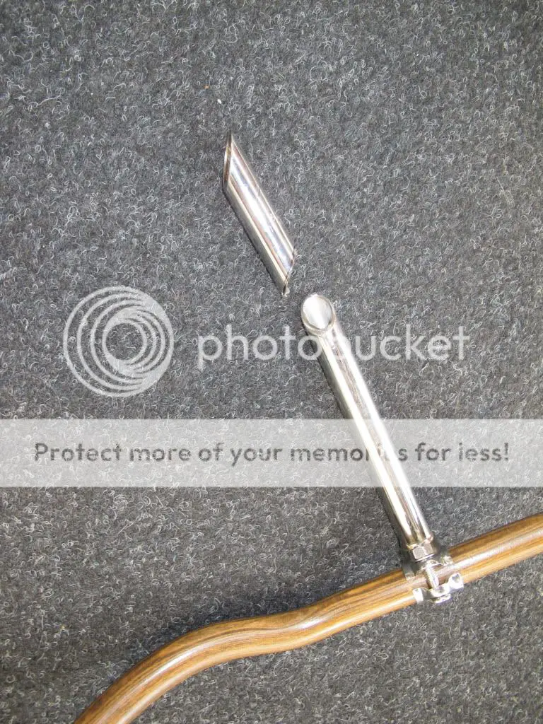

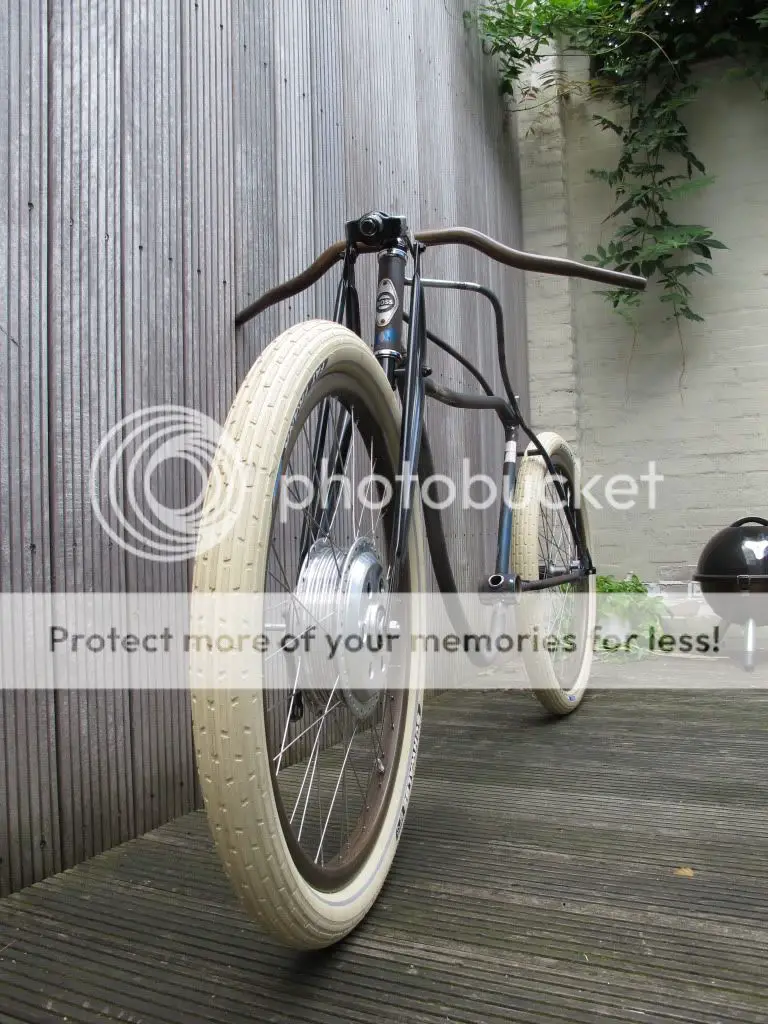

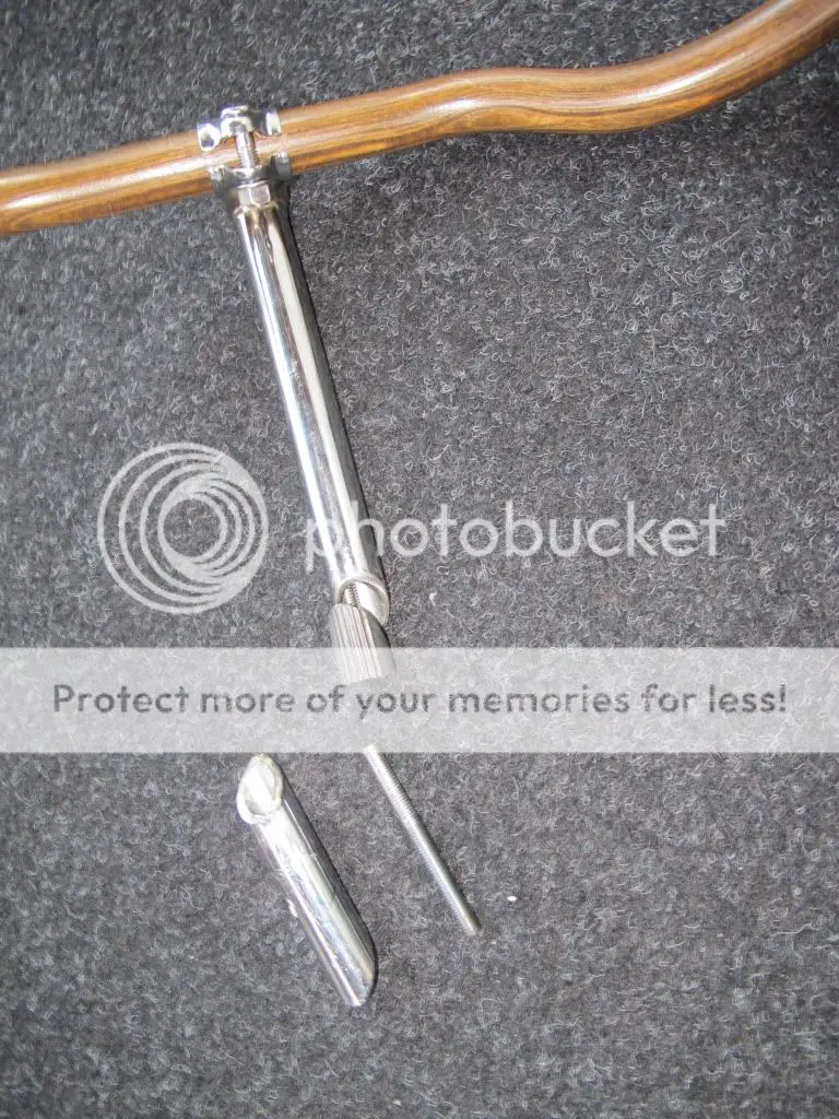

Finally my wooden handlebars came in from Italy. It was made to match the rims.
I had to shorten the stem and bolt to make the steering as low a possible.

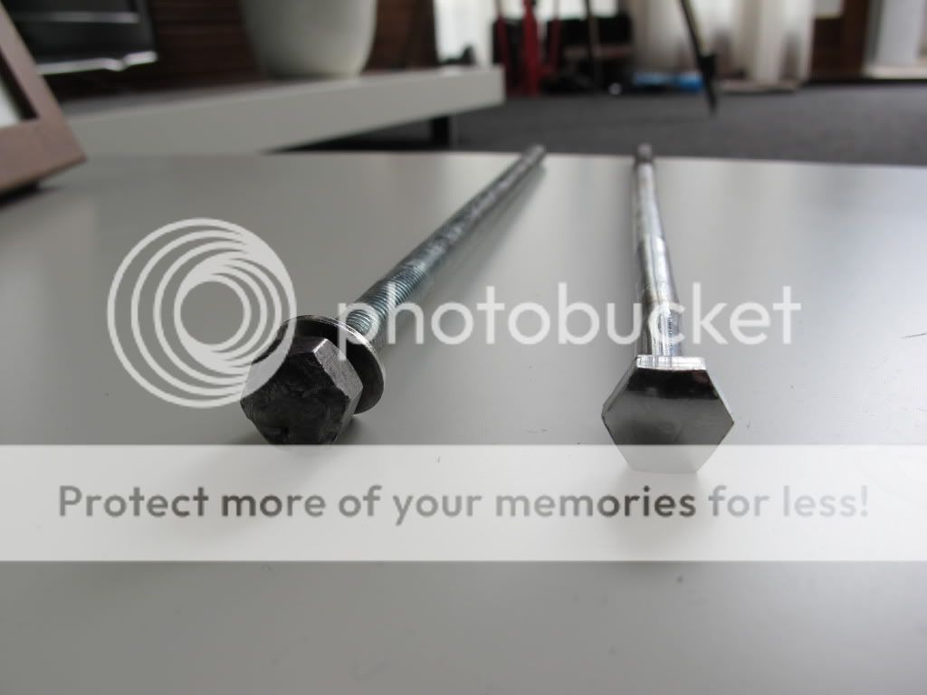

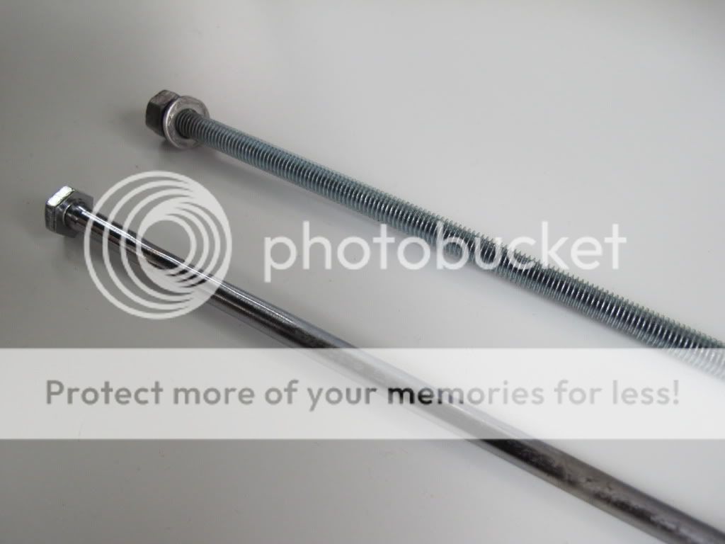

The bolt had to be rethreaded but that failed. The bolt wasn't thick enough and when tightening down the handlebar the new thread broke.
Merdeka
Aug 2, 2010
10
the Netherlands

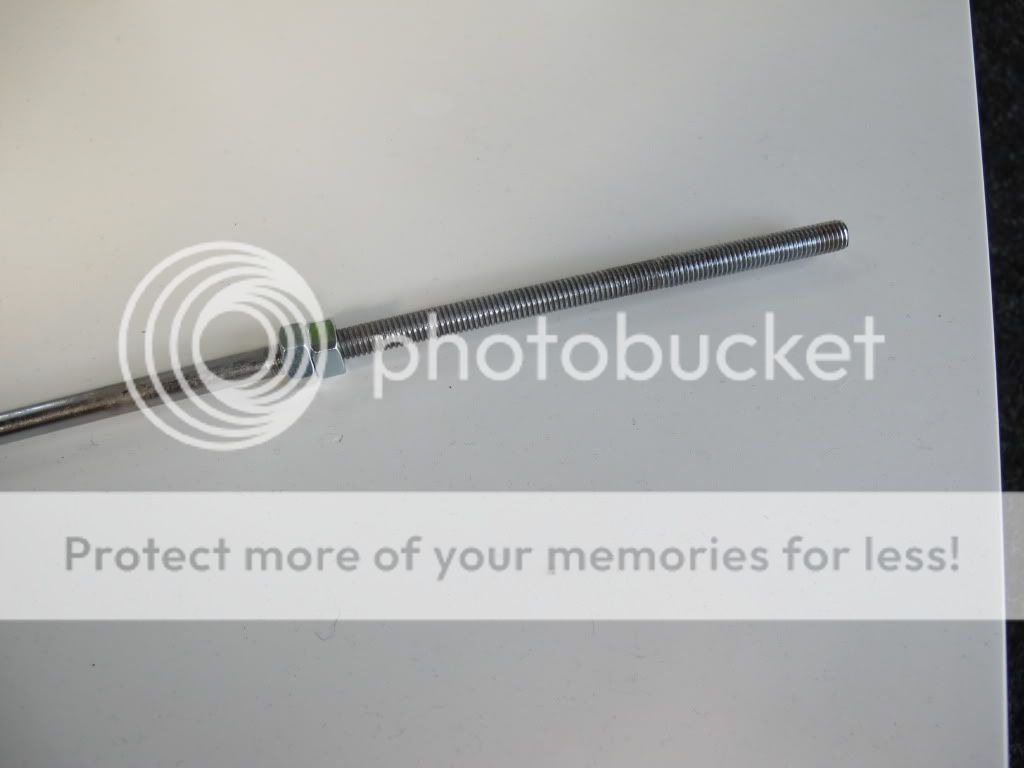

So I made a new bolt myself using M8 wirethread and a m8 nut. My welding is getting a little bit better. :)

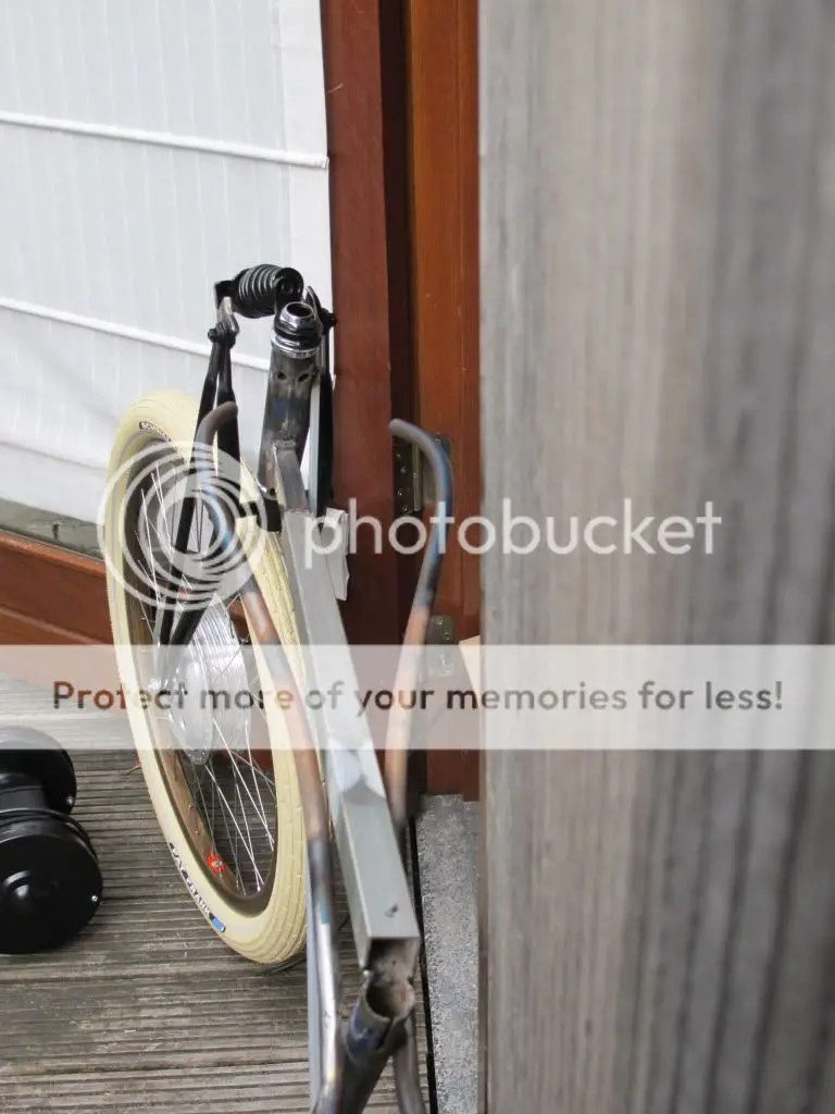

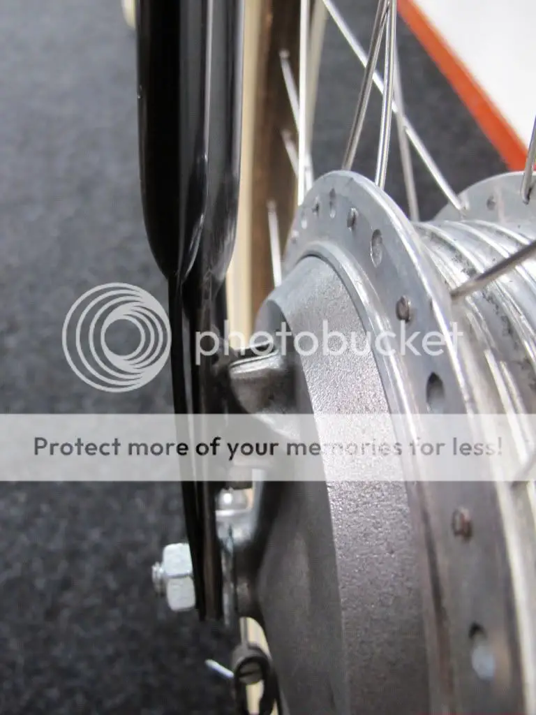

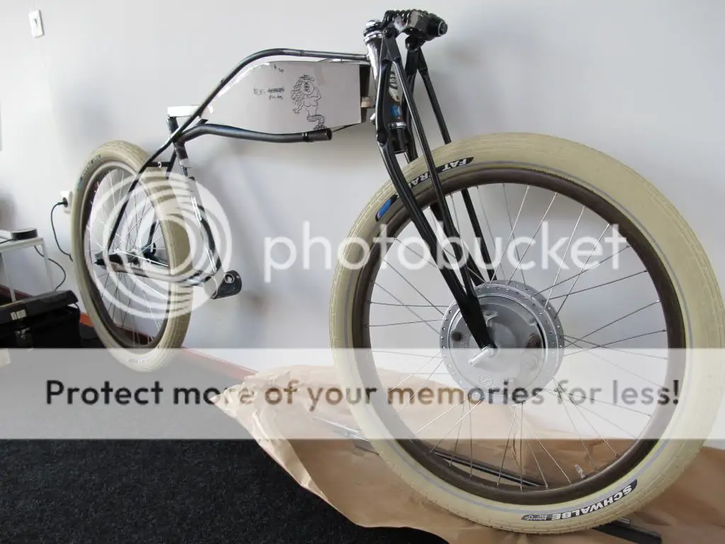

Ground down a piece of square iron and welded it to the springer fork. This holds the brake backingplate in place.

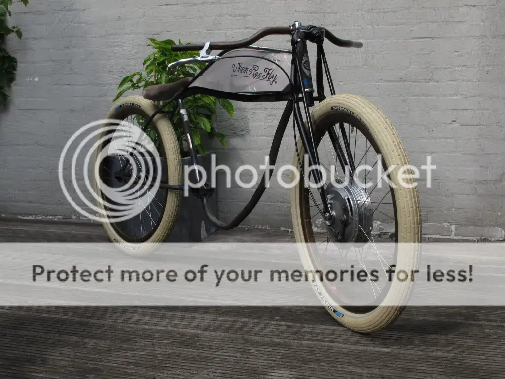

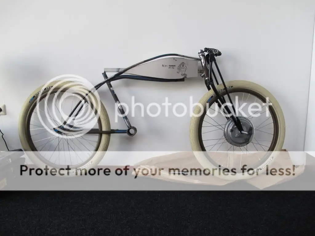

Made a new tank and temporarily fixed the front brake. Also made a horizontal seat stem.

Love the look of your bike! But I'm wonderin if the force on the head tube isnt going to just cause top tubes to bow out more n more.... Maybe a tube across the two? Wood bars are beautyful, and that big ole brake looks wayyyyy cool
