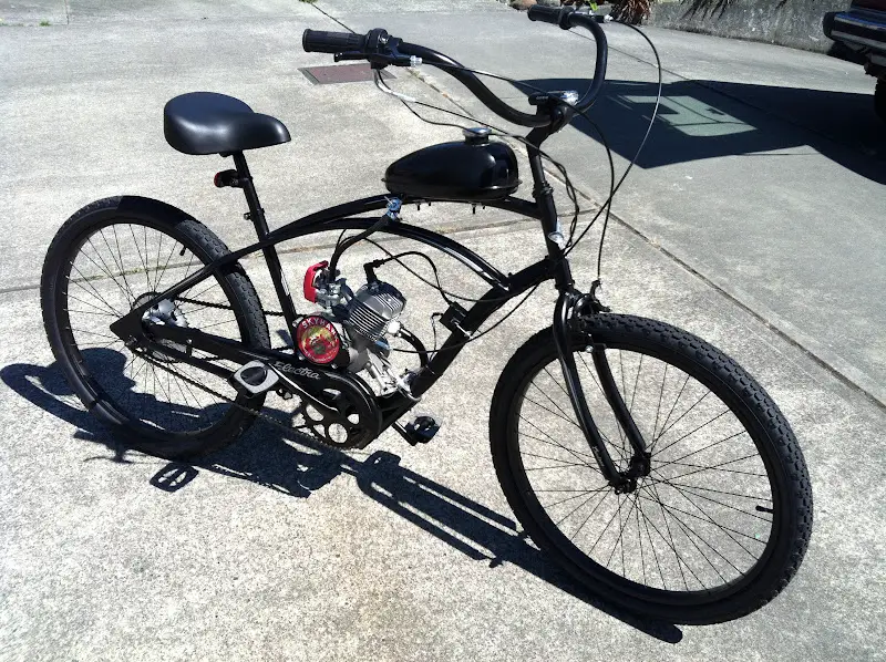

I've completed my first build and am thrilled with the results! I've not had this much fun since I started riding motorcycles 10 years ago.

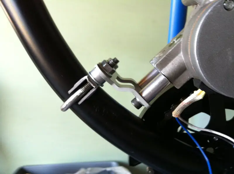

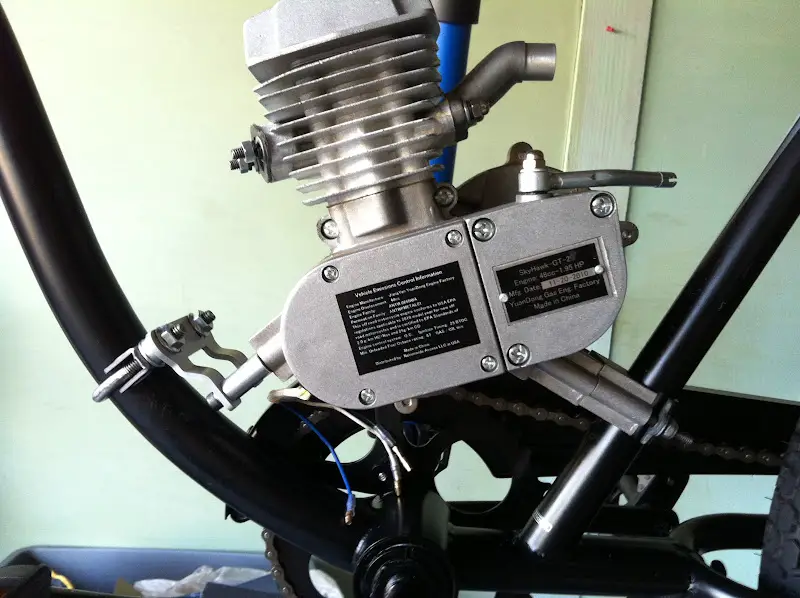

A bit about the project--the goal was to keep it simple, relatively inexpensive, nothing fancy out of the gate. I did start with a new bicycle, an Electra Cruiser that I bought from REI for about $200. I wanted a steel frame, single-speed, comfortable, fun-to-ride bicycle and the Cruiser fit the bill perfectly. The motor is the ubiquitous Grubee Skyhawk 48cc with the CNS carburetor. The first challenge was to get the motor mounted in the slightly stretched frame. For the front mount I put together a mount from Sick Bike Parts and some aluminum spacers with longer bolts (see pictures below). For the rear mount I used the parts that came with the engine kit. I fooled around with the rag joint for hours before discovering the Manic Mechanic hub adapter. Awesome product! Getting the adapter and sprocket solved all my alignment problems. I replaced the standard 410 chain with a 415 and was able to adjust it tight enough to not need a tensioner. I've not yet had any problems with the chain coming off. I added a front brake, a side-pull setup that cost about $10. The brakes aren't great but I feel like they are adequate for the speeds I'll be riding. Have to be careful going downhill though!
The carb was a little tricky, and I'm still getting it dialed in, but it's running pretty smoothly I think. I still have some issues to sort out, the kill switch isn't working and I need to bend the muffler a few millimeters so it doesn't touch the frame, but the bike is totally rideable now. Last night I cruised around downtown Seattle for about an hour, including the acid test, a long hill (up Pike St to Capital Hill).
I'm already thinking about my next build...
From the left side:

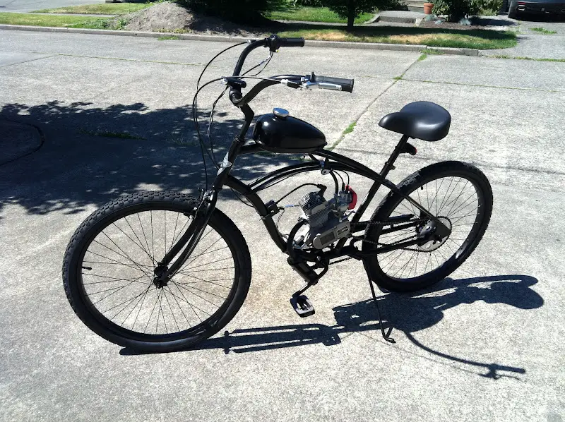

And the right side:
The motor:
Motor close up:
Front mount detail:

Nice build!
A quick note on your muffler. Instead of trying to bend it, you could use a round file to 'oval' the muffler holes so it'll twist out a little bit. Just a thought :)

Wow, nice build. I agree, very clean. You know, your build kind of looks like my bike's gloss-black brother!

Major failure on the rocketbike today, the front motor mount broke and the motor twisted over to the side. Chain broke, locked up the rear wheel but by then I was going slow enough that I didn't go down. In addition to the mount and chain, the front sprocket cover is broken. Photos and a more detailed analysis of the damage to follow...

Here's my new front mount, constructed from a piece of steel bar stock from Home Depot. I may replace the small round standoffs with a section of square 1" steel tubing.

You could also replace the standoffs by using two short pieces of angle iron drilled and spun on each other into a z shape slide them into position and weld them together and eliminate all that shim stuff on the muffler clamp as well as the engine mount. Looks to me like 1 inch angle iron would be about perfect then you could use shorter studs. If you don't have a welder bolt one angle to the engine mount the other to the clamp and slide them together and mark them and have someone buzz them together then it would be absolutely tight and perfect. And get rid of all the shims and sleeves and crap. And I'd use nylock nuts on everything.

I think your new mount will be fine. Thickwall tubular spacers used like that are pretty strong and resistant to lateral forces. Very similar to the design and use of shoulder bolts used on some machine tools. Just re-tighten everything after the first run.
If it start showing signs of trouble, I would then go with Jokes good idea with the angle irons. You could clamp them together in place, then take the clamped assy to the bench and drill and bolt them
