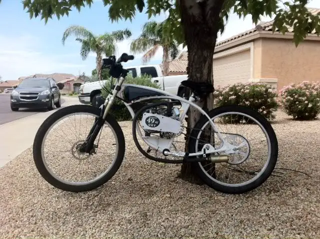

First build, 99cc+Schwinn
Big Bill
Jun 3, 2011
117
arizona
Thanks guy's
I have had it up to 40 mph and still had a little left and it handles
real nice, this is to fun.I normaly ride around 20 to 27 mph so not to
atract to much attension. I have about 250 miles on it now and the
police don't even bother me, I give them a wave and a smile and off
I go brnot.
I switched out the fork to an old triple clamp I had because I did not like
the way the other fork flexed. I will be changing out the front
brake from a 6" to a 8", other than that I can't think of anything
else I would change.
I had 2 problems that I had to repair.
1. The Bung King gas cap spits fuel out the breathe hole.
I fixed that buy drilling and tapping the cap for a 10-32 cap screw.
then I drilled a hole in the center of the cap screw . I installed an o-ring
and screwed it in from the bottom and locked it on with a washer and nut
on the top,then istalled a breather tube.I did not like how big the
barbed fittings were.
2.I am having problem with the jack shaft waring were the bearing
contact the shaft. I am running Timken bearings now so I am hoping the
new shaft fits the bearings tighter.
