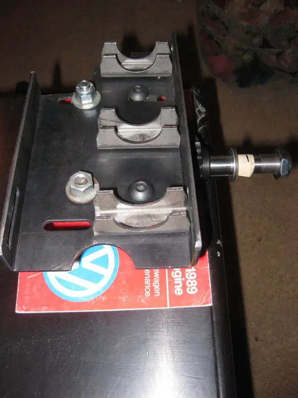

To answer your question cory151, I'm fabbing my own jackshaft system to make it function properly with the engine centered using that torque converter. So yes......here's a peek at what I'm doing

Those bearings would be heavy enough for something very pleasantly surprising(family site after all) That's going to be one mean(vicious) girl, Hope you can handle her bro, I doubt the competition will be able to...
I wouldn't worry about me so much....focus on the poor competition, I'll be just fine!
