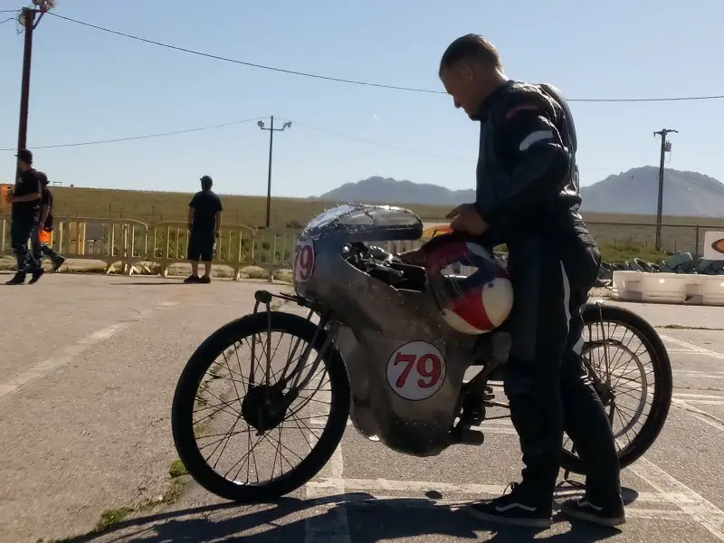

Well my fairing is race tested now and it didn’t work out very well. I laid it over on my second ever lap riding at apex. I then laid it over 2 more times, one during practice, and one during the first heat.
I think I built the fairing body too far towards my knees when riding. In a regular position the edge of the fairing is 3 or so inches in front of my knees, but when I went to lean into a turn, I couldn’t put my leg/knee where I wanted to on the low side.
So I was not getting enough weight on the front tire, and the front tire would wash out. Although I also slid out my rear tire on the final crash. I already put two holes in my brand new leathers and scraped the **** out of one knee skid. I’ve got some sewing/patching to do.
I had a hard time getting used to apex raceway. It’s much smaller and tighter than it looks on video. I could not even reach max rpm of 6,200 or so on the straights, so the fairing probably didn’t help too much with speed either.
I think I will try to cut the fairing back, but I can only go to the frame line. Which is about 3 -4” inside of the existing outline.
I also surprisingly scraped the bottom of the fairing near the bottom mounts on a couple of extra-leaning left hand turns. I might have to also look into reshaping the bottom curve of the fairing as it reaches down to the lower mount.. I don’t think I’ll have time before the next race on May 11th, so I’ll probably run without the fairing for the next race.
