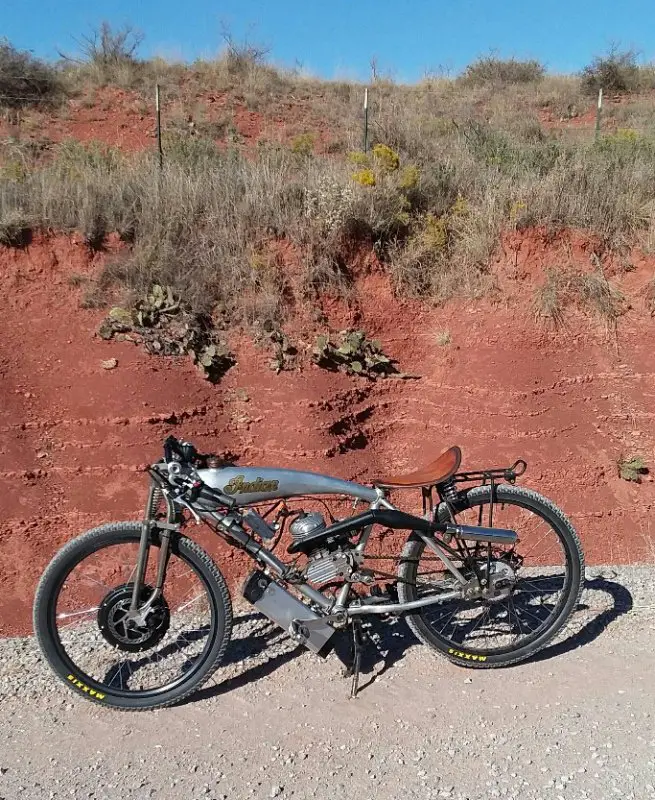

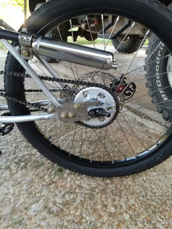

Easy enough to silence as Tony posted glass pack etc. readily available. I've tried a lot of x-chambers on my bikes over the last decade, from real motorcycle chambers (the best power) custom adapted/tuned to 66cc motors, to many styles of after market bolt-on $40. to $100. x-tubes. I currently run two bikes using the Thrust pipes and they work quite well for the price, but are really loud so I adapted both with kit mufflers with just a one to two inch stub pipe remaining to attach to the Thrust stinger that was also cut off to a short stub to insert into the muffler stub. The added weight of the muffler requires good rear pipe support to the bikes frame or damage to the engines cylinder will occur. For $50. I think the Thrust an excellent choice that normally bolts up without alterations, unlike many of the so called bolt on X-pipes, but they are really loud! Look at the photos carefully to see that very little stub remains on either pipe and that they form a slip joint. That's a 1" Harley Davidson tube clamp holding the muffler to the pipe and my hybrid e-bikes frame. So it's extremely over supported and clamped.
