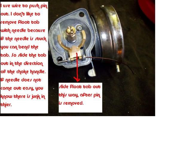

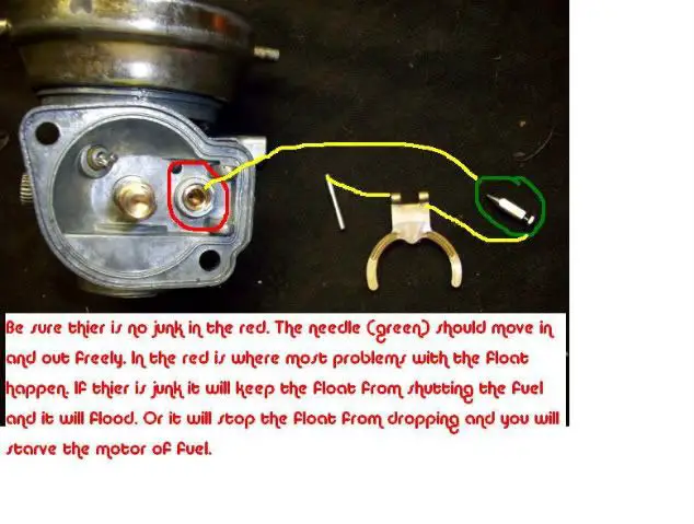

I've been working on this....It's only a first draft to get the bug's worked out to figure how's the best way to do it.. And for me to get practice..But I guess I'll post it and see how it goes. Some input on how to do this better is more then welcome...Remember this is my first attempt...it should get better with time and plan on doing a bunch of " How to"
If your carb is dumping fuel, or not getting any fuel to the plug, check to see if the float is working properly before adjusting the float...there is a good chance thier is just garbage keeping the needle from moving freely.
