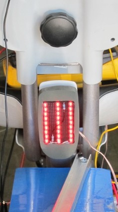

Made the custom tail light. 27 red flat top wide angle (120 degree) LED's wired in series with a dropping resistor.
Wired it on a piece of perfboard and potted the assembly into a piece of poplar I routed a pocket into. Looks cool and works great. Draws about 10 milliamps connected straight to the battery.

Nice Mike, that's a great taillight - it even matches the bike!

Thanks, I like it too. It's not real bright, but very visable and nobody has one like it. Uses a half watt.

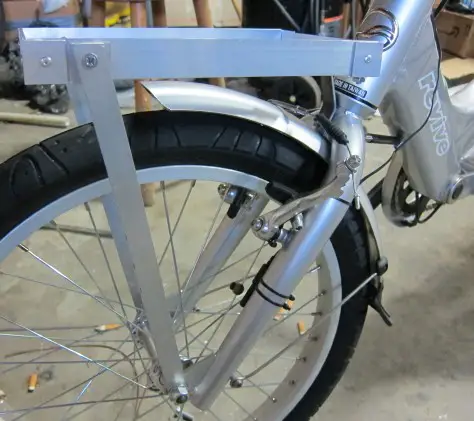

Also going to build a basket rack for the front wheel using the center fork hole and struts to the front axle for support.

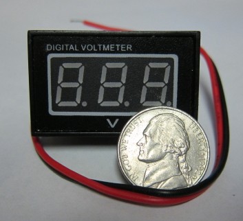

The cute little voltmeter arrived today and it works good. Connected to the battery it read 53.4 volts, exactly what my DMM reads.
I love ebay - :)
I will cut a slot in some aluminum angle and put this little cutie right on the handlebar using the existing mount for the front reflector. Got my stuff for the front basket bracket too, so's I think I'll be done this weekend - :)

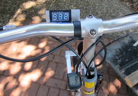

Got my brackets cut for the basket mount and the voltmeter mount, made a new headlight/junction box bracket out of 1.5" alum angle with one side reduced and mounted that. Tomorrow I build the basket mount and mount and wire the voltmeter.

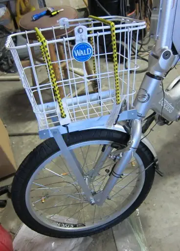

I got the basket rack done. Took a lot longer than I thought it would. But it's really strong and I wouldn't hesitate to put 20-30 lbs in it.
Takes a standard Wald removable basket and it just sits nice in the angle base. Just bungee it to the rack and off you go.
Didn't get the voltmeter mounted and wired, one more thing to do.

Voltmeter on.
It reads 51.6 now with 29 miles on it. Gonna take it out again and try to drain the sucker. This has over a 30 mile range. Ten miles of full throttle and the motor housing was just a little over body temp.

Perhaps I am getting a boost from the regen too. I can verify that it does work, I can see the voltmeter rise when I apply the brakes, so the battery is getting a little boost everytime I stop.
