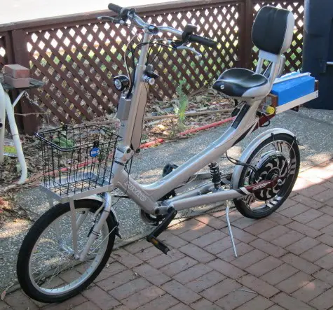

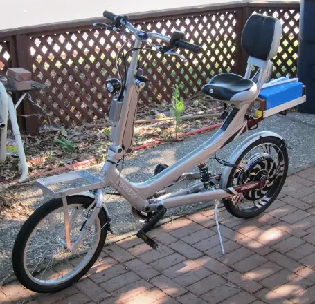

Electric Revive is done!
My first ebike, but not my last - :)
Going to the grocery store today and I'm gonna fill the basket full. Basket test!
Even looks good with the basket on. And this basket is big enough to carry some serious stuff. And won't rip my braze ons out - :)

that is one good looking electric bike. i think the magic pie on them ad to the looks. you did a really nice job mike!
Mike B
Mar 23, 2011
2,256
7
Central CA
Thanks.
I enjoyed this immensly. It was pretty easy and straight forward. I needed to redo the headlight bracket and the basket mount stuff, but that was the only "backpedalling" required. I think I had more time into getting the happy time mounted right than I did on this whole bike.
Yes, I think the magic pie hub motor is the best for these ebikes. Looks good, self contained, direct drive, no transmission.

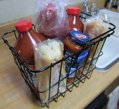

Grocery Run
Passed the test.
A gallon of V8, a quart of spagetti sauce, 2 sandwiches and a sweet onion. Fifteen pounds on the store scale. Easy. The bike was even more stable with those 15 pounds on the front wheel - :)

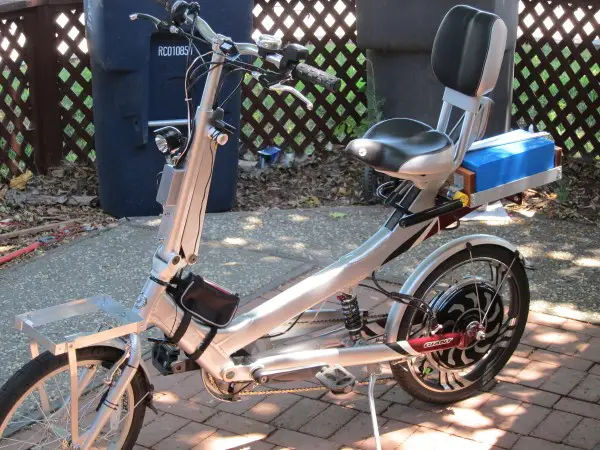

Finishing Touches
Added a little top tube bag, fits perfect. Thinking about one of those CO2 inflators in case of flats.
Put a ring-ding bell on the bars in case I have to warn folks that my silent ebike is coming - :)
And most important, the U-Lock under the seat. That worked out great. I sat down along that bike for a long time and got frustrated with trying to work out a mount location. To my delight I found that the thing just sits there perfectly, no mount needed. That was cool - :)
Up to 32 miles now, how long will it go?
Dunno, but I will before the weekend is over - :)
And the answer is 36 miles. About 75% full on cruise set the rest half throttle (slow cruise the hood)
The controller shuts down when the battery is 3 volts/cell. Cool, you will never damage the battery by drawing down too far. Put it on the charger at 1:30. We will see how long it takes to put a full charge on.
