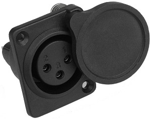

I thing that is the battery charger port. The link to battery page shows the outlet port on the opposite side of this, third photo down on the battery page.

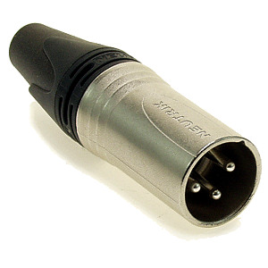

That's a XLR port >
This is the XLR plug you need >
They have choice of $3 and $6 version on this page > https://electricscooterparts.com/batterychargerconnectors.html
*They have other XLR ones on the page that have adapters that may work with the charger you want to use without needing to "wire up" the plug.
Thanks bud, thats what I need!, I'll see if anyone local has it.
This battery has the charger built in, it's in the black part with the connections, the connector you mention on the other side is for a standard 115VAC appliance power cord for the charger ;-}

Fry's Electronics has the connector I need but it comes at a heavy cost...
$3.79 total price store pick-up, and my local Fry's is a staggering 2 miles away!
I will muster up the will and fortitude to brave the trip in this overcast 75F weather for my customer!
Well, not exactly, my sister in law is going to go get it right now on her own dime, but the sentiment is the same ;-}
Thanks again SilentRider ;-}

I think that is the battery charger port.
It appears you were right Steve!
I still can't get my head around this battery, it is supposed to have a built in charger but the switched 50VDC is on the output of the AC appliance cord input, and it has that 3 pin charger connector which the key switch does not effect.
I plugged it into 110VAC to charge it, but it must be some really tricky circuit to put out 50VDC from the same plug.

Guess I should have paid more attention to the thread title than the photo. I thought you were looking for a connector to adapt a external charger that had a different plug. I don't see anything that indicates the battery has a charger built into it. The XLR port on the battery is where you plug in external charger. The "Outlet" port Steve pointed out is for power to the motor. This other similar battery on Amazon shows the charger and power outlet connector.
https://www.amazon.com/LI-Battery-Rechargeable-Battery-Electric-Bicycle/dp/B01LWNPJFD/ref=pd_sbs_468_2?_encoding=UTF8&pd_rd_i=B01LWNPJFD&pd_rd_r=6DA696Z3Z1JDGY2Y7WK5&pd_rd_w=7Y5Hh&pd_rd_wg=Op4C3&psc=1&refRID=6DA696Z3Z1JDGY2Y7WK5
This looks like what you need to connect battery to motor. It's a right angle plug so it won't stick out much when plugged into the battery and run to the motor. > https://electricscooterparts.com/powercords.html
Looks like you'll want to mount the battery so the ports are facing the seat, not the tail of bike.

Thanks KC. My batteries had the same port marked as the charger port and had the same cover to keep the charger port clean.
SilentRider is right I think. I don't see a built in charger in the photo where the top is off the battery. The wires go right to the battery from the charger port and there is no battery charger visible.

I must have been heavily medicated the day I bought this battery, I was under the impression it had the charger build in.
It's not, but no biggie, I still don't feel any pain from the purchase ;-}
That 115VAC Appliance Connector is the key-switched 50VDC output, and I just need to buy a charger that plugs into the 3 connector round port.
No Biggie, and I suppose it makes sense to use a common appliance cord connection when you are talking 30 amps bursts, the wiring can handle it and as a bonus it tucks away nice.
