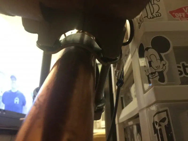

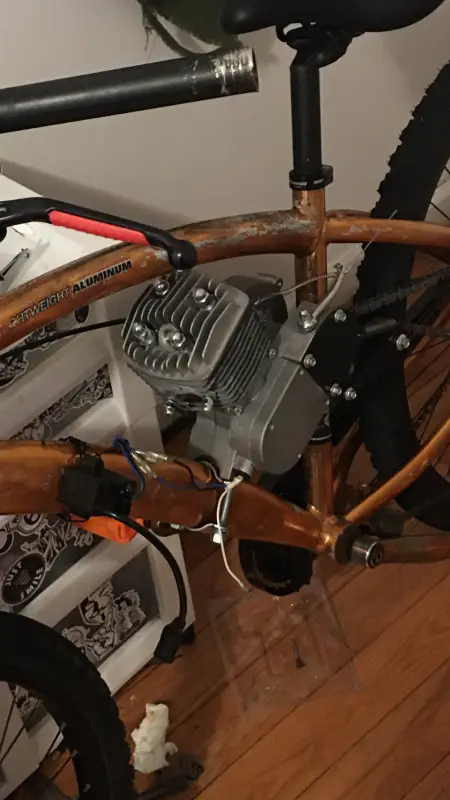

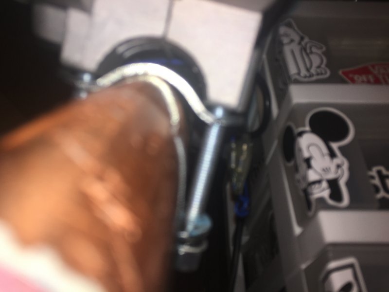

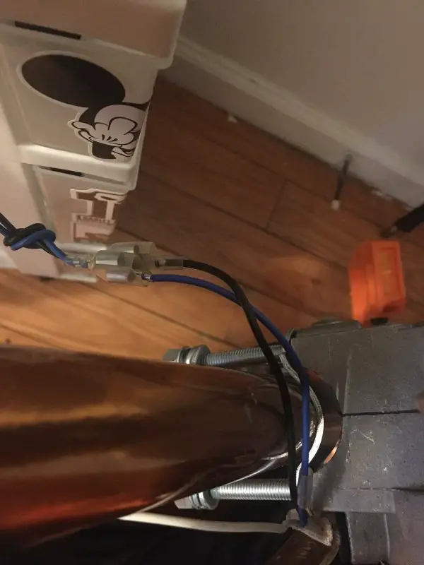

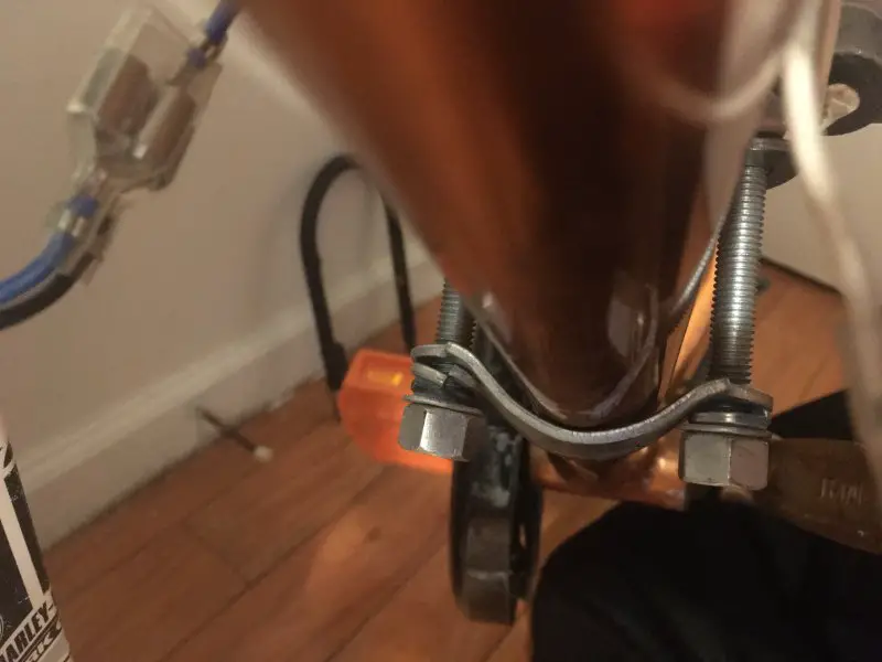

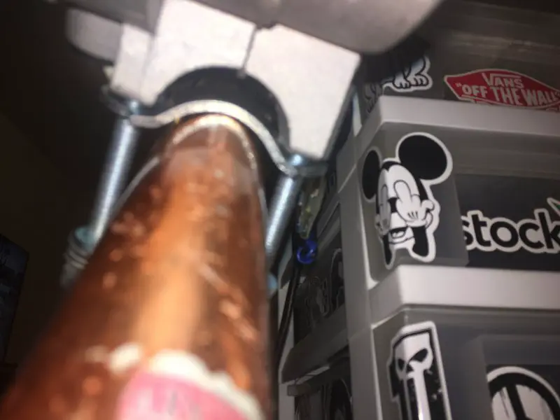

Do you consider this front mount safe?
I plan to get longer studs (yes I know the locknuts are on the very end) The question is do you guys think that sandwiching these two metal plates on the frame and then running the studs through it to secure it to the bike is a bad idea do you think this will break easily?
Can you delete the rear "plate"? That would buy you a bit more roomso your studs will be long enough.
It's ok to use a dremel or a sanding drum and modify the engine mount as to accommodate the frame tube, just don't over do it.
Also, a nut only technically has to be on.... threads sticking out past the nut are just thread sticking out.
I’m not concerned about the front studs because I can always buy longer ones but I need your opinion on the two metal plates that I’m using to mount the engine do you think this will cause too much vibration If you look at the pictures carefully the bottom of the engine mount in the front does not sit completely flush on the top plate this bothers me but at the same time I want to ride and I just want to get out on the street and try my new bike

Ahh ok . I used two of the front mounting plates to create the “sandwich” . I’ll look at it tonight. When I first put it on without the top plate in between the engine and the frame the engine moves from Side to side a little.
Update. I tried running the bike got it to run 3 times momentarily. Rear drive sprocket screws came loose immediately and brushed with brake arm. Got those tightened up got to threadlock em too. Mount stayed tight? (Barely got any run time). I’m kinda frustrated. Fixed leaky gas hose as it was too fat and the clamp won’t clamp onto carb. Also when I pedal my leg keeps hitting the choke moving it.
