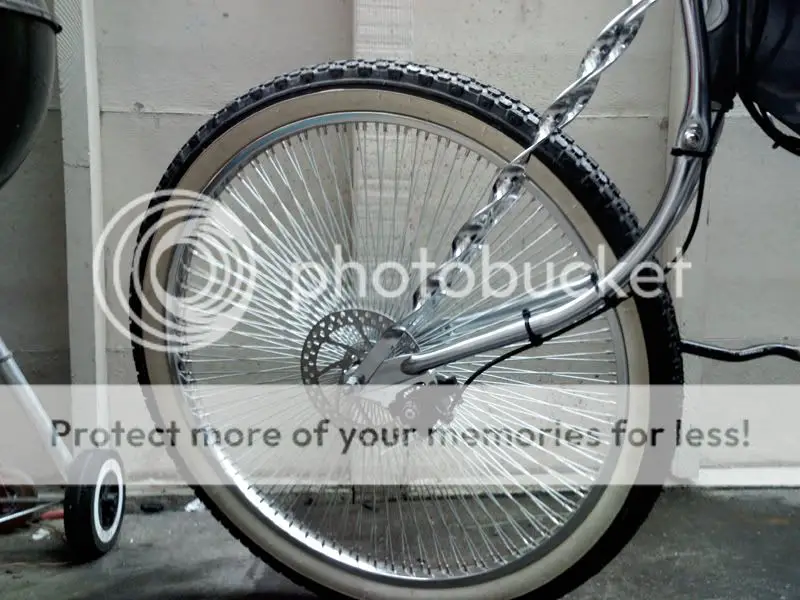

Just a side note pdub,on the disc brake bracket,depending on your forks you might need to grind down the keyway on the disc brake bracket,I had to on mine,I used a drimel took about 2 minutes.The bracket works great..Randy.. oh yeah with your Avid caliper you'll be stopping on a dime.
pdubs
Jan 16, 2010
74
chicago
the Tekro Discs on my mountain bike work fairly well, these Avid calipers ihave just never got installed, glad i held on to them! :D
i grinded the keyway off on a bench grinder, then smoothed it out with a surface cookie.
my buddy polished it up last night and it looked like a mirror!
