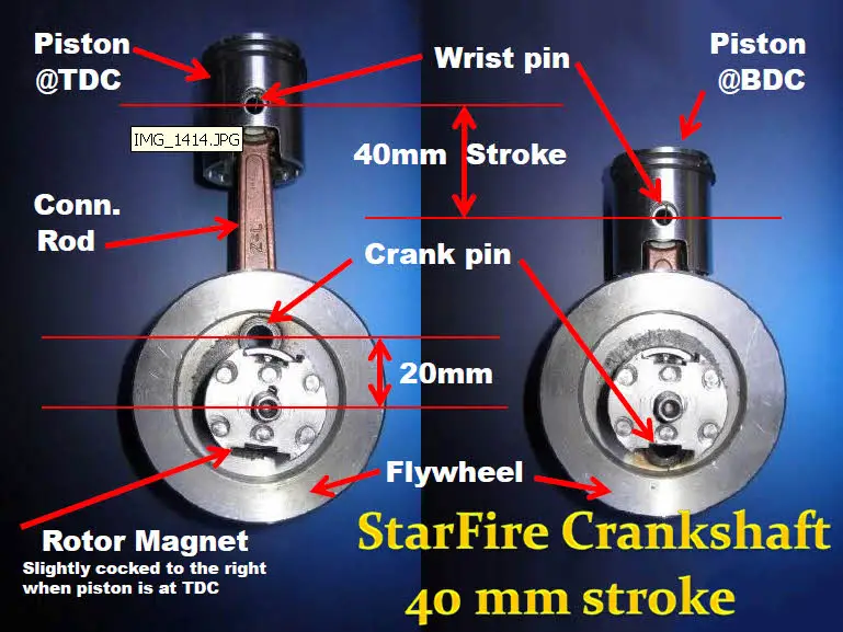

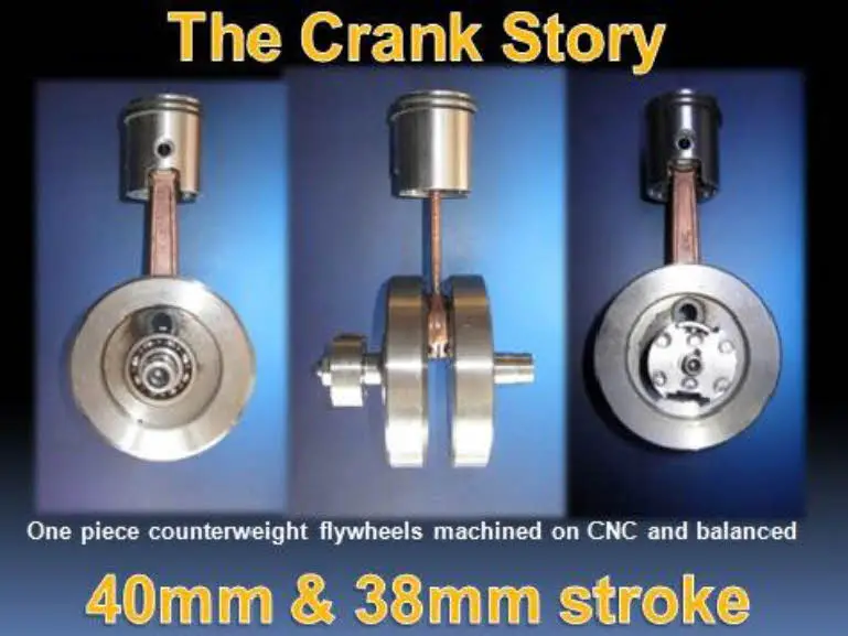

I am wondering if you have a StarFire lower. It is suppose to have a balanced crankshaft.
Here's some pictures from Grubee under Great Magneto Mystery:
http://motorbicycling.com/attachment.php?attachmentid=60930&stc=1&d=1372745857
http://motorbicycling.com/attachment.php?attachmentid=60931&stc=1&d=1372745874

Thanks for the input here BigBlue,
I ordered the engine from LEB/ Lucky Early Bird off of Ebay back then, it was listed as a Model X80A engine on the site add, the crank has the two balance holes drilled in it just like the crank in the new balanced Dax lower I bought from him a couple weeks ago, the LEB engine looks just like the PK-80 Engine that Pirate Cucles sells, entire engine had a real nice coat of metalic gray paint on it and it has the longer bent clutch actuator arm also, was by for the cleanest looking engine out of the box I had seen, the intake and exhaust ports are also larger on it than any of my other engines, just took a couple of picks to show the difference.
