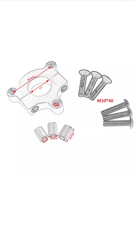

Finally stumbled onto a bracket with dimensions! 98.7 is about 3.877, the measurement for same adaptor was about 80mm is about 3.149! So, I sent text to the vendor, what size is it? I doubt they even know, just a part in a warehouse with generic diagrams.
Again, “presumed” all 3-hole adaptor are the same!
13.7mm is a huge difference!

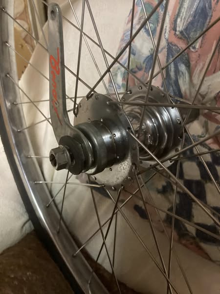

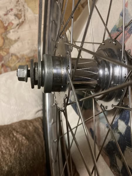

I personally like using a 3 speed internal geared hub that has a disc rotor mount to mount the sprocket. Then you can use rim brakes for the rear wheel
I personally like using a 3-speed internal geared hub that has a disc rotor mount to mount the sprocket. Then you can use rim brakes for the rear wheels

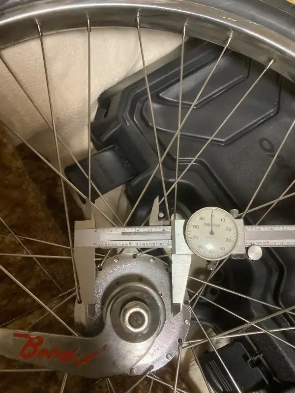

(Hub diameter is 40mm/1.68 so a 1.5 adapter would need machined) Or bolt the sprocket to the left flange of the hub, or even both Just get sprocket 40mm ID
The drill site for 6-bolts is .2200 diameter
The one sprocket comes 57mm ID and the 3 countersunk holes for the (adapter/adaptor)?

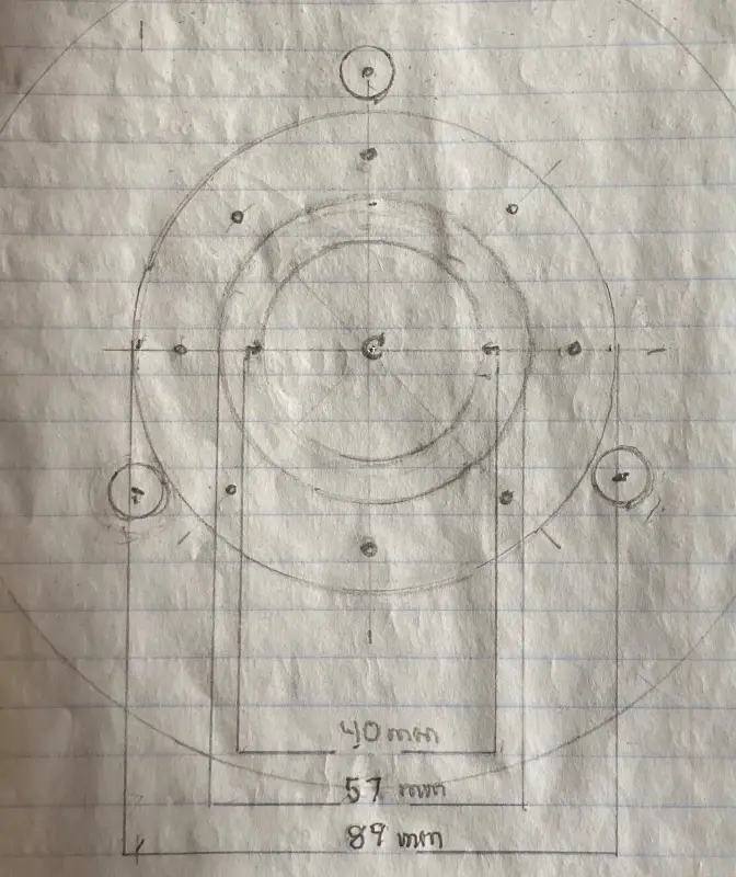

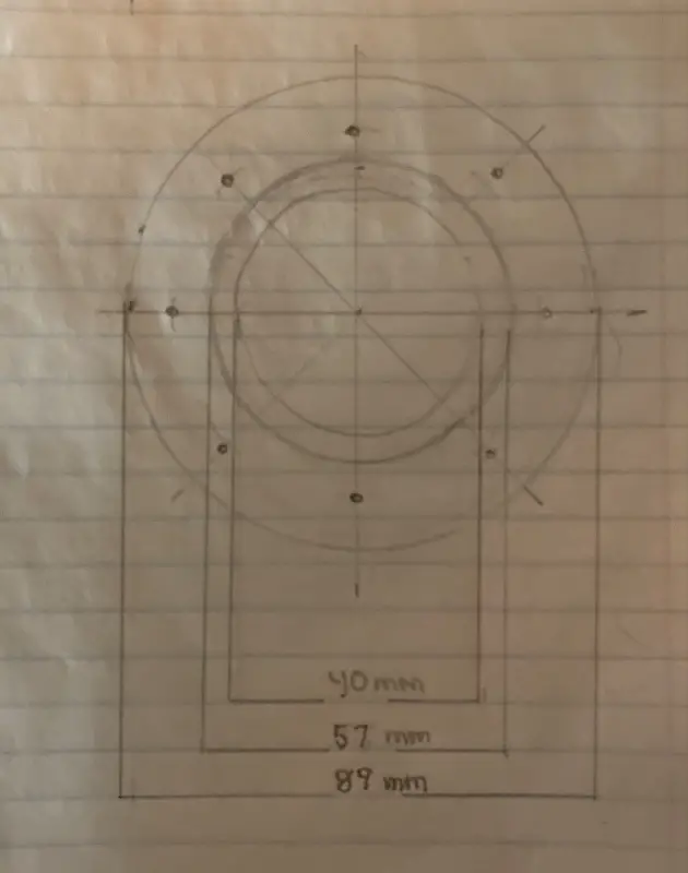

(I came up with 8 bolts)
77mm-diameter bolt pattern
40mm-hub id
57mm-sprocket bore
89mm-hub flange diameter
May need a slight rotation on the 3-hole positioning, or reduce bolt holes to -7

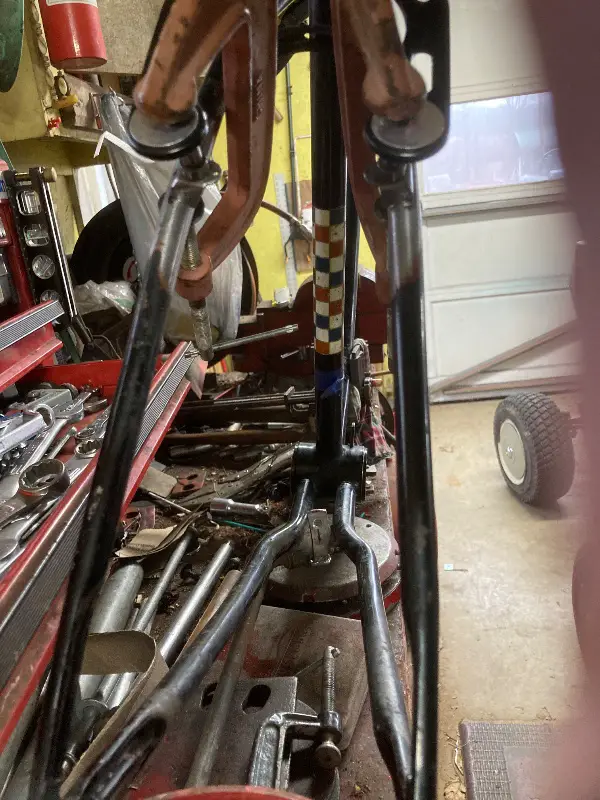

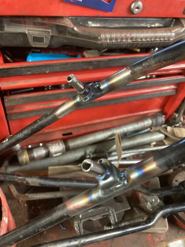

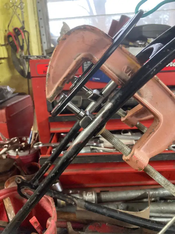

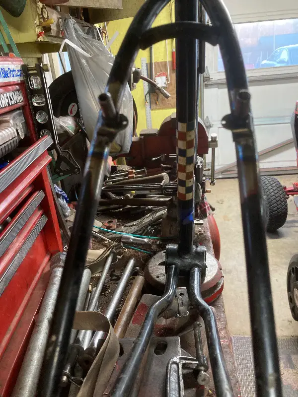

Finally prepared the rear brake boss for weld, measured three times with two different 26” wheels for reference
Tig
Very close tolerance for cantilever, v-brakes will not fit this position at all
