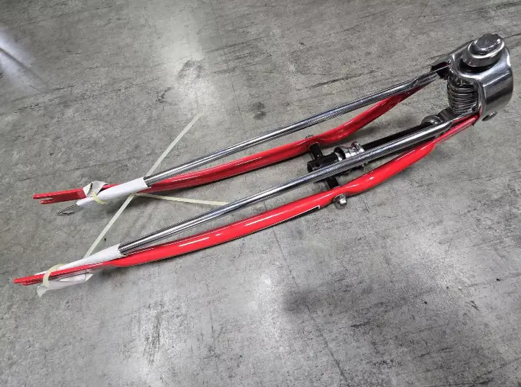

Yeah, right. I bought the Black Panther and have a Schwinn Phantom Springer Fork.

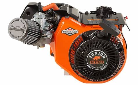

After reading the specs for each one the Briggs is the over-all choice , but at 1k!
The Ducson, Tollostin and factory predator are close in price.

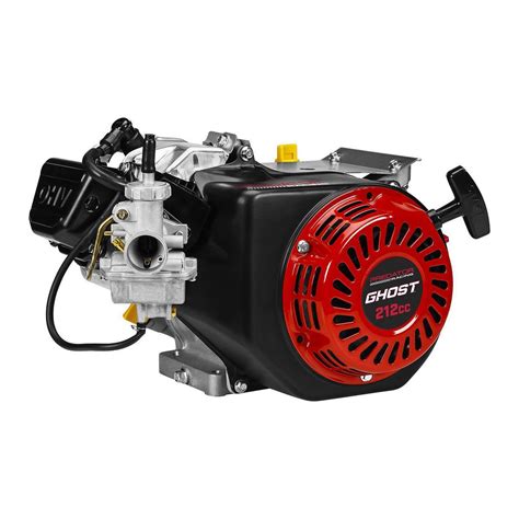

Ghost hits that 6000 rpm and mid range in

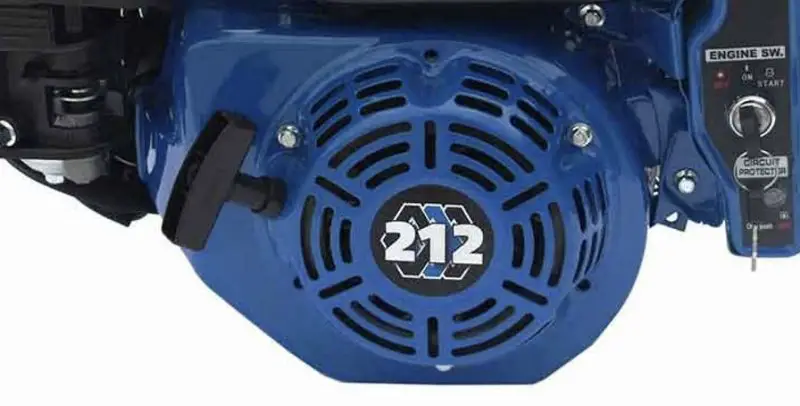

Ducson 212
Briggs LO206

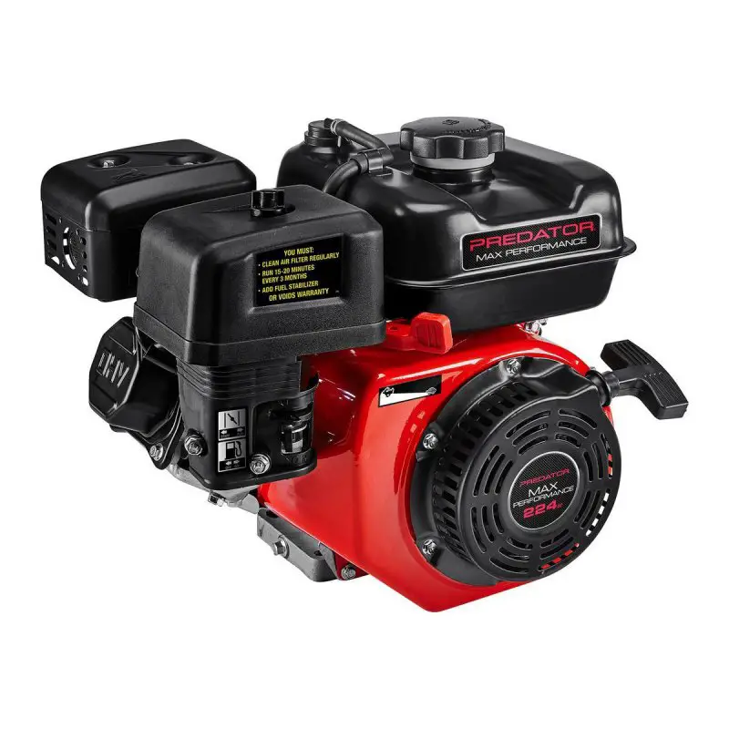

Predator 224
That 224 is no joke. Way better on torque than the 212. A 212 aluminum flywheel and 212 camshaft (since the original is plastic and doesn't hold up to rpm) you'll have a screamer

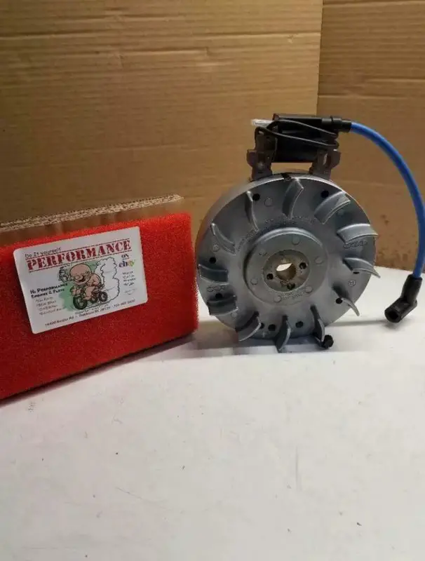

A Kit like this should suffice Includes non restrictive coil set to .50

You say the 224 has good components? Camshaft and flywheel?
The cam is plastic in the 224 and tends to break with higher rpm. Iirc a 212 camshaft fits. The flywheel is just a safe guard and allows for more speed in the future. I recommend if you replace the camshaft and flywheel to punch out the governor gear rod and put a bolt in the case and properly bypass the governor.
I suppose opening up the motor and a good inspection couldn’t hurt. Also , in some incidents of loose nut on the flywheel from factory, like they know it’s gonna be changed!
Seriously, there’s mixed opinions on the cam, but a handful of bolts shouldn’t deter the cam swop

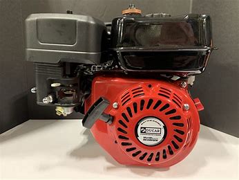

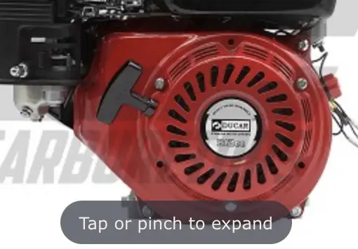

Makes me ponder the Ducar 212, it’s already aluminum flywheel and steel cam?

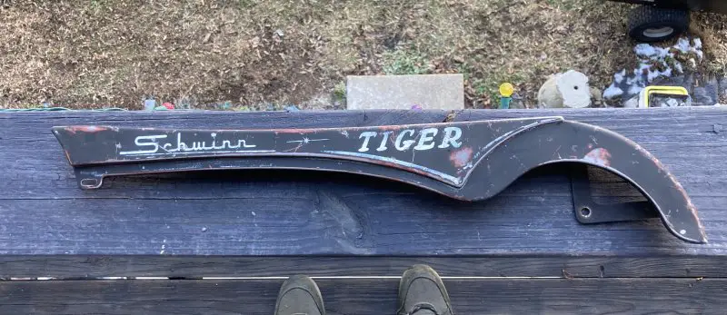

My folks bought me a Tiger in 1961. Had a three speed Sturmey. the works. Dad likely paid most of a pay check for it.
Both the tiger and corvette are selling for $500 around here. What do you say I take that corvette off you hands double you money? :)
