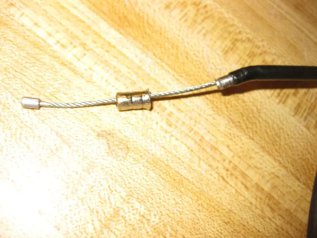

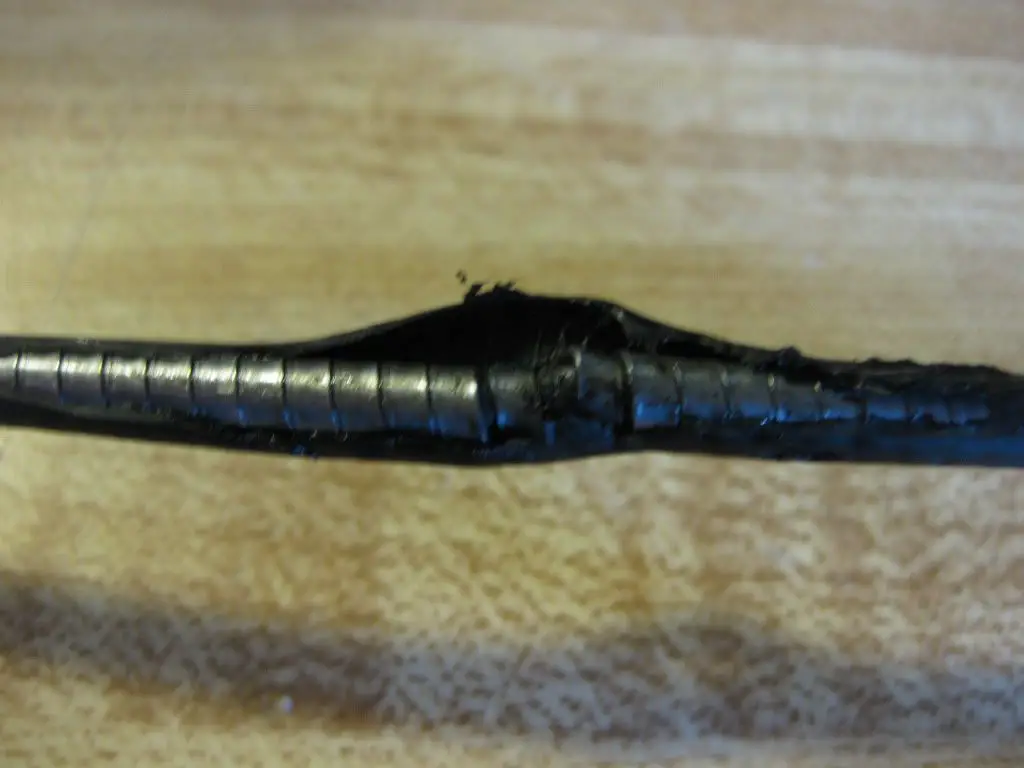

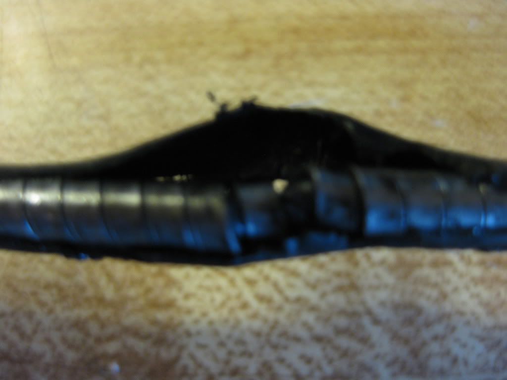

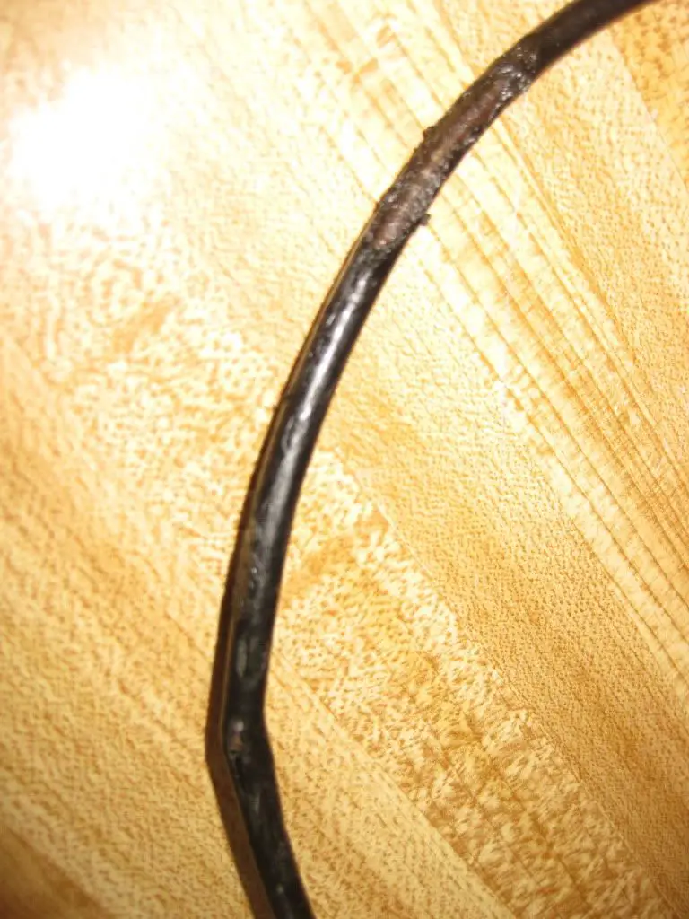

This was the culprit that ruined my last ride of the year 2012. Knowing full well the condition of this toasted throttle cable, I just had to take it out for a ride.......big mistake!
kink at carburetor end
really bad kink in the middle of the cable housing
nobody's fault but mine......
Wow! Kinky cables just don't belong on a bike I guess.
Sorry to hear that it was a $7 part that caused the whole mess.
At least you were able to walk away from it!
