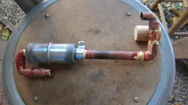

Copper exhaust pipe... how to bend?
That was done with BernzOmatic copper phospherous flux coated rod available at your local hardware store. Melts at ~1400F. Just a little less than pure copper, so be careful. The cool thing is this rod will braze copper to steel - :)
You need to get the metal red hot and it will flow just like solder. A swirl mapp torch will work for light work, but you may need oxy-acetylene for bigger work.

Just mapp-air should work for small stuff.
I actually got a small piece of steel hot enough with propane-air to test if the stuff stuck to steel. Copper is harder though, it is so heat conductive that it really pulls the heat away from the fire.

Forget the bender altogether SB, take your length of pipe, sweat a cap on one end, fill the pipe with sand (packing it tight), sweat a cap on the other end then bend around a block of wood cut to the curve you're looking for. The sand will keep the pipe from collapsing.
Exactly what I was going to suggest SB !!
