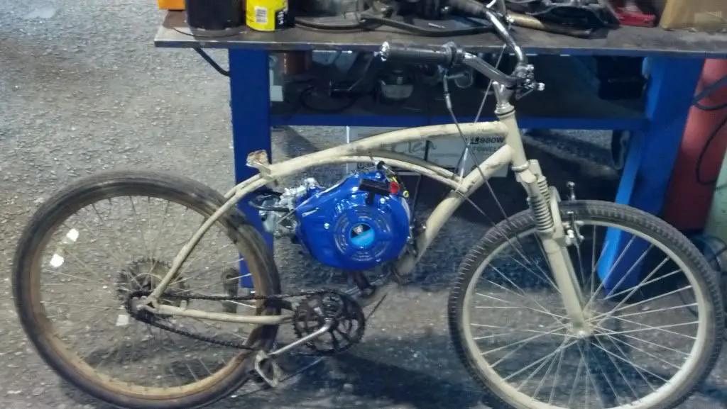

That is one big lump of a motor in that little frame.
Still curious why you thought you needed that big of a motor for a commuter?

6.5hp cranbrook, engine is mounted
Did you totally cut the seat tube out of the frame to get the engine stuffed in there? Are you relying on the engine to take the place of the removed seat tube as a load path from the seat downward? If so, you're REALLY going to be applying a point load on the downtube. If not, the seat stays are going to be overstressed. Either way, it's a recipe for a frame failure without further stiffening. Perhaps you already have a plan to add that triangulation back in?

That engine needs to be mounted solidly in the frame......the frame has to be strong enough to support the engine solidly. You have too much frame flex and need to beef that flimsey frame up a bit.

That’s such a great deal if ya know what you are doing. I have seen a trend to purchase these motors and install them in bikes that are of poor quality, with poor installations. What are these people thinking, what are you thinking, it's a dam death ride and it's a matter of time before someone gets hurt bad.

The frame is reinforced if motor was any more solid it would be welded, back to the drawing board hopefully be operational in 2 weeks
only shakes at idle just the same as the ht engine the fram has 2 square tube that run from the seat stayes to the chain stains on both sides for lateral support, the chain from the cvt to jackshaft is solid, no bind no issues but the chain frokm the jckshaft to the backwheeel binds evn when rolling it. and when i ride it it jumps off and locks up. i think the distant from the jackshaft gear and the mounting plate are 2 close and isnt allowing for slack, wich would cause it to bind up, im just going to buy another jackshaft hit and mount it differently
working at a fab shop? can't line up a simple chain sprocket to sprocket on a hard tail? no clue on spokes ect? by the look of your work i'd say the frame is flexing so much it's spitting the chain off. its good to admit past mistakes but if you incest on being a scofflaw you will not be able to make house payments from jail. someone had to say it. good luck on your new house. and metro link and a peddle bike ain't so bad for a while. people do it all the time. dennis

Flying down the Santa Ana River Trail on that butchered frame catastrophe isn't good for anyone, especially your own self.
