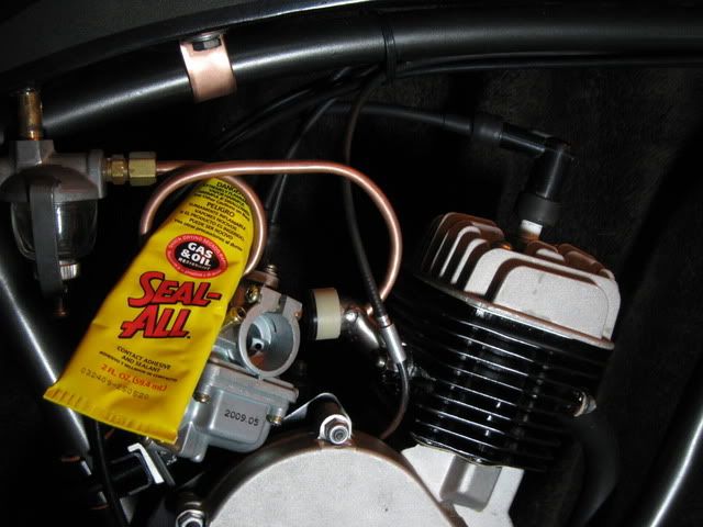

For those havin' problems with the CNS "rotating" on the chrome intake, this might help - I roughed up the surface of the chrome a bit and applied a small amount of 'Seal-All': http://www.eclecticproducts.com/sealall.htm a fuel resistant contact adhesive & sealant to just the manifold - then slid the carb & nylon bushing into place to set overnight without tightening the fastener.
The next morning I pulled the carb back off and the spacer stayed right in place, I could force it back off with some effort but unlike your typical instagasket goo, this is tough stuff designed to be an adhesive, it should help *shrug*
I gotta get ofn my lazy but and jus' make a proper intake fer the thing lol

For those havin' problems with the CNS "rotating" on the chrome intake, this might help - I roughed up the surface of the chrome a bit and applied a small amount of 'Seal-All': Seal-All Contact and Sealant Adhesive 1109 a fuel resistant contact adhesive & sealant to just the manifold - then slid the carb & nylon bushing into place to set overnight without tightening the fastener.
Thanks Barely, it looks like it will be better than the bailing wire im using now, works but looks to redneck!

Keep an eye on it anyway, this was a "stop-gap" measure until I make a properly sized manifold...
but it's better than nothin' ;)

Barely, I love the fuel filter and rigid line set-up! I think that I will just have to do something similar on my "vintage" style build that I am working on now.
