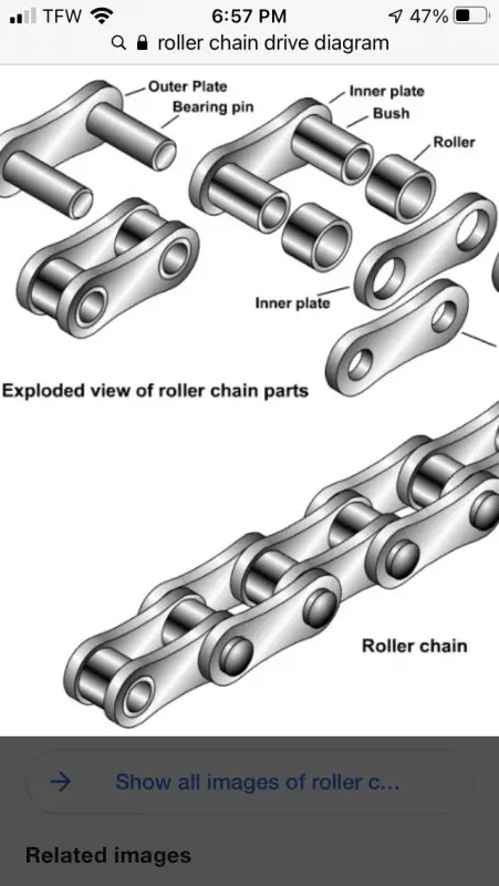

The link pins are pressed into the side plates so they don’t rotate or wear the side plate holes oblong at all. Any stretch comes from wear of the pins and the bearings they go through.

The bearing pin runs in the bushing and the roller runs on its outside. The bushing pin is a bearing both inside and outside. Google is your friend.
Never heard a bushing pin called a bearing either??? Guess different places uses different terminologies. I'm very aware of how to use a search engine as well.
