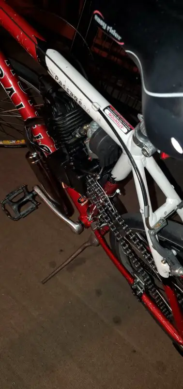

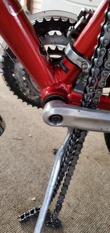

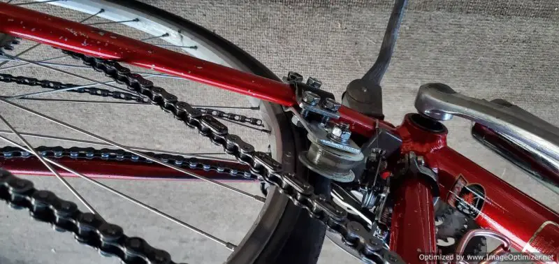

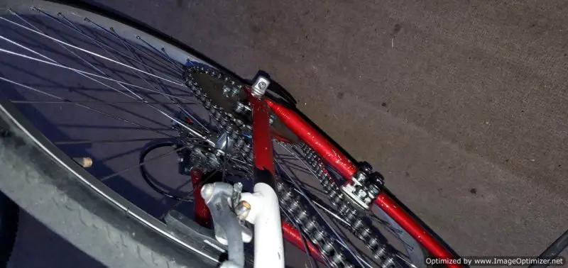

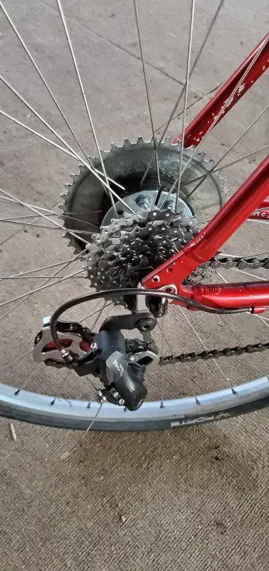

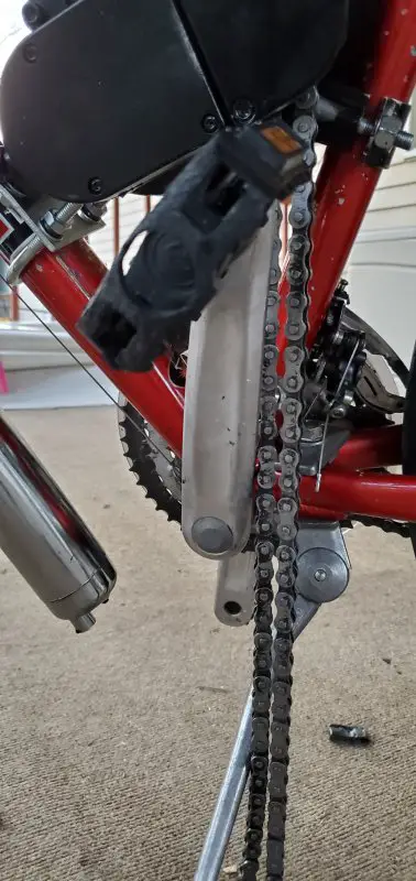

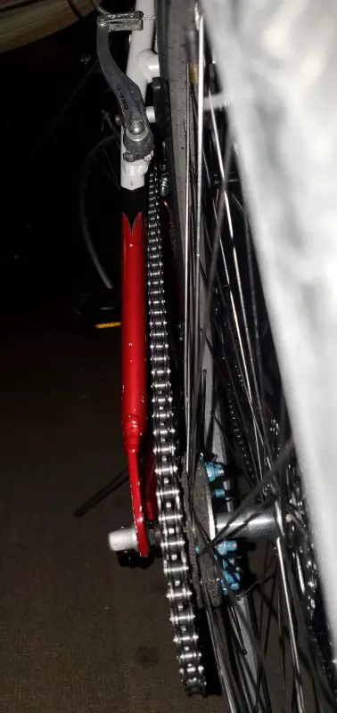

Hi everyone,
Pretty new to all things motorized bicycle. I've got a 2-stroke 80cc road motorbike in its engine-breaking period. All was working fine until the chain started jumping off/skipping. I had tried adjusting the tensioner as per a few videos on youtube that I found, and that didn't do it.
I then decided to cut the chain a bit shorter thinking it was too much slack, and cut it a little too short and the chain currently has about 4 master links (read somewhere that it doesn't matter how many master links you have, please correct me if that's incorrect). Tried riding it and it worked for a couple of blocks then it started getting stuck...

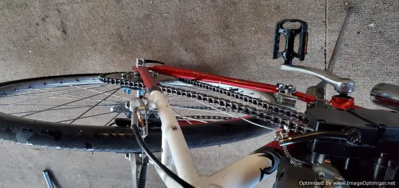

From what I've read in different posts and learned from other videos it could be an issue with the motor alignment (making sure the chain is straight from the motor drive-train :confused: to the rear sprocket), the rear sprocket alignment (which I re-installed also to try and fix the problem and made sure there is no wobble), or I need a new chain..
Not exactly sure what's going on or what to do, and definitely need some help. I've attached some pictures and a video in hopes that it can provide clarity on what's going on!

Welcome Fad!

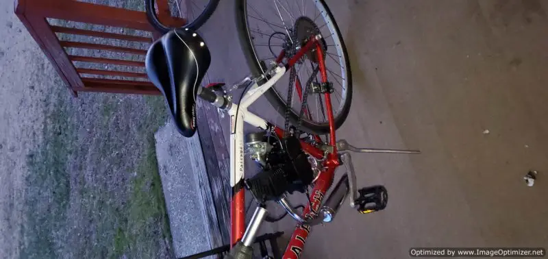

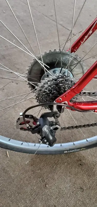

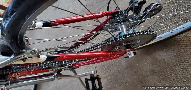

Engine cocked crooked in frame is my first guess. Great you posted pics but they are puzzle pieces to me. I gotta lay down to understand them. Looks to be a drastic forward tilt to the engine. You may have to remove the engine from frame and consider a different forward mount to reduce that. https://www.amazon.com/dolphin1986-...qid=1583315219&sourceid=Mozilla-search&sr=8-4

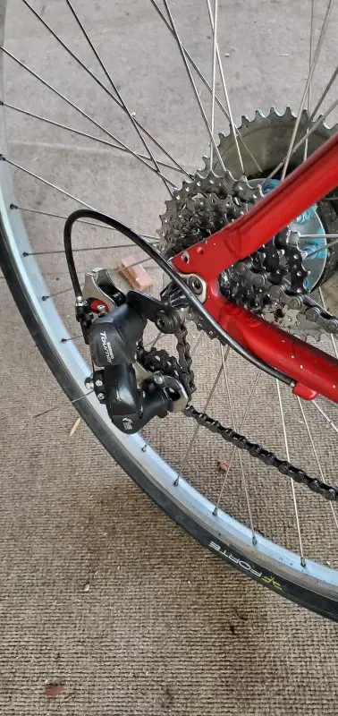

. Using the rubber rag mount allows for ZERO lateral rear sprocket adjustment. Multi speed rear wheels can be a bit hit or miss. Flipping the rear sprocket so it dishes the other way may be a better alignment? Pull the clutch arm cover 3 bolts and look for WEAR areas.
Best upgrade for the drive line is one of these. Measure the diam of your rear hub and look forward to purchasing one of these in the near future.
https://www.amazon.com/CDHPOWER-Rea...5728&sprefix=gas+bike+sprocket,aps,146&sr=8-6

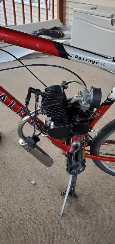

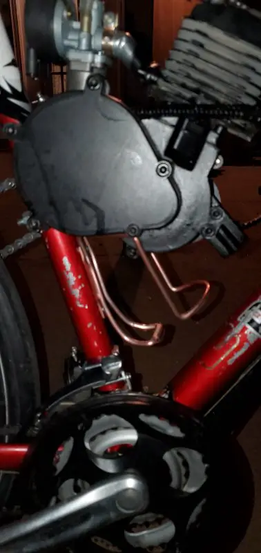

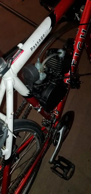

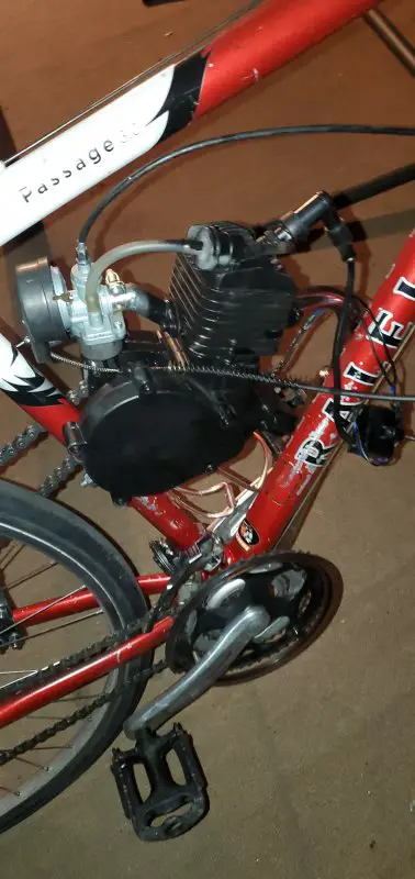

I'm with Allen, can't tell much from the angled pictures. We can't see the front mount of the engine but it has to be mounted solid to the frame without a gap and do not use rubber between the mount and frame. I make my front mounts to fit each bike because most are slightly different. I forgot, welcome to the forum.
Thank you for the responses and the welcome! I can take some more pictures, that's not a problem. What angle/component of the bike would be helpful for you to see?
Also, I raised the motor that way to create some clearance for the pedals. If I mount it lower so the motor can be mounted using BOTH mounts the pedals hit the exhaust/muffler which is another frustration.
Would the bike run okay if it's mounted with the rear mount only as it is now and I get a rear hub adapter like the one Allen posted? Or does the motor HAVE to be mounted solidly on both ends?
Again thanks for the prompt replies and helpful info. Looking forward to hearing back from yall!
NO! Most important gotta be solid @ both points.
If your pedal clearence is an issue and minor enough you can take a body grinder to the back side of the pedal crank to allow clearance, if not, we got another prob.

Glad to be of some help Fad. It's all a process of tackling issues one at a time. Knowing which prob to tend first is most important.
1) Is the whole using multiple master links on the chain an issue?
well - You should not need more than one master link, more than one is one more than needed, with that said there are half links avail also. You Should own a chain breaker like thishttps://www.amazon.com/AZSSMUK-Detacher-Breaker-Motorcycle-Replacement/dp/B079K9YPJL/ref=sr_1_10?keywords=motorcycle+chain+break&link_code=qs&qid=1583331685&sourceid=Mozilla-search&sr=8-10
Tractor supply carries #41 machine chain which works nicely with our bikes. It is slightly more narrow than the 415H that comes with the kits. Box contains enough chain to complete 2 bikes (10ft) with several links left over. Before throwing more money @ the prob. Pull that cover and look at the wear marks which will give you better insight to the grinding prob. Look at the Master Links to see if any Alum "skin" is in them. I do think more than one Master link can contribute to chain travel issues especially in the clutch cover and around the small drive sprocket. Inspect the cover and chain @ master links but don't fix this yet... Let's do a couple other things first.
2) If I mount the engine properly, the metal arm of the pedal crank will hit the muffler/exhaust. Have this happened to you previously? Any suggestions on what to do/buy?
Yes, another common issue. So set me straight-- here. Can't lessen engine angle due to muffler clearance issue and pedal crank issue.
Accept the fact you can not ride for a couple days here till the two issues above are tended.
Remove the muffler from the engine, Remove the Chain from the engine. The only thing now preventing a good solid install is that Pedal crank. Start with this. Now -- If you can grind away enough metal from the back side of the pedal crank to clear the motor. that is one problem solved. The immediate objective is to mount the engine in the "V" as low and snug as possible to insure the best mount. So I f grinding is not an option you may need to purchase a wide crank set found here. https://www.amazon.com/CDHPOWER-Con...ds=wide+pedal+crank+kit&qid=1583331065&sr=8-5
This alone could solve both clearance issues. Do some measuring and looking for the correct kit for your particular bike. Local bike shop comes to mind.
The muffler can be dented or bent using heat from a propane torch and a bench vise. Mount that motor in the frame first. It is possible drive line issues will disappear after mounted well?? Keep us posted.

As promised, you'll find another set of pictures that will hopefully provide better angles and more clarity. If anything it'll confirm your suggestions.
I've also gone ahead and ordered the forward mount to mount the engine properly. I'll deal with the pedals once I install the mounts properly and keep y'all posted.

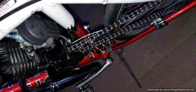

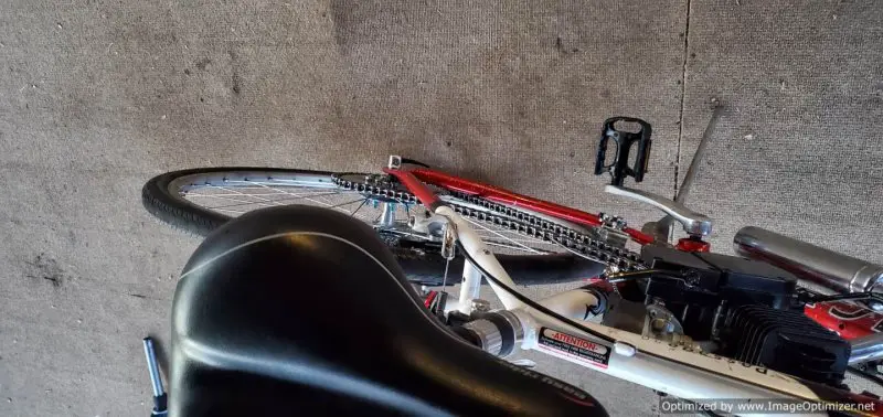

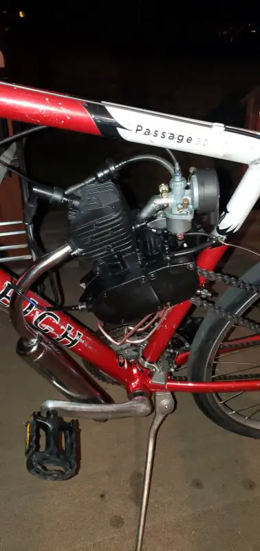

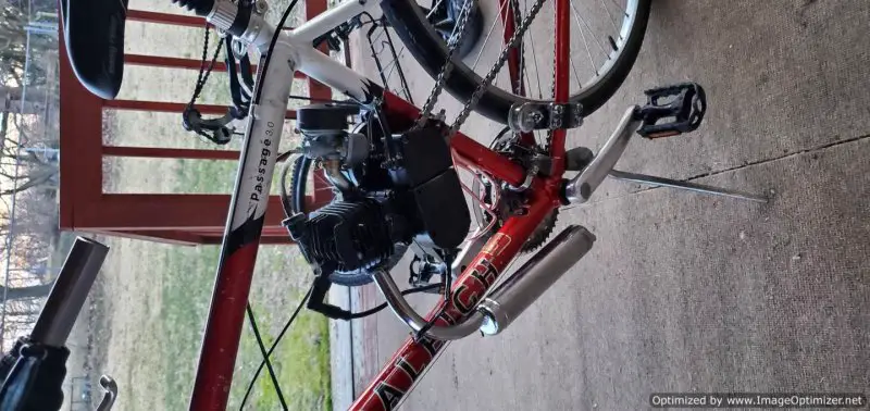

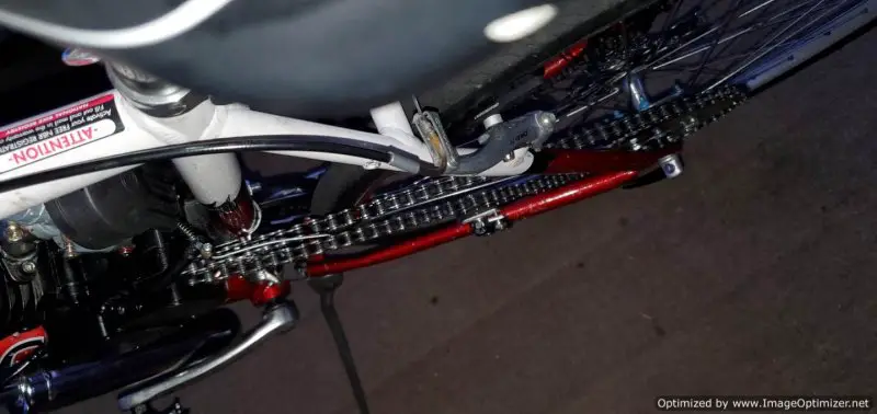

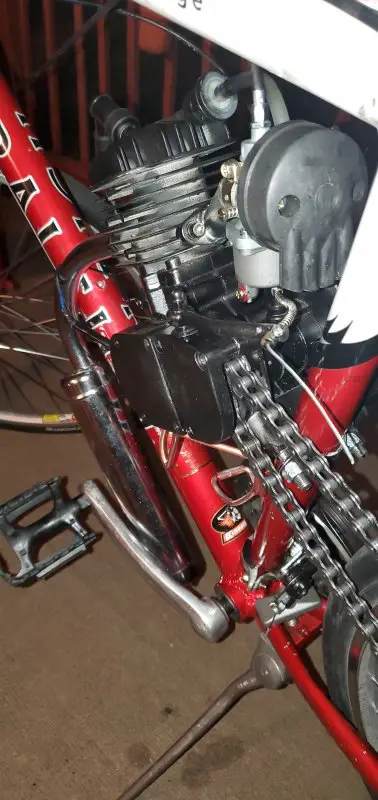

Hey Allen and others!
Quick update... I've installed the engine correctly (I believe lol, would love to get a check on it). Now, as we had suspected the pedal hits the muffler.
I've attached a video of the pedals hitting the muffler, and pictures of the engine install.

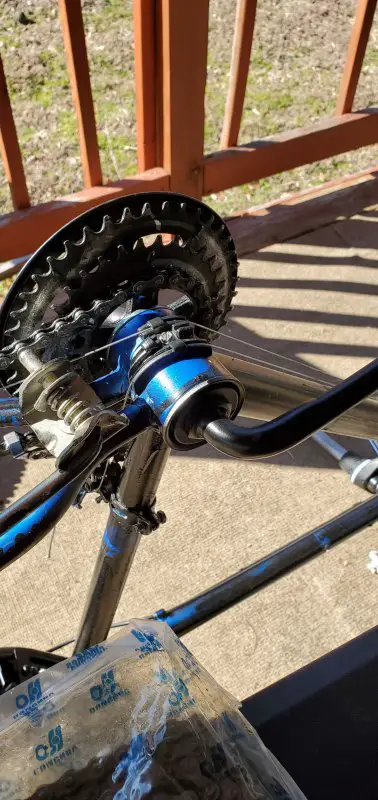

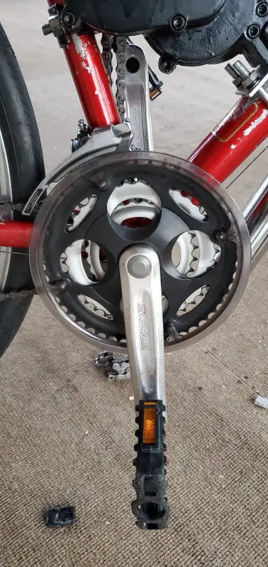

One more set of pictures you'll find are of the pedal/crankset... I've also take pictures of another bike I have and I'm wondering 1) would any of you know where to grab a wide crankset of the same kind or that it's compatible with the road bike? 2) would the crankset of the other bike fit the road bike (the one with the engine), or would it be worth trying to replace the crank arm on the road bike with the black on shown which has a bend and hence is wider?

Engine install looks good! Before throwing money in a new crankset I would remove the muffler from the engine and place it in a bench vice, apply some heat with a propane torch and bend the muffler tube inward. A small bend in the right place is all you need to make this work.
If you decide to throw any money at it I would do a different exhaust altogether. Like this one
https://www.amazon.com/dp/B01N5T44RW/ref=twister_B07CP5FY7T?_encoding=UTF8&psc=1
Exits up and over the top of the engine, Gotta warn you it is loud. Other options are avail.
It doesn’t need much, like I’ve posted before you can in-large the muffler mounting holes just a bit and it will clear.

The carburator shown in your pic is a standard kit NT. The simplest, and in my opinion easiest to work with. When set up right - my opinion - provide very good performance. Could be the float fork needs a little tweak. Without knowing for sure I guess to say "the float may be allowing too much fuel into the bowl". You mention above However, the sputter is weak and I feel it losing power even with choke all the way up and full throttle Does the choke up help to keep it running?
