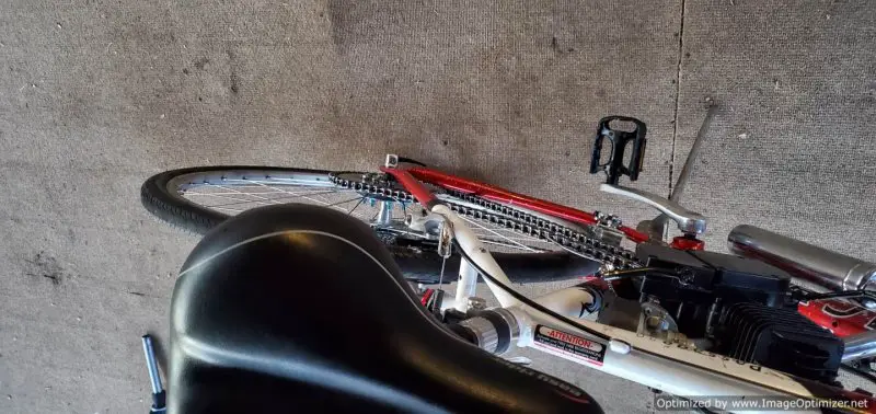

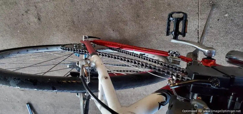

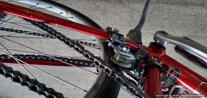

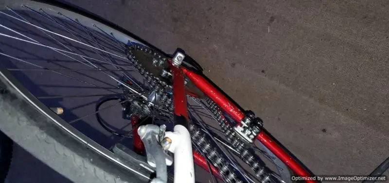

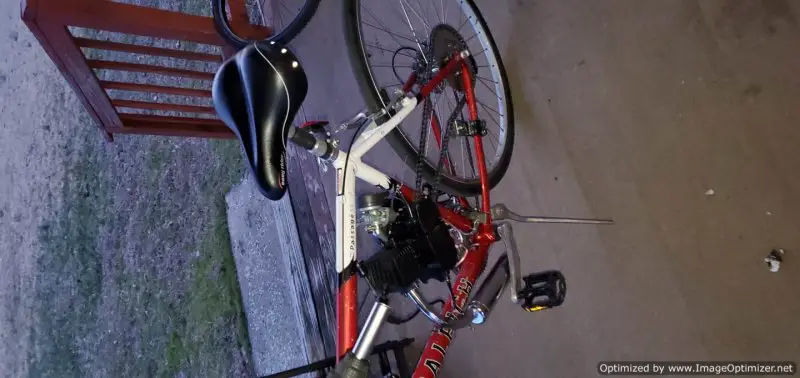

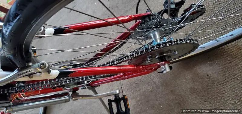

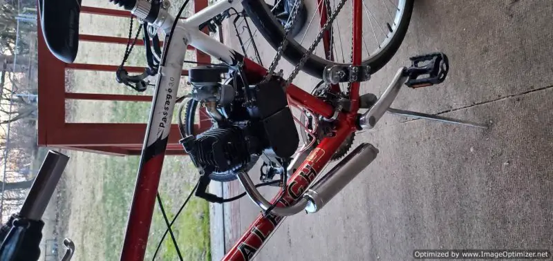

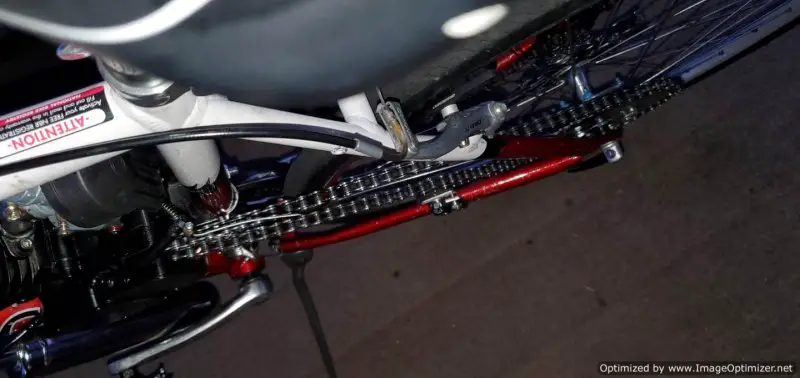

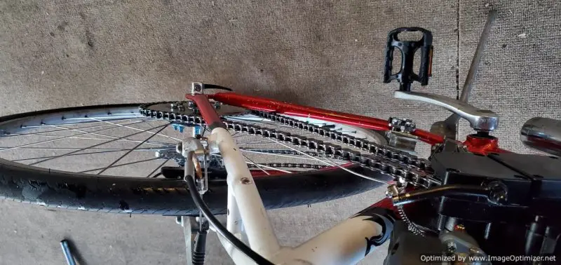

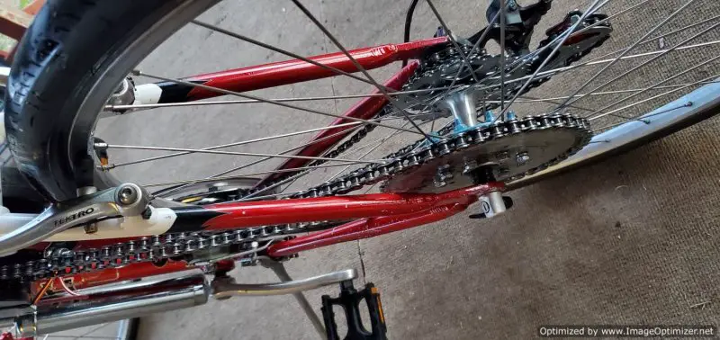

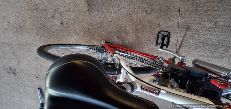

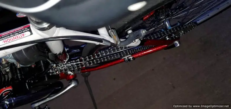

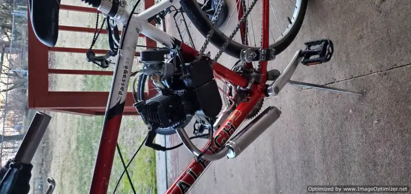

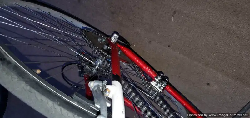

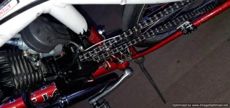

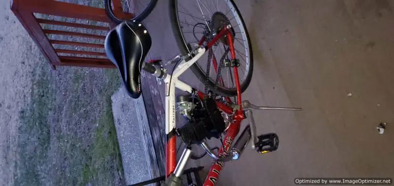

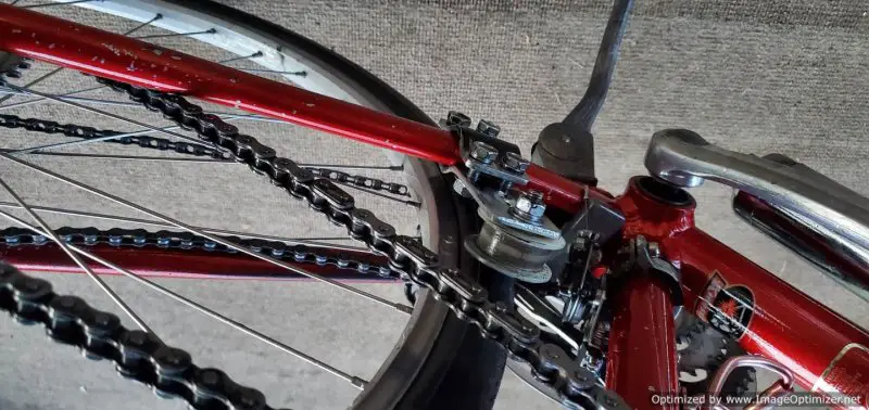

Pretty new to all things motorized bicycle. I've got a 2-stroke 80cc road motorbike in its engine-breaking period. All was working fine until the chain started jumping off/skipping. I had tried adjusting the tensioner as per a few videos on youtube that I found, and that didn't do it.
I then decided to cut the chain a bit shorter thinking it was too much slack, and cut it a little too short and the chain currently has about 4 master links (read somewhere that it doesn't matter how many master links you have, please correct me if that's incorrect). Tried riding it and it worked for a couple of blocks then it started getting stuck...
From what I've read in different posts and learned from other videos it could be an issue with the motor alignment (making sure the chain is straight from the motor drive-trainto the rear sprocket), the rear sprocket alignment (which I re-installed also to try and fix the problem and made sure there is no wobble), or I need a new chain..
Not exactly sure what's going on or what to do, and definitely need some help. I've attached some pictures and a video in hopes that it can provide clarity on what's going on!
