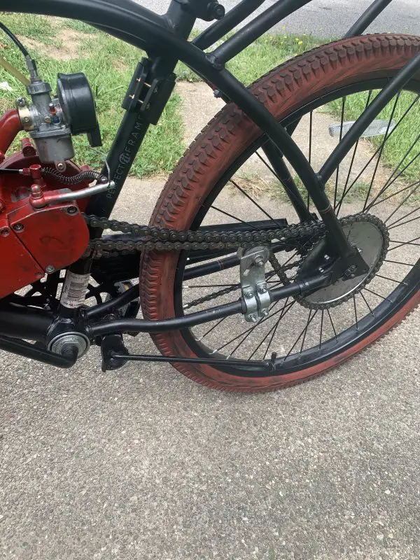

When I move the bike the chain just comes off of the sprockets once it’s at a certain point and the more I move it gradually comes off more (it starts to come off where the tensioner is) what should I do

From the picture your chain is too loose, tighten the chain first. Is that rubber where the tensioner mounts? If so it won't stay in place. To align the chain you'll need to twist the tensioner to align the wheel with the chain travel, the chain steers just like a bicycle, twist or bend it in the opposite direction than the side the chain comes off on.

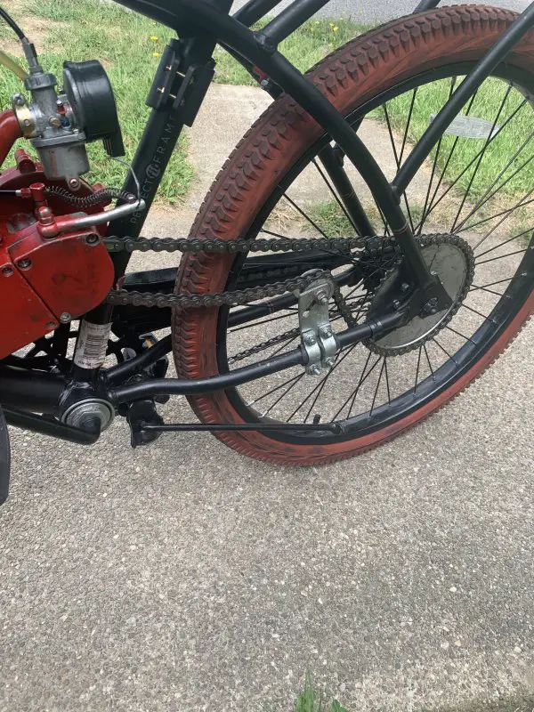

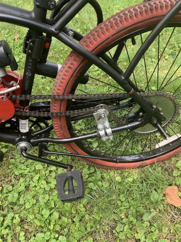

I got the chain to stay on but when I petal it rubs at this point I’m at a stand still honestly I’ll pay for some advice at this point

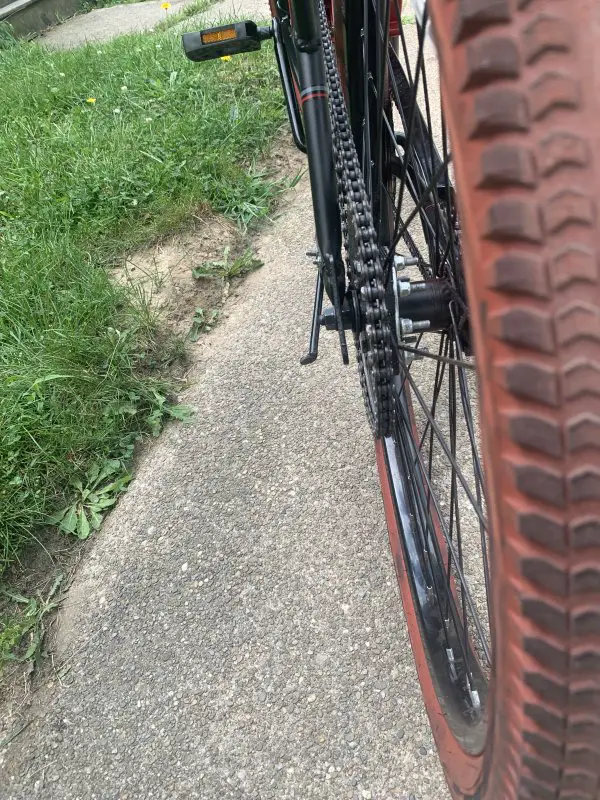

It stop moving at a certain point now, the engine runs fine but it’s just the chain is wonky

Is the chain rubbing the tire or frame? If it’s the tire make sure the wheel is centered, I’ve seen people offset it slightly to clear. If it’s rubbing the frame add washers between the inside wheel nuts and frame to widen the drop outs apart.
looks to me like that chain is still to loose, as already suggested, I'd remove a link form the chain and then you should be able to properly adjust the tension.
I 2nd Greg on how to potentially eliminate the chain rubbing on tire or frame and I also agree that the rubber between frame and tensioner needs to go above all for safety reasons.
That tensioner needs to e very very secure on the frame or it can rotate into spokes and create a very ugly situation for you and the rear wheel.
I had to get the wheel tightened because the chain was rubbing the tire due to wheel wobblying. The 2 parts of the chain were rubbing until I get the motor running then it’s really wobbly so I’m going to find a place to shorten the chain. I have removed the rubber I will give an update when the chain is shortened I really appreciate you guys for helping being that I use this bike to make money as a kid to pull my lawn care business
